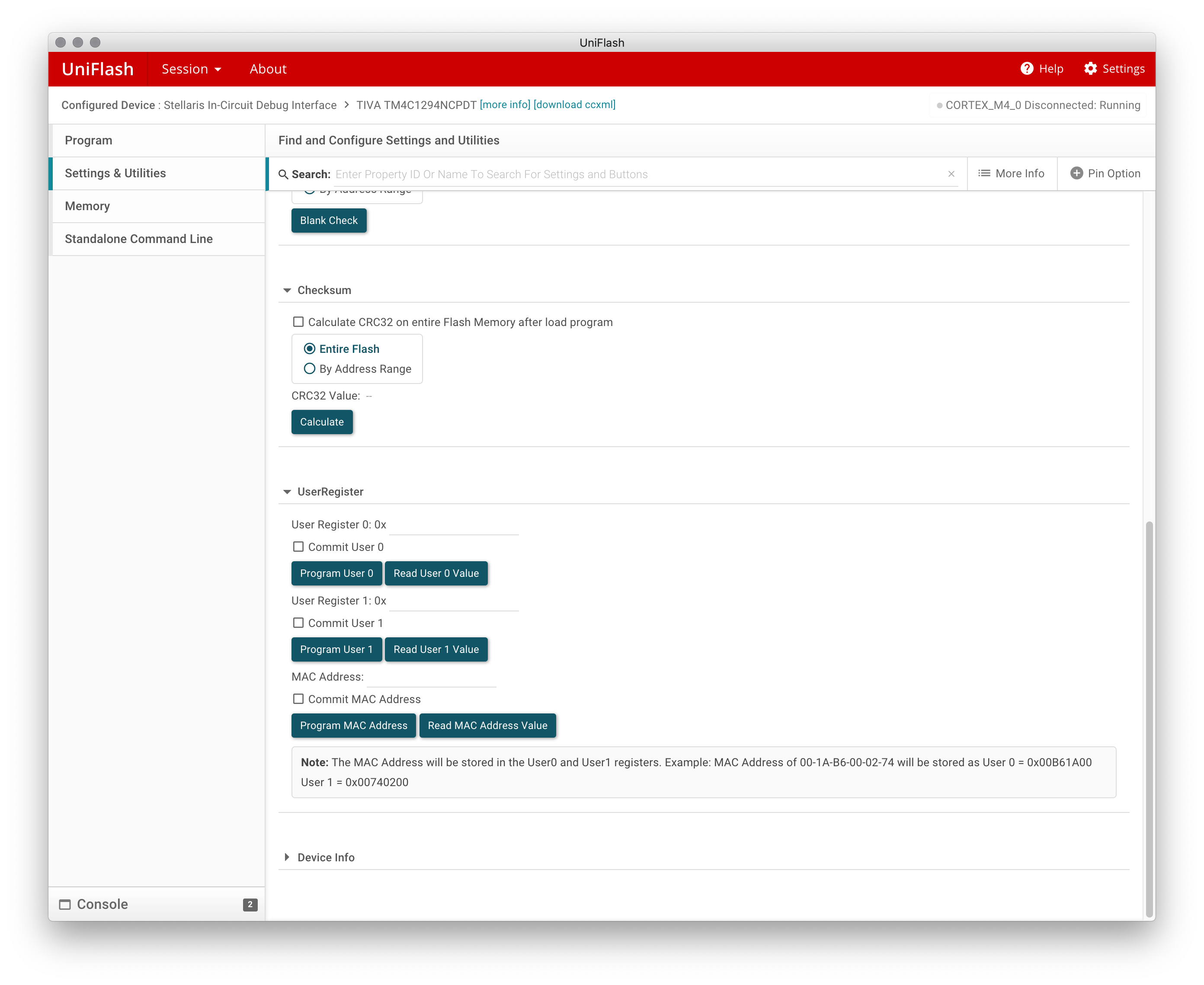

    I'm looking at Uniflash 6 on my Mac, connected to the TM4C1294XL LaunchPad. It does [I]not[/I] have the device unlock like one sees in LMFlash. Unless I can't find it, which might be possible!
    Reading through SPMA075, it appears as if Uniflash wants to use XDS100 or XDS200 debug interface -- even though Table 3 says it supports ICDI too.
  • Hello Andy,

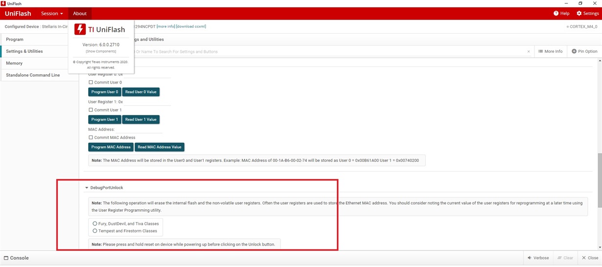

    I haven't checked v6 yet but it should be under Settings and Utilities near the bottom, is that where you looked? I'll download version 6 and check as well.
    Not there!
  • Hello Andy,
    Very odd... I see it on Windows.
    Can you open up a thread on CCS forum to ask them why that differs for Windows vs Mac? I unfortunately dont know what to say regarding that...
  • The CCS support guy responded almost immediately. The unlock feature is unfortunately Windows only. He guessed that it's because of a Windows-only library being used for the feature.

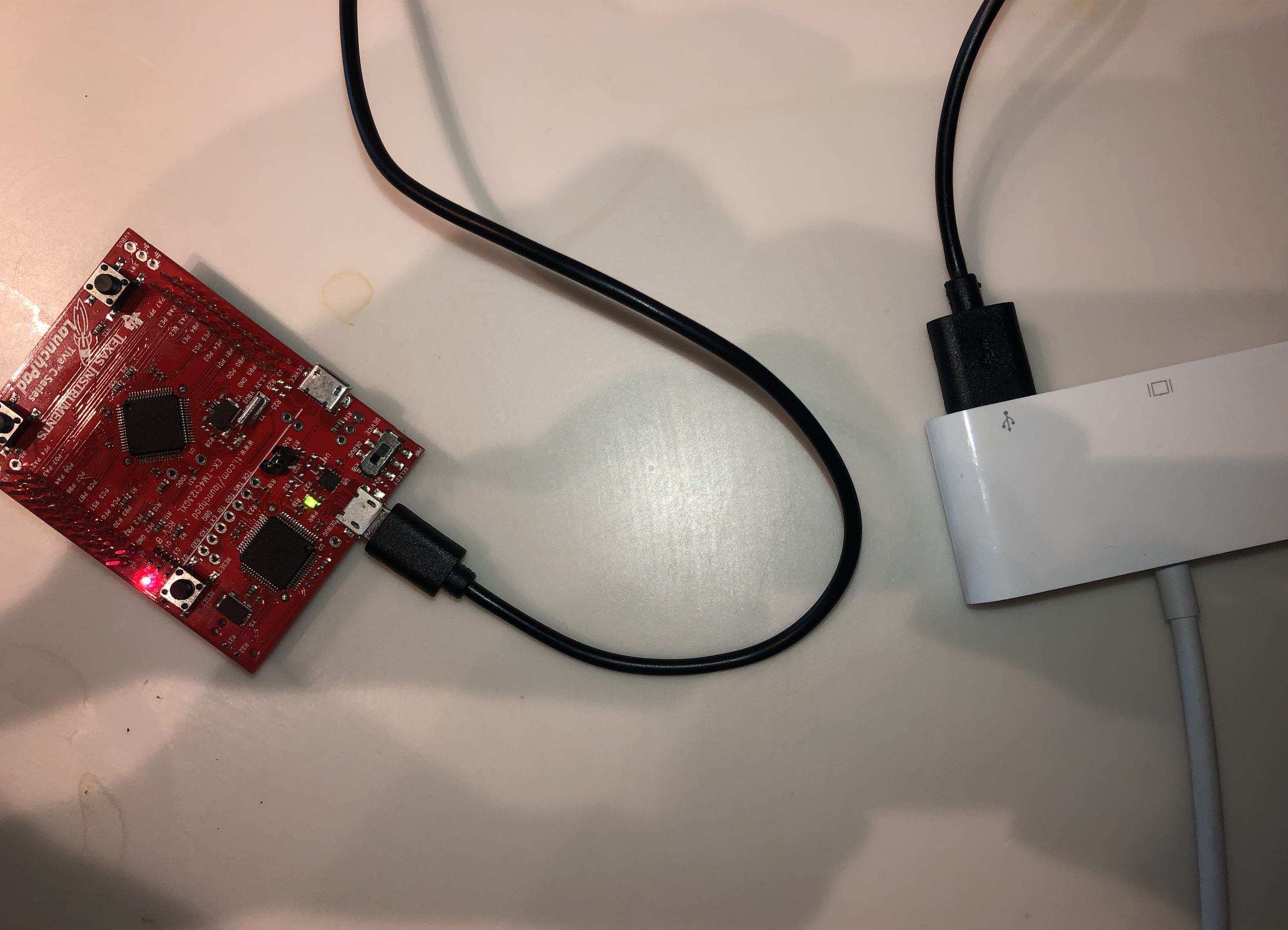

  • Copy. I setup my Windows 10 VM in VirtualBox 6.1 on my MacBook Pro (16-inch, 2019) running macOS Catalina but even Windows is unable to detect my plugged in Launchpad.
    I have my Launchpad connected to USB via its Debug port which is itself connected to the USB-C dongle connected to my Mac. I have the ICDI drivers downloaded and extracted in Windows. In my Computer Management pane on Windows I don't see any section labeled "Other Devices".

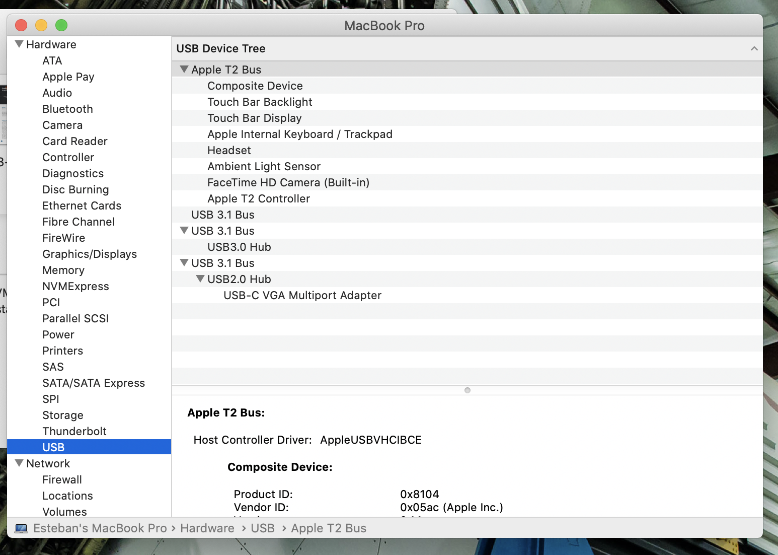

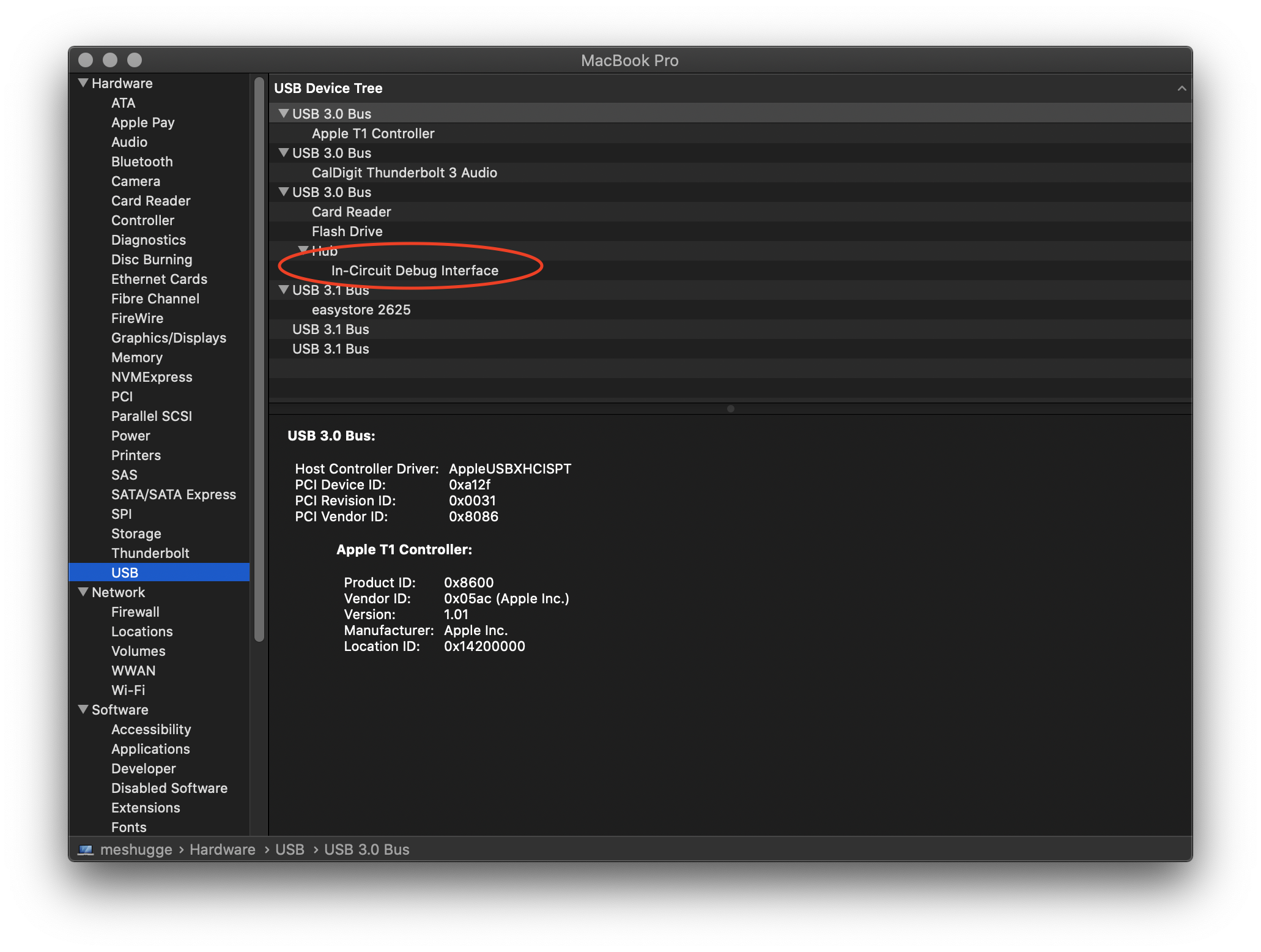

    Check "About this Mac" -- System Report and look under USB. Do you see the debug interface?
  • Esteban Duran said:
    I just switched to VMWare Fusion. I have Windows up and running, downloaded the drivers, and installed UniFlash. I am still experiencing the same thing. No OS, neither MacOS nor Windows, detect that the Launchpad is connected.
    One more thing -- are you sure you are plugged into the correct USB port? There are two on the 1294 Launchpad. The micro-B port by the Ethernet jack is the device port, driven by user code in the Tiva, and the micro-B port on the other side of the board (circled here) is the debug port.
  • No, I do not see ICDI on there
    I pulled out an older 2013 MacBook Air I have to take the USB-C dongle out of the equation, connected the Launchpad directly to the Mac, and still do not see the debug interface.

  • And yes. I have the Launchpad connected via the debug port and the switch on "Debug"
