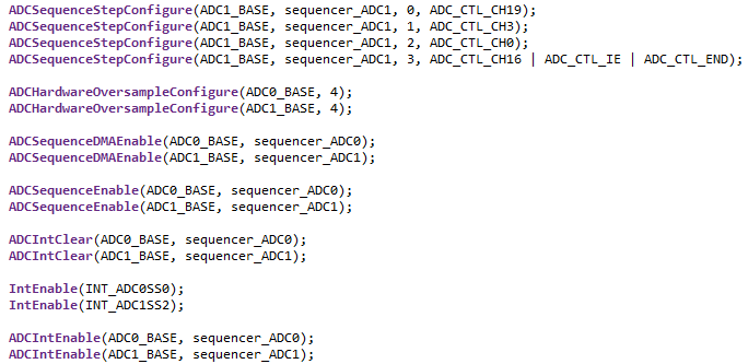

      - Can you show the code on how you configure the sequencer using ADCSequenceStepConfigure()?
  • Hi Charles,
    - Yes, the problem occurs to both ADC.
    - Yes, the problem occurs to both buffers.
    - I tied one channel to 0,61 V (fourth channel in the sample sequencer) and the others to 1,65 V. As you can see it randomly changes the place in the destination buffer.
    Here it is now the second place.
    Here it is now the third place.

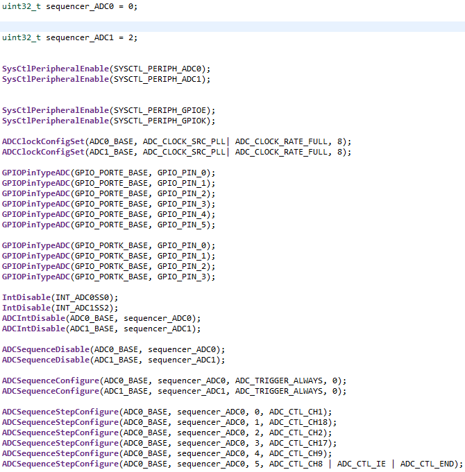

    - Initialization of the ADC and DMA:
    Thanks for help.
    Kind regards,
    Constantin
  • Hi Constantin,
      I think the problem may lies with the way you trigger the sampling using ADC_TRIGGER_ALWAYS. Can you do an experiment using ADC_TRIGGER_TIMER. Try to create a periodic trigger using a timer and see if that makes a difference. It seems to me that you keep on triggering ADC sampling while the uDMA is still transferring data. Please refer to the adc_udma_pingpong example in the latest TivaWare (2.2.0.295) release where it uses the timer to trigger ADC sampling.

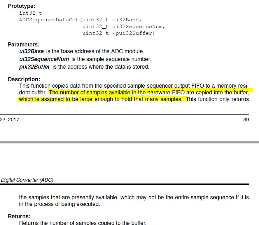

      As I have never seen a problem like this I will need you to some experiments.
      - I assume if you were to use the CPU to read out the ADC data, they will be read out in the correct order. Is that correct? The reason I'm asking is to isolate the problem between uDMA and ADC. If you are reading wrong order using the CPU then the problem is not the uDMA. However, I tend to think the problem is more likely to be the uDMA.
      - To keep it simple, can you remove the ADCHardareOversampleConfigure() for the time being? The ADCHardareOversampleConfigure() will slow down the ADC sampling rate. Let's keep the ADC running as fast as possible for now.
      - Try with 3 ADC channels with each channel driven to 0, 1.65V and 3.3V separately and use the uDMA to read them out. I'd like to know if the number of channels in a sequencer has any effect on the result.
      - If possible, can you try just regular uDMA transfer instead of ping-pong mode. The goal of the experiment is to verify if ping-pong mode has any effect on the ordering. We don't care about uDMA throughput at this moment.
  • Hello Charles,
    - If I use the ADC Clock frequency: 16 MHz with ADC_CLOCK_RATE_HALF, the channels are read in the correct order. But If I increase the frequency or the rate, the order of the channel changes in the second run.
    - It doesn´t change anything.
    - The first run works perfectly fine as in Ping Pong mode. In the second run the order of the channel changes. For this test I used 4 channels with one tied to 1,65 V, two tied to 0 and one to 3,3 V.
    The first run is until the black beam and as you can see during the second run it changes the order. The same applies to three channel. Here is the code if you want to look at it:

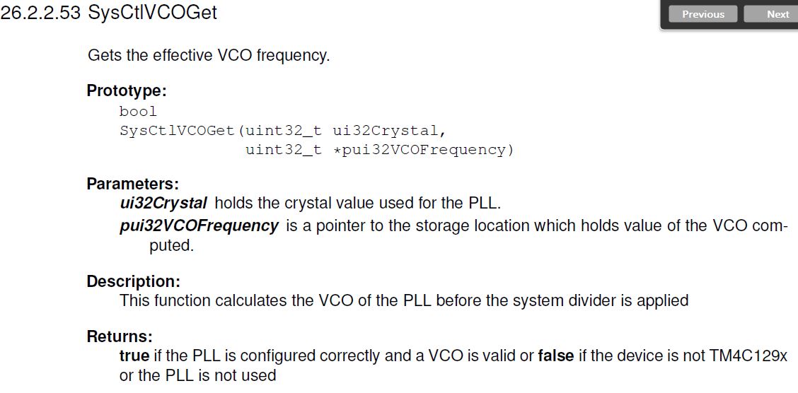

    Can you call SysCtlVCOGet to find out what the VCO frequency? The ADC clock is derived from the VCO when you call ADCClockConfigSet.

  • HI Constantin,
      I cannot see the images you uploaded. I think we are making some progress.
      The ADC_TRIGGER_ALWAYS means it is continuously sampling. It will be out of sync with your program flow if you are not careful. Let's say you have 5 channels to convert in the sequencer. After all five channels are converted, an interrupt is fired or a DMA request is generated to the uDMA. However, the ADC will immediately repeat the channel sampling again. By the time the DMA or the CPU read the ADC FIFO, there may be more samples converted. You might have reserved 5 buffers for the CPU to read but the FIFO actually contains more than 5 conversion data.
     Let's use an example.
      1. You are converting channel AIN0,1,2,3,4.
      2 After all five channels are converted an interrupt is generated.
      3. By the time the CPU is ready to read the FIFO there are actually 7 channels converted and they are AIN0,1,2,3,4,0,1
      4. You issue the ADCSequenceDataGet but only the first five data are transferred to the buffer. The 6th and 7th samples are never read and lost.
      5. Since the ADC continues to sample in the background and the next channel (AIN2) conversion data will be stored in the first FIFO location.
      6. By the time the ADC generates the next interrupt the FIFO will contain AIN2,3,4 or maybe AIN2,3,4,0,1.
      7. When the CPU transfers the data to the buffer, the buffer appears to be out of order (AIN2,3,4,0,1 instead of AIN0,1,2,3,4)
    I don't know how you use ADC_TRIGGER_TIMER. If you use the timer as a trigger then you need to make sure the timer does not trigger before you complete your FIFO read. You must have some type of synchronization in place so you do not trigger the ADC until you finish the FIFO reading. This is the key.
      I will suggest you use ADC_TRIGGER_PROCESSOR so you can control the synchronization on when to start the conversion before you finish the FIFO read. Use the ADC_TRIGGER_TIMER is OK but be very careful on the synchronization.
