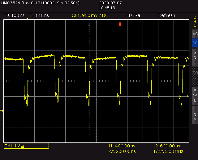

    I didnot check exactly, bit I see the wirte impuls is low for 25 ns:
    Here is the timing for subsequent writing (with the mentioned while()). What do you mean with "wasted clock cycles"?
    The program is just for testing and does really nothing except the writing to the EPI, so I thought this is a best case scenario. But this throughput is rather poor. Is there any chance to improve?
    Michael
  • Hello Michael,
    I had been looking for similar requests about EPI Throughput improvements and saw something along those lines come up. Doesn't seem that is applicable here. I haven't tried to max out the EPI and don't have a setup to do so right quickly so I've been trying to find related issues.
    I did dig up this following thread which seems very close to what you are doing, the solution included turning on optimizations.
    Amit also shared code that he saw high performance on as well in the lines of what you are looking for: https://e2e.ti.com/support/microcontrollers/other/f/908/p/449440/1622205#1622205
    To get further speed beyond that, the uDMA interface should be able to help as well by allowing the data transfers to happen behind the scenes rather than as part of your program.
    If you are finding that the above isn't enough to see simple EPI performance you want, I can try next week and test on my end further. By the way for that thread it was 60MHz to get around 50ns.

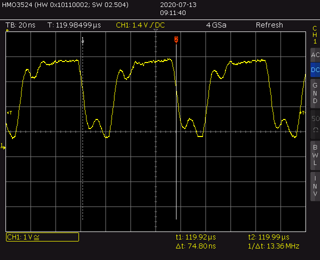

  • Hi Ralph,
    things can be so easy. That hint did the job, I didnot compile with optimization. Now I have about 75ns...
    Thanks & Regards
    Micky
