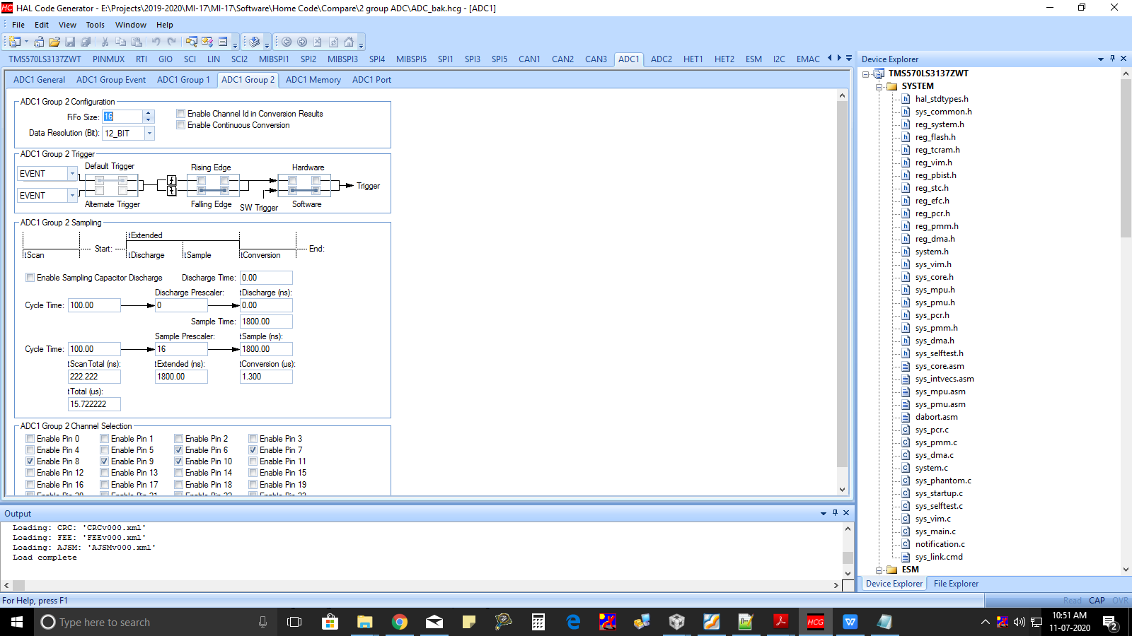

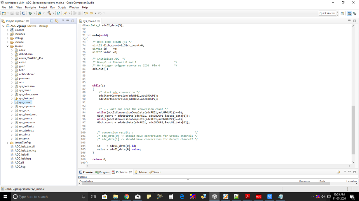

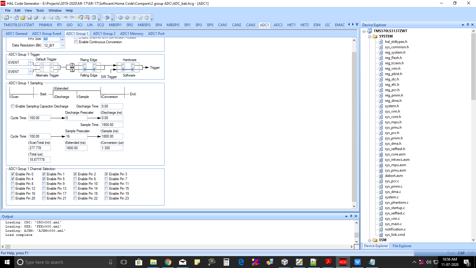

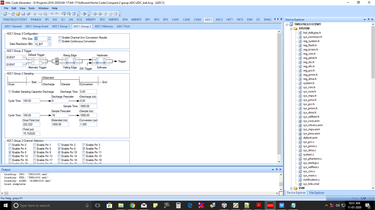

in my project, we have adc input's i have attached sceenshot of that,

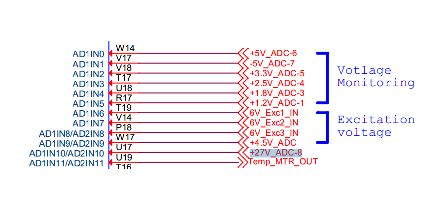

ADC input is working fine for those channels AD1,AD2,AD3,AD6,AD7,AD8,AD9 .
It is not working for AD0,AD4,AD5,AD10,AD11. On first conversion AD0,AD4,AD5,AD10,AD11 channels is reading correctly. and next time not coming proper.
input is fine and monitored ADC input pin.

    #11 channel is not selected in your configuration.
    What are input voltage level for 6V input monitor and 27V input monitor? The valid range for ADC input is 0V~5.25V (for Vccad=5V).

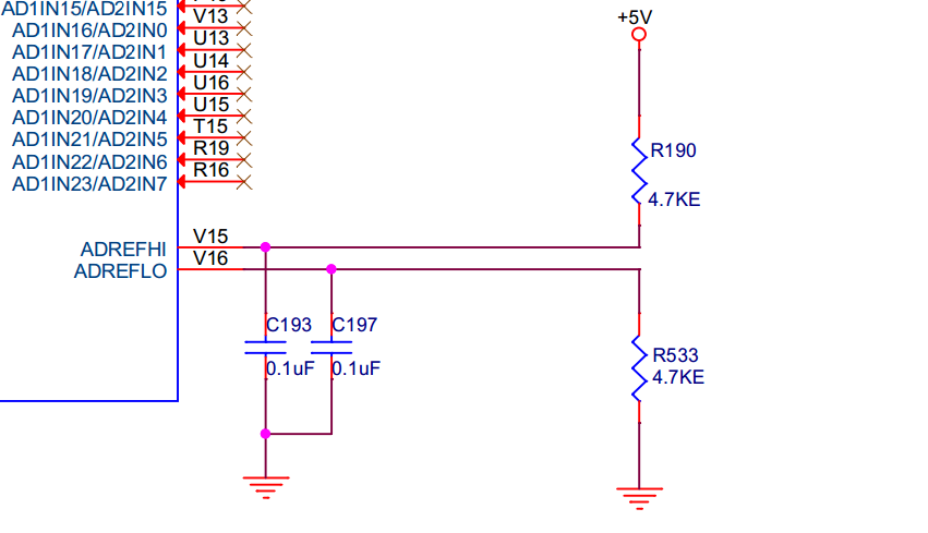

    Why the a 4.7KE (?) resistor is added to ADREFLO, which means the ADREFLO might be zero.
