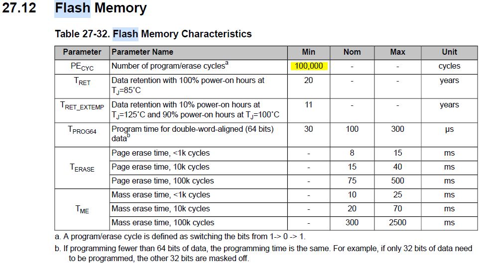

      Do you know within 12 hours, how many times did you call usingFlashPBSave to store a new parameter? Bear in mind that you are writing to the flash memory. There is only a limited number of write cycles for the flash memory. If you go beyond the number of cycles specified then the flash memory may be damaged.
  • Hi Charles,
    Thank you for your help. I figured out that my compiler version had changed and that was the reason for this issue.
