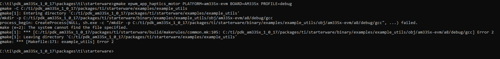

    I tried used the method described in the section: "Building DCAN Loopback Example for RTOS - Using Makefile". I am getting errors. I tried both the commands you mentioned above. Please see the screenshots below.
    I tried changing the PLATFORM and BOARD to seee if that works. Still got the same issue.

  • Hi Arshiya,
    It works for me. I installed AM335x PRSDK 6.3.0.106 to c:\ti
     c:\ti_am335x_06_03_00_106\pdk_am335x_1_0_17\packages
    # pdksetupenv.bat
    Environment Configuration:
        SDK_INSTALL_PATH        : c:/ti_am335x_06_03_00_106
        PDK_INSTALL_PATH        : c:/ti_am335x_06_03_00_106/pdk_am335x_1_0_17/packages
        GMAKE_INSTALL_PATH      : c:/ti_am335x_06_03_00_106/xdctools_3_55_02_22_core
        PDK_SOC                 : am335x
        PDK_VERSION             : 1_0_17
        RULES_MAKE              : c:/ti_am335x_06_03_00_106/pdk_am335x_1_0_17/packages/ti/build/Rules.make
    Next:
    # cd ti\starterware
    # gmake epwm_app_haptics_motor PLATFORM=am335x-evm BOARD=AM335x PROFILE=release
    My build log is attached.
    Frank

  • Hi Arshiya,
    Please issue "gmake help" from the starterware folder. You'll notice the following:
    PLATFORM=[am335x-evm / am43xx-evm]
    The Starterware make files only accept these two platforms.
    Some Starterware examples execute on BBB even when PLATFORM=am335x-evm. If a particular example isn't supported on BBB, this will be displayed in the UART console output when the example is executed.
    The gpio_app_led_blink works on BBB:
                 StarterWare GPIO Application!!
                BOARDInit status [0x0]
                 SoC                   : [AM335X]
                 Core                  : [A8]
                 Board Detected        : [BEAGLEBONEBLACK]
                 Base Board Revision   : [UNKNOWN]
                 Daughter Card Revision: [UNKNOWN]
                GPIO Instance number: 1
                Pin number: 23
                Now blinking the LED ...
    The epwm_app_haptics_motor example doesn't work on BBB:
                 StarterWare EPWM Application!!
                 SoC                   : [AM335X]
                 Core                  : [A8]
                Invalid device ID!!
                Device is not available on this board!
                This example is not supported on this board!
    To get ePWM working on BBB, you'll need to use Starterware ePWM API in your TI-RTOS app.
    The API functions are located in startware/include/epwm.h.
    A Starterware example which uses the Starterware ePWM API functions (but doesn't work on BBB) is epwm_app_haptics_motor.
    You'll need to account for any platform-specific differences between the supported platform and BBB. This part is up you.
    Frank
