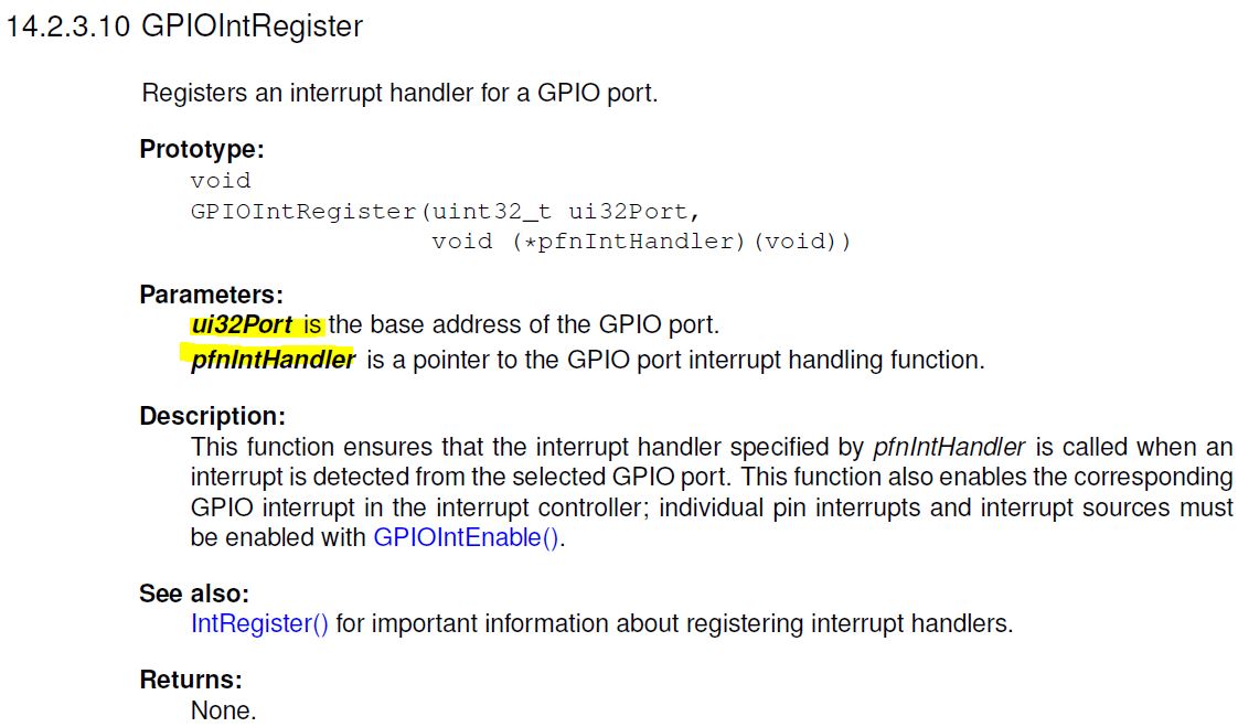

When they use GPIOIntTypeSet( PORT_TA_OPTICAL_IN_BASE, PIN_TA_OPTICAL_IN, GPIO_LOW_LEVEL | GPIO_DISCRETE_INT) with GPIOIntRegisterPin( PORT_TA_OPTICAL_IN_BASE , PIN_INT_OPTICAL_IN, OpticalIntHandler ), there is no interrupt.
When they use GPIOIntTypeSet( PORT_TA_OPTICAL_IN_BASE, PIN_TA_OPTICAL_IN, GPIO_LOW_LEVEL) with GPIOIntRegister( PORT_TA_OPTICAL_IN_BASE , PIN_INT_OPTICAL_IN, OpticalIntHandler2 ), they stay in a loop inside the interrupt handler OpticalIntHandler2.  SUrprisingly, even when they use GPIOIntClear( PORT_TA_OPTICAL_IN_BASE , ulStatus ) in the interrupt handler.

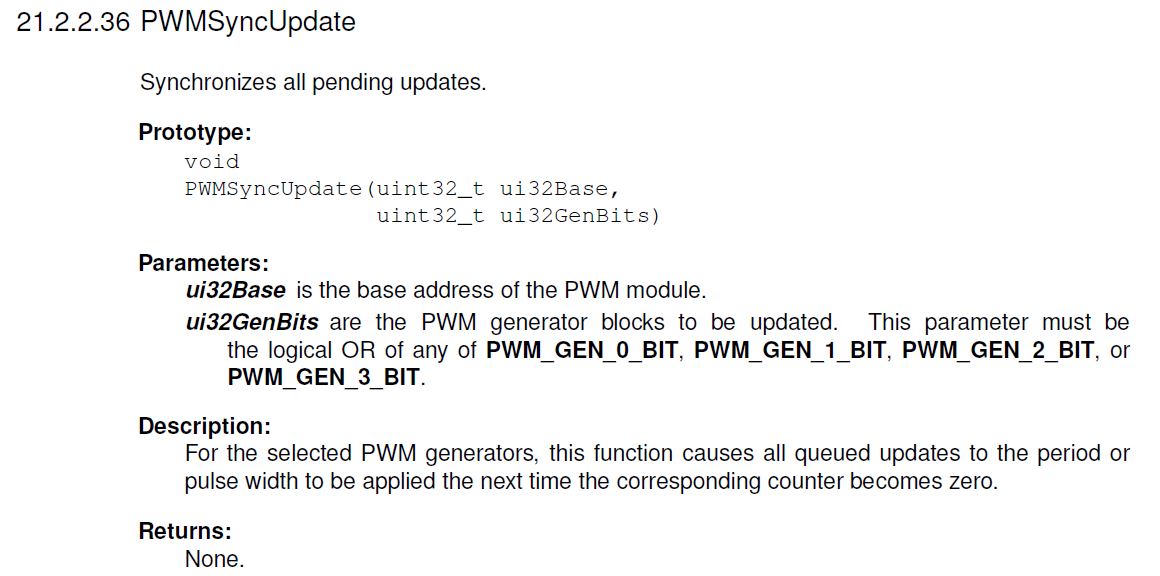

Is it possible to call PWMPulseWidthSet() procedure inside the GPIO interrupt h?  We believe that to be true, but of course any pointers or info you can share is greatly appreciated.

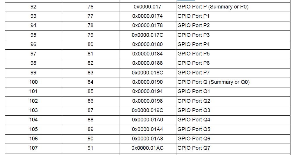

     Which port is PORT_TA_OPTICAL_IN_BASE? Your customer redefine the port with his own #define. Please note that only Port Px and Qx have pin level interrupt capability.
    Not all ports can use GPIO_DISCRETE_INT. So which port is the customer using?
    GPIOIntRegister() only takes two arguments. You have it as GPIOIntRegister( PORT_TA_OPTICAL_IN_BASE , PIN_INT_OPTICAL_IN, OpticalIntHandler2 ) with three arguments. I'm surprised it even compiles.

      I don't see an issue but you need to make sure you enable the sync update so that the duty cycle does not change immediately so the new value is only queued up and takes effect when the counter becomes zero.

    I am using Port P, so the GPIO_DISCRETE_INT applies.
    My bad, I did a copy past on GPIOIntRegister( PORT_TA_OPTICAL_IN_BASE , PIN_INT_OPTICAL_IN, OpticalIntHandler2) in my message.
    In the code I am actually using GPIOIntRegisterPin( PORT_TA_OPTICAL_IN_BASE , PIN_INT_OPTICAL_IN, OpticalIntHandler2) hence the 3 arguments.
    The issue is solved by disabling the interrupt after the GPIOIntClear( PORT_TA_OPTICAL_IN_BASE , ulStatus ) and using GPIOIntDisable( PORT_TA_OPTICAL_IN_BASE , PIN_INT_OPTICAL_IN ).
