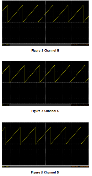

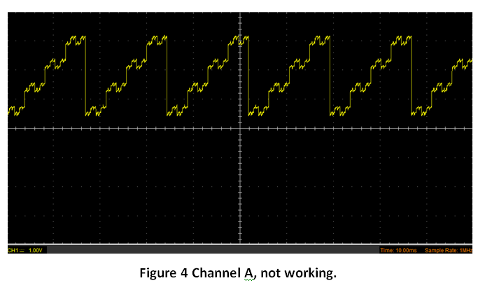

I am connecting the DAC084SO to the TIVA C series Launch pad using SPI protocol in SSI0.
I write the same input values (a  triangular wave form using the while loop with counter) to all 4 channels and I am getting the required output in the channels 2,3 and 4. However, I am getting disrupted output in output channel 1.
I have pasted the oscilloscope screen shots of the 3 working outputs and the 1 disrupted output below:
I have pasted the code below:

  • HI,
      I don't really spot anything wrong with your code. First, Do you have another spare DAC device that you can try? I will suggest you do some experiments. Secondly, Only test the first channel and leave out the other 3 channels for now. Will you get the same problem? Since you have a scope (a logic analyzer will be even better), you can look at the SPI output from the MCU and see if it is outputting the correct serial data. If the serial data is correct but the output voltage from the DAC is not correlating with the input value then you will need to post your question to the Data Converters forum at https://e2e.ti.com/support/data-converters/f/73. I can only support the MCU, not the DAC device. Again, if you have an extra part, try your program on the second part first. If a second part is giving the same result, then it is most likely having something to do with your code. In that case, focus on just the channel that is not giving the correct result.

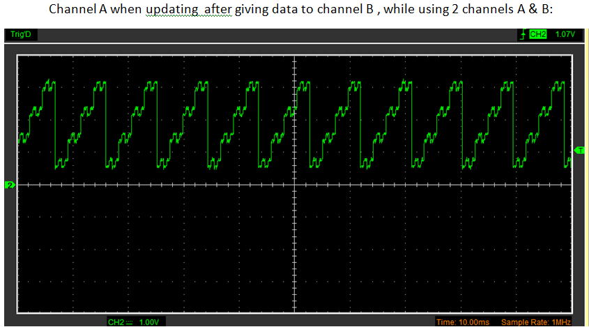

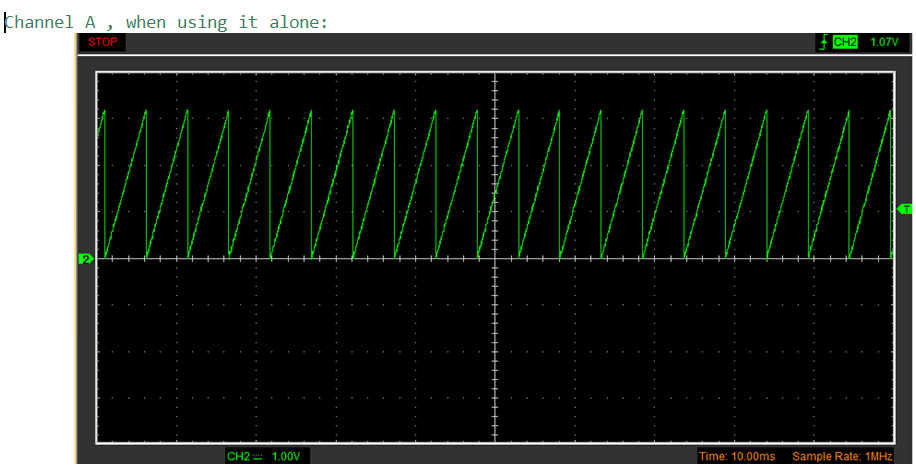

  • Hi Charles,
    1)      I tried with another DAC IC. The results are the same. Channel A not working correctly, other 3 are working.
    2)      I disabled other 3 channels and ran only channel A with immediate output update using the code below in while loop. Channel A is working fine in this setup.
    SSIDataPut(SSI0_BASE, ((0b000100000000| loopCount)<<4));
    //SSIDataPut(SSI0_BASE, ((dacBaddress_dontUpdate | loopCount)<<4));
    //SSIDataPut(SSI0_BASE, ((dacCaddress_dontUpdate | loopCount)<<4));
    //SSIDataPut(SSI0_BASE, ((dacDaddress_doUpdate   | loopCount)<<4));
    3)      Then I tried using 2 of the 4 channels with immediate output update after each SSI write, using the code below. Channel A is disturbed while channel B is good looking.
     SSIDataPut(SSI0_BASE, ((0b010100000000| loopCount)<<4));
         Next I again did the 2 channels , but this time updated both outputs only after writing channel B data. Now disturbance in channel A looks of higher duration. Channel B is again OK.
           SSIDataPut(SSI0_BASE, ((0b000000000000| loopCount)<<4));

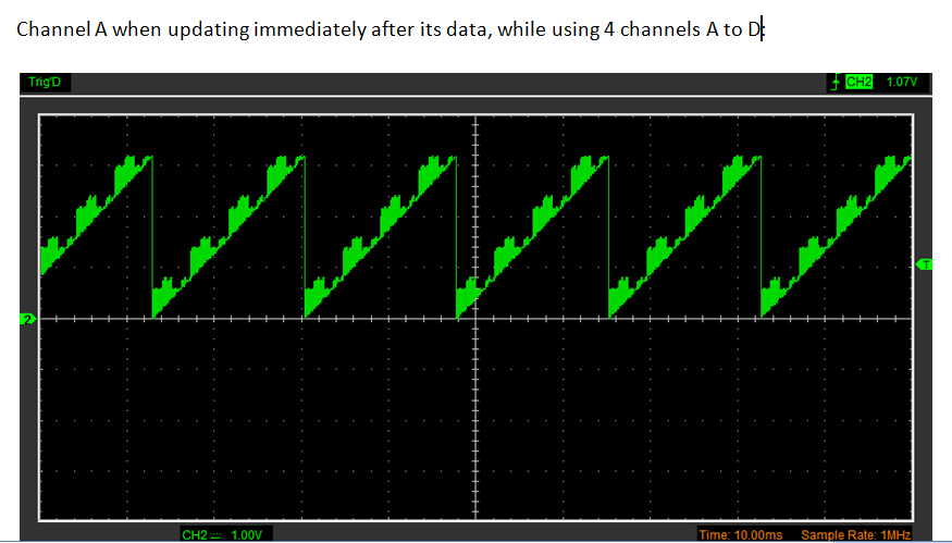

    4)      As another attempt, I used all 4 and updated each after writing its data Channel A alone is disturbed with fluctuations of higher frequency, probably due to immediate update.
           SSIDataPut(SSI0_BASE, ((0b100100000000| loopCount)<<4));
           SSIDataPut(SSI0_BASE, ((0b110100000000| loopCount)<<4));
    I think updating after giving data to other channels gives more spacing between the fluctuations in channel A.
    Any suggestions please?
