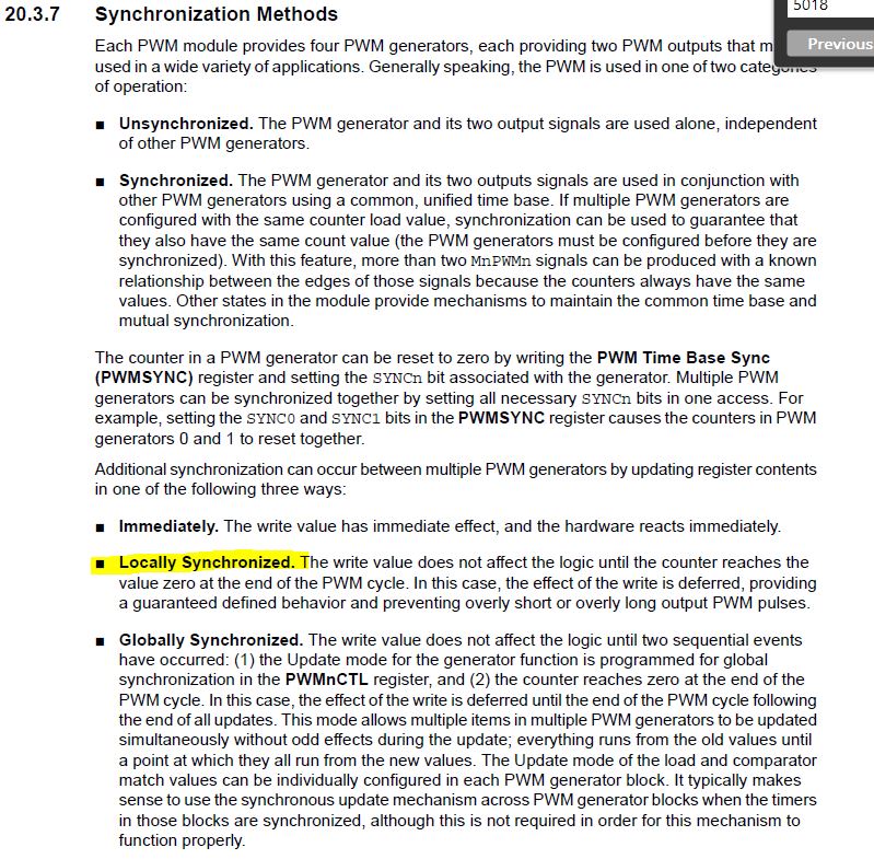

  • Hi Ryan,
      I'm not surprised that you can't get to 0% duty cycle using TIMER module. You may even encounter problem with 100%. The 0% and 100% are always tricky and I vaguely remember so people reporting not getting 0 and 100%. If you can get the PWM to work using the actual PWM module then please stay with the PWM module instead of the TIMER module.
      Have you used the PWM_GEN_MODE_GEN_SYNC_LOCAL flag when configuring the PWM with the PWMGenConfigure()? Please refer to the local sync mechanism as follows.

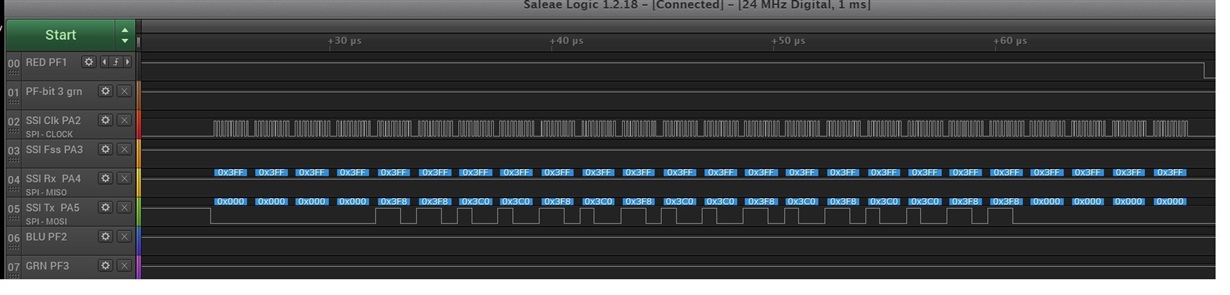

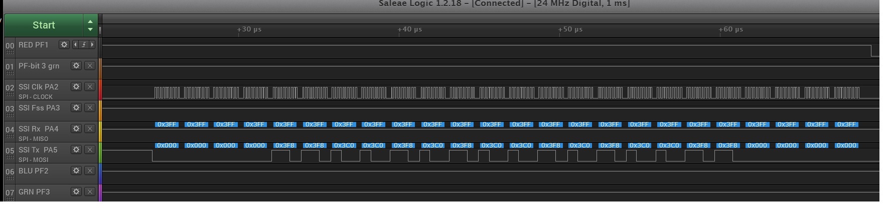

  • Here is the timing off a Tiva code snippet:
    As usual, 'the devil is in the detail', so here are changes from the previous post:
    - 50 MHz sysclock was used as I could not find 60 MHz. This is OK since 50M / 12 gives the 6 MHz SSI clock.   Thus dshot 600KHz is shown.
    - the dshot ONE bit high time is 1.125 uS.       ZERO bit high time is 0.66 uS.      Both can be trimmed by changing the bit patterns.     In this example, SPI decoded as 0x3F8 is the dshot ONE bit cell.    Decoded as 0x3C0, the dshot ZERO.     For example, to shorten the high-time of dshot ZERO by some nano seconds, use the character 0x380.
    - the SSI Tx PA5 (trace channel 05, above, green) starts and ends at a high logic level; I do not know why nor did I attempt to investigate.  Instead, the 16 bit dshot frame was padded with four 'zero patterns' before and after sending the frame.   If necessary, I guess PA5 can be programmed back to GPIO in the inter-frame time period, but I did'nt check that detail.    The TI guys on this forum are amazing, so feel free to comment.
    - The SSI FIFO is 8 characters deep, not 16 as mentioned in the previous post.
    - since the frame goes out 'reasonably quickly', the code for this includes a technique to make is atomic so that the dshot frame is contiguous from SSI Tx PA5.
    I know this is not what you originally set out to do, so I hope this is useful and fits your bill !        (your last message:  "Any ideas on implementation would be extremely helpful." )

            // Configure GPIO Pins for SSI2 mode.
            GPIOPinConfigure(GPIO_PB7_SSI2TX);
            GPIOPinTypeSSI(GPIO_PORTB_BASE, GPIO_PIN_7);
            SSIConfigSetExpClk(SSI2_BASE, SysCtlClockGet(), SSI_FRF_MOTO_MODE_0,
                    SSI_MODE_MASTER, 6000000, 10);
            SSIEnable(SSI2_BASE);
            //uDMA SSI2 TX
            // Put the attributes in a known state for the uDMA SSI2TX channel.  These
            // should already be disabled by default.
            uDMAChannelAttributeDisable(UDMA_CHANNEL_SSI2TX,
                                            UDMA_ATTR_ALTSELECT |
                                            UDMA_ATTR_HIGH_PRIORITY |
                                            UDMA_ATTR_REQMASK);
            // Set the USEBURST attribute for the uDMA SSI2TX channel.  This will
            // force the controller to always use a burst when transferring data from
            // the TX buffer to the SSI2.  This is somewhat more effecient bus usage
            // than the default which allows single or burst transfers.
            uDMAChannelAttributeEnable(UDMA_CHANNEL_SSI2TX, UDMA_ATTR_USEBURST);
            // Configure the control parameters for the SSI2 TX.
            uDMAChannelControlSet(UDMA_CHANNEL_SSI2TX | UDMA_PRI_SELECT,
                                      UDMA_SIZE_16 | UDMA_SRC_INC_16 | UDMA_DST_INC_NONE |
                                      UDMA_ARB_4);
            // Set up the transfer parameters for the uDMA SSI2 TX channel.  This will
            // configure the transfer source and destination and the transfer size.
            // Basic mode is used because the peripheral is making the uDMA transfer
            // request.  The source is the TX buffer and the destination is the SSI2
            // data register.
            uDMAChannelTransferSet(UDMA_CHANNEL_SSI2TX | UDMA_PRI_SELECT,
                                                           UDMA_MODE_BASIC, dshotPacket,
                                                           (void *)(SSI2_BASE + SSI_O_DR),
                                                           16);
            // Now the uDMA SSI2 TX channel is primed to start a
            // transfer.  As soon as the channel is enabled, the peripheral will
            // issue a transfer request and the data transfer will begin.
            uDMAChannelEnable(UDMA_CHANNEL_SSI2TX);
            // Enable the SSI2 DMA TX/RX interrupts.
            SSIIntEnable(SSI2_BASE, SSI_DMATX);
            // Enable the SSI2 peripheral interrupts.
            IntEnable(INT_SSI2);
    The next thing is I have an interrupt cycling at the update rate (rate at which I'd like to send dshot packets. Now I need to figure out how to move the DMA execution code into the interrupt so it only fires the DMA transfer once per interrupt.
  • I updated the full code base on github. It compiles but I'm not getting any output on the pin yet.  https://github.com/VirtualEnder/TestStandv2/blob/dev/MQTB_Thrust_Stand/hardwareTimers.ino
  • Hi Ryan,
      I hope you find the example by Otto useful. Please let us know your status and if we can close the thread.
