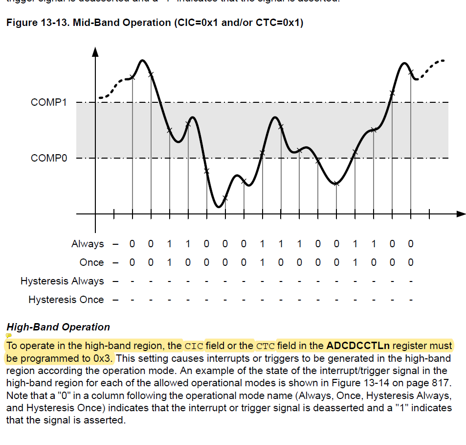

    What I just want is to represent the pulse signal, which is an analog signal, as a square wave using some method.
    So one of the methods I've been looking for is this picture (high-band-operation.).
    This may not be correct because it is just my thought
    After this method used ADC to sample, I saw that the sampling value is 1,0 according to COMP.
    So I thought that the values of 1,0 would be output as a square waveform.
    If it is not correct, please comment. ;(
    and If it is not, is there any way to make the output of the analog pulse sensor go into the kit's input so that the kit's output is in the form of a square wave?
    and if you cannot see my picture, i suggest that you can see the picture where it is located 'TM4C123GXL's DATASHEET - 816p'
  • I'm sorry that I posted the wrong PIC.
    the PIC is MID-BAND-OPERATION.
    but what I want to say is 'HIGH-BAND-OPERATION.'

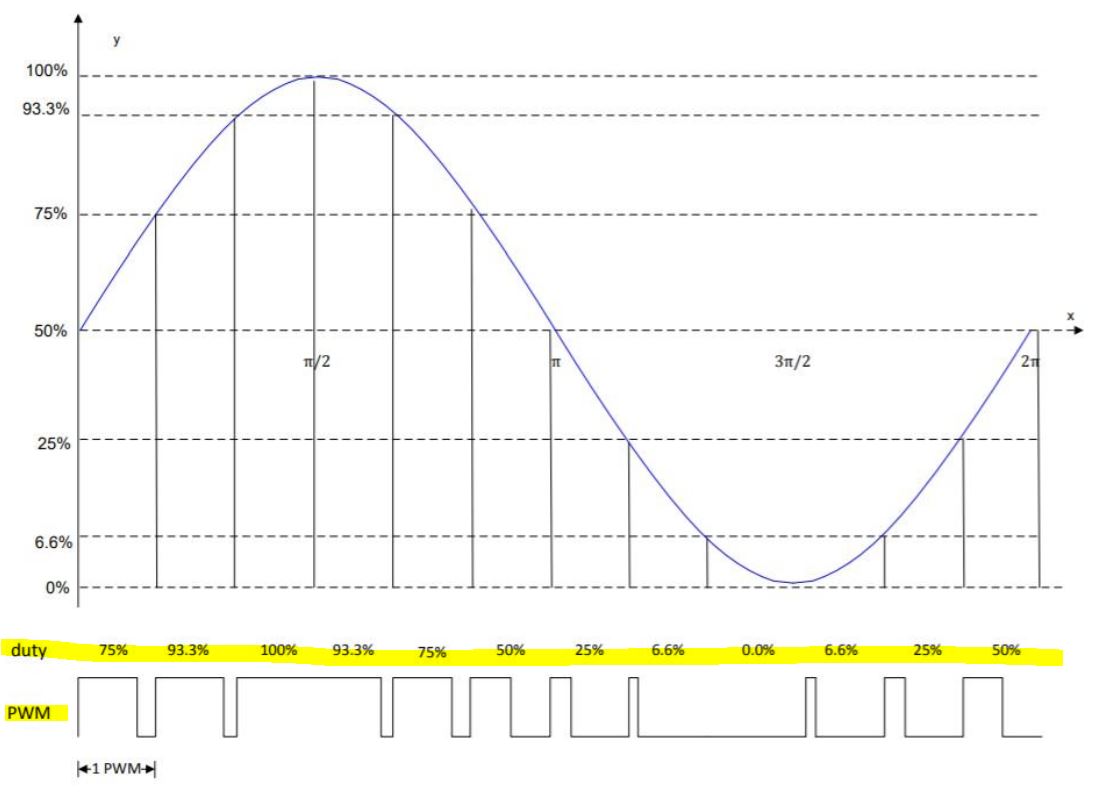

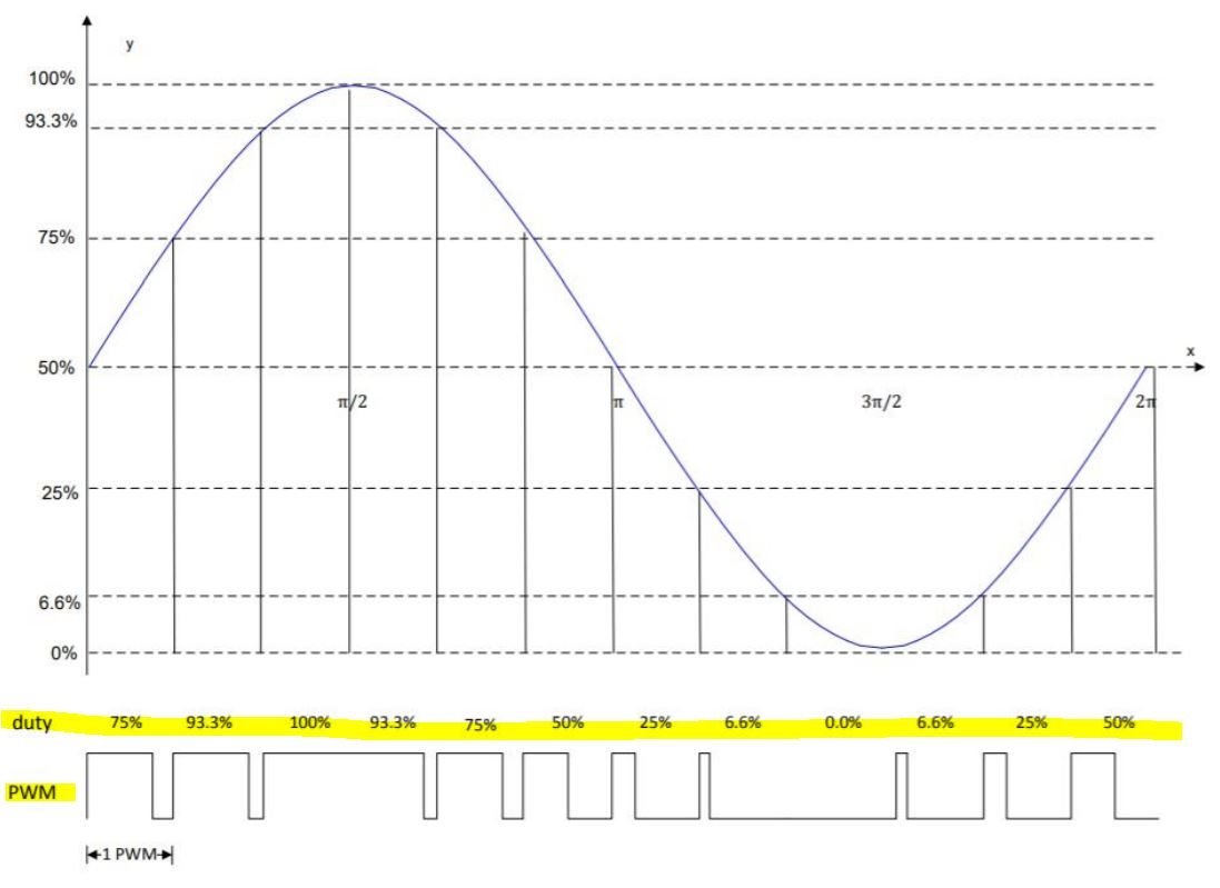

      Let me try to understand exactly what you are trying to achieve. You want to generate the PWM signal in the below picture. Is that correct? The PWM shown in the waveform has a variable duty cycle. The MCU will output this variable duty cycle PWM. You will then connect this PWM output to a low pass filter (this will be an external component) and the sine wave will appear.
      If you want to create a variable duty cycle PWM then you just need to change the duty cycle on each compare match. If you look at the diagram, you will start with a 75% duty cycle followed by a 93.3% duty cycle and 100%->93%->75%->50%.....
      To generate a PWM you will use the PWM module or the GPTM (timer) module in PWM mode. Take a look at the pwm_interrupt example in <TivaWare_Installation>/examples/boards/ek-tm4c123gxl/pwm_interrupt to see how the duty cycle is changed in the interrupt. Connect the PWM pin to a scope and see the waveform change. If you have a low-pass filter then connect the PWM pin through it and observe the filter output. Once you understand how it works, then you can change the code to adjust to whatever waveforms you want to create.
  • yeah I want to output a sqaure wave is correct.
    'but' The input signals should be and could be any analog signals
    for example the input analog signal could be pulse sensor's signal.
    I think what you said is 'Just output the square wave when no input signal is applied to the TM4C123GXL'
    I want to do
    1. output the square wave when any analog input signal is applied.
    2. Then, how can I sample the analog signal in 12 bits?
    3. if I do, I am curious about how to output square wave through PWM for each bit.

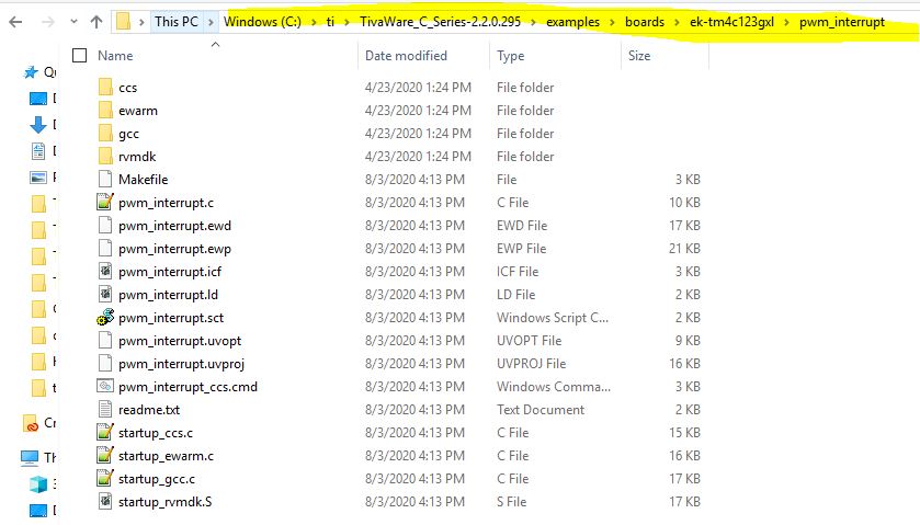

    4. Lastly, I couldn't find ' <TivaWare_Installation> / examples / boards / ek-tm4c123gxl / pwm_interrupt ' that you sent
        is that homepage address? or built-in file?
       If it's the latter, I don't have that file on my computer. I wonder where to download.
  • First of all you can find the pwm_interrupt example as show below. There are also other examples like pwm_invert you can play with. The example is part of the TivaWare library. If you have not downloaded the TivaWare you can download from https://www.ti.com/tool/SW-TM4C. You can also find ADC examples in C:/ti/TivaWare_C_Series-2.2.0.295/examples/peripherals/adc folder. Run the ADC example to have an idea on how the ADC samples the input and convert it to a 12-bit digital value.
    If I understand you correctly, you want to digitize an analog input. Is that correct? I can give you a high level idea. You need to work out the details. I will suggest you discuss with your professor and friends for your project. If you want to digitize an analog input then you can take the converted ADC input and find its percentage with respect to the reference voltage (3.3V). Use that percentage as your duty cycle for your PWM generation. Say for example, you sample an analog input of 1.65V. The 1.65V is converted by the ADC to a digital value of 2047. The 2047 is 50% of the reference voltage. Note that 3.3V input will be converted to 4095 so 1.65V is converted to 2047 for 50%. You will then apply 50% duty cycle to your PWM generation. Your PWM period will determine your ADC sampling frequency. Say your PWM period is 1.25uS or 800kHz. 800kHz will be how fast your can sample your analog input. You need to find out what is right for your application.
  • yeah! I think maybe it will be correct soltuion.

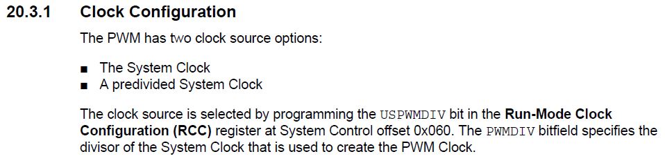

    MAP_SysCtlClockSet(SYSCTL_SYSDIV_1 | SYSCTL_USE_OSC | SYSCTL_OSC_MAIN |
    SYSCTL_XTAL_16MHZ);
    MAP_SysCtlPWMClockSet(SYSCTL_PWMDIV_1);

    I thought that if I do that, the square wave will be output because the value that is 'pui32ADCValue[0]/4095' comes out in percent form.
    BUT, the output waveform was a strange waveform.
    The cause I thought is
     ADC comes out very fast, the frequency of sqaure wave generation is 250HZ and the input signal's frequency is almost 1.5HZ BECAUSE it's my blood pulse.
    So, to solve this problem, I tried to change the PWM's output frequency
    but I could not make 1.5hz
    like this MAP_PWMGenPeriodSet(PWM0_BASE, PWM_GEN_0, (SysCtlClockGet() / 1.5));
    I do not think I'm sure the problem I've guessed.
    What problem do I have to solve to make a square wave according to the changing input's ADC value
    below code that I wrote
