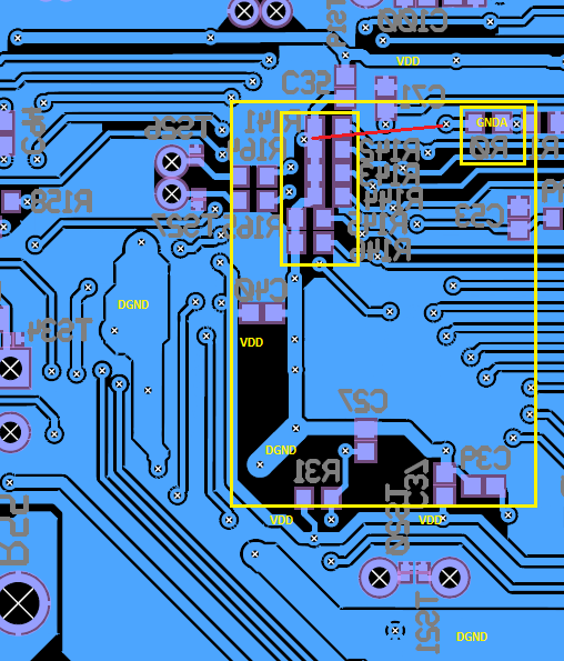

I have been pondering ramifications ADC SNR by 20K pull downs near the MCU pins tied to digital ground, 6 PWM outputs. The PWM output traces lead to analog driver 100k internal pull downs 2" away. The parallel resistances 20K reduces 100k internal input pull downs to roughly 16k overall. Seemingly this practice of adding 10-20k pull downs to analog gate drivers is a breading ground for high frequency PWM riding on ground.
How does that impact SNR of ADC samples and stability? It seems TI engineers TIDA-00778 added 10K pull downs likely for reason POR pin float, any guesses? Typically gate drivers have 100-200k internal pull downs on the inputs so why add any parallel resistance and dampen GPIO current slew? Has there been any study by TI to show how PWM signal injection to MCU ground can or will lead to ADC issues?
Roughly 167µV of current dumped to digital ground x 6 GPIO pins or 1.002mA every 50µs at 20Khz. Do GPIO pins glitch during POR or change state if low impedance resistance is not placed directly near the MCU package pins?
Perhaps one plausible reason for adding any parallel resistor pull downs was to lower the trace impedance if GPIO glitching should randomly occur? This same practice of adding 20k pull downs to GPIO was present on the LM3S8971 motor RDK but only on the low side near the gate driver input also having internal 400k pull downs.

    The 6 pull downs are located directly under the MCU (R141-R146) and tie to the DGND rail pin that have dedicated single VIA to top side GND pins. My concern is direct feed back of PWM into the MCU on the same rail as AGND ties to via R0 isolation. It seems there is far to much LSB rolling digital 10ths place on all decimal values even with extensive SW filtering. R1 is now DNP but makes the rolling value issue worse when tied to AGND plane and R0 was made DNP.
    And there is direct trace (red line) to R0 for AGND ties to DGND VIA of 6 PWM pull downs. I was afraid to remove the 6x 20k pull downs but think I'm being silly when 600V analog driver was designed with 100-400k pull downs. Would it not be prudent to remove the 6x 20k pull downs for ADC to have more stable AGND? Again I'm confused seeing TI engineers add 10k pull downs for the same gate driver (UCC27714) and no explanation as to why they done did that. Seemingly they had not used the parallel resistance formula that 400k/10k is even less pull down on the GPIO ports. I have the slew rate set to 8mA for the PWM ports but question current loading VDD rail without good reason.

  • I took the time to post the PCB layout and show the 20k resistor placements proximity to AGND and you think this another MCU besides EK-TM4C1294?

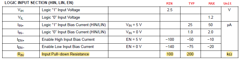

  • That is probably the right place to post your question. It looks to me like the additional pull-down was added because the internal 400K Ohm pull-down resistor on the UCC27714 is not sufficient to handle the maximum leakage out of the input pin (5uA)  and still guarantee a low (below 1.2V). Granted, 10K may be excessive, but I still suspect it causes no issues. Replace the 10K with 100K, it will still provide a pull-down strength that will keep the worst case leakage from causing more than 1V on the input pin while the micro is in reset. I predict it will not change your A to D performance.
  • The actual analog driver pull downs are 100K Min 200k Max. Agree it seems safe to remove 20k pull downs and keep slew rate GPIO (8mA) sink/source. The 5uA leakage is something I never considered and pondered to update 100k but parallel again divides to 50k. Seemingly better to stop inverter dv/dt entry point to GNDA of the ADC simply remove the source point. That hidden inverter dv/dt causes havoc yet luck has it DGND is much quieter than AGND and they are separated on the bottom side foil. The 3 SMP buck regulators diodes dump to AGND on the other side of 0R where AGND becomes DGND, amazed it works fairly well to isolate MCU from AGND noise.
    The actual analog driver pull downs sink/source via internal resistors shown VIN +5v. Also 51R filter in series with each GPIO drive placed near the analog IC inputs should keep 5uA leakage from entering gate driver. For some odd reason the UCC27714 kept shorting out the center driver HO output.
  • Hi Bob,
    DMM indicated 15.9k before removing 20k's and GPIO pins returned to 111.7k, the lower end of device specification. Noted in electrical specifications TM4C shows 60µA InJ DC injection current is roughly 30µA via 111.7k pull downs at the analog driver by ohms law. The 15.9k that could exceeded 60µA specification (210µV) though inverter DC ramps with  VDD and has 330 ohm 10 watt series bypass contactor. Seemingly Dc injection current is a good reason to not put low value pull downs on GPIO in parallel with analog gate driver pull downs. There was no rise on GPIO pins during POR after removal indicates 100k was suffice.
