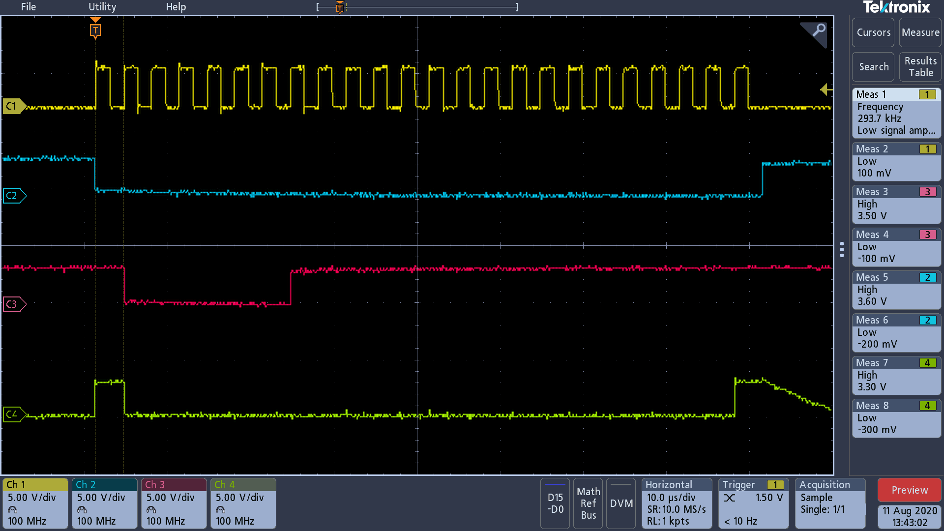

We're trying to read the DeviceID, and we are not getting back the correct value. On the read access cycle, we see the correct register address but the data is all zeroes.

Below is the read access cycle and write access cycle images from scope. Probe1=CLK, Probe2=CS, Probe3=MOSI, Probe4=MISO
Read Request:
Read:
  • Hello Chris,
    On SDO bus, the first byte is correct which is echo R/W and address from the previous access cycle.
    Is the device configured properly by programming SPICONFIG register?
    From your waveform, the data (129) is transferred without any issue. What is the value of the 1st byte in your received buffer? If it is 129, the SPI receive is fine.
  • I came across a quote -- "We prefer SPI mode 1 and 2, not 0 and 3". We ended up changing the clock polarity and it started working.
