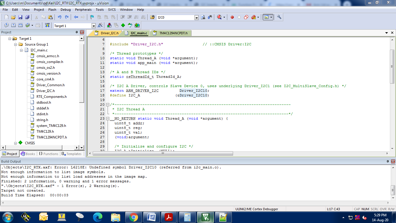

Currently I'm working on EK-TM4C1294XL using Keil. Basically trying example code of I2C which I found on there website. Already having tough time even example code is having errors like undefined symbol "Driver_I2C0".
I'm attaching screenshot below. Please help me to understand how to initialize a specific I2C peripheral eg. I2C0,I2C1,I2C2 ....... . THank you in advanced.
