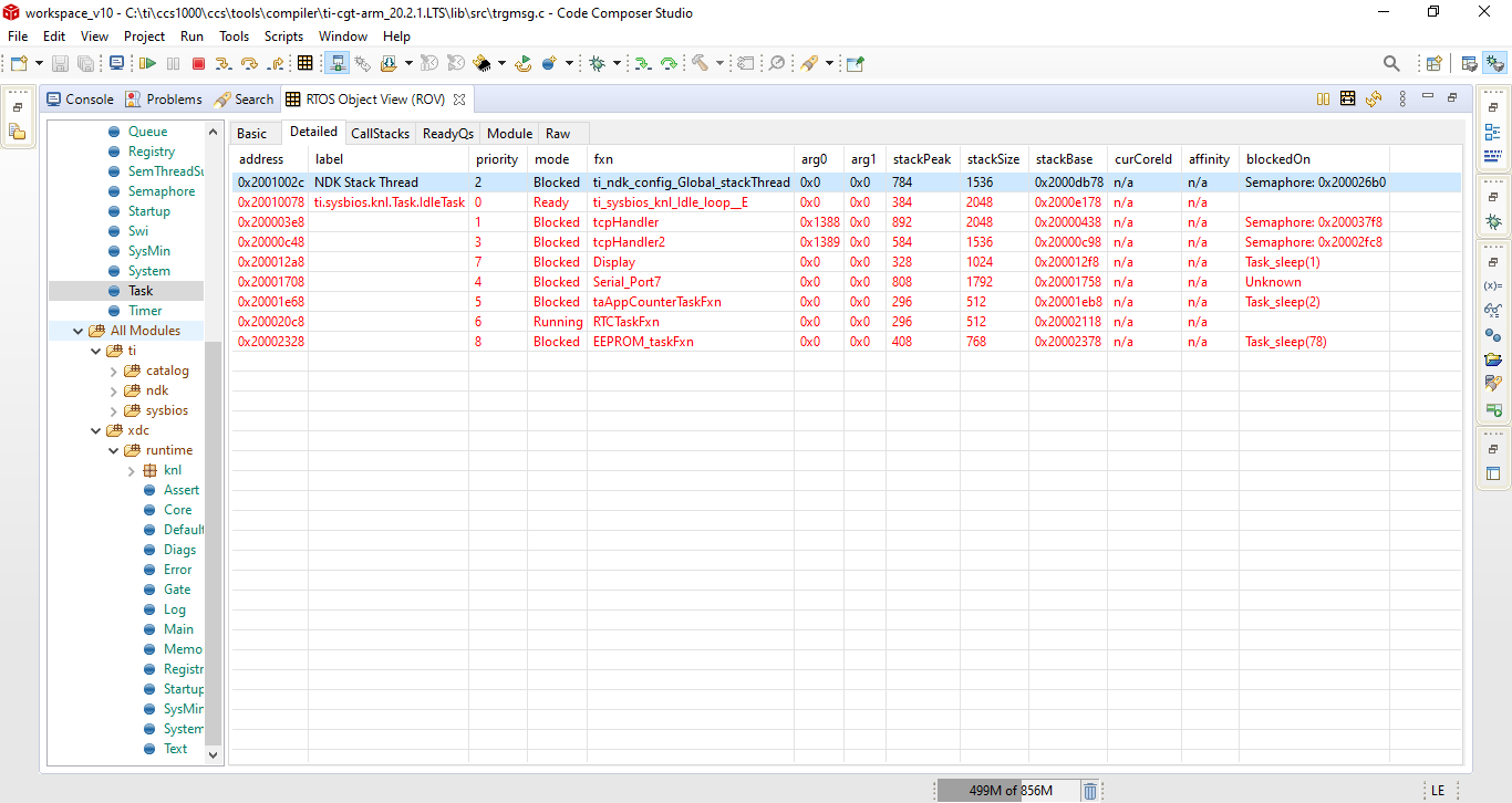

  • Our aim is to build application software as TCP Client and as well TCP Server with two different port number.
    TCP Client used to push data to central server on port no 5000 using tcpHandler task and is working fine
    TCP Server used to receive data from Central Server on port no 5001, tcpHandler2 created to get data from server but it's not accepting connection return -1
    Please suggest us how to configure socket in these two scenarios
      Does the TCP server (tcpHandler2) on your application work alone without the client (tcpHandler)?
  • As suggested, disabled tcpHandler task and tested with tcpHandler2 task, it's not accepting connection from client or not establishing connection with Server.
    Individually tcpHandler task sending data to server continuously, after some idle (>8mins) time, this task is not running. At this point of time device not even pinging
    Can you please suggest us how to resolve above two issue

    I don't know what is the problem that the application only runs 8min? Do you have enough stack and heap? I will need to forward your question to our NDK expert. In the meantime, please use the Wireshark to capture the traffic around the time when it fails.

  •  accept() errno value = 60
    connect() errno value = 60
    When I am trying with TCP ECHO example file following message printing on console and remains in idle loop
    Starting the TCP Echo example
    System provider is set to SysMin. Halt the target to view any SysMin contents in ROV.
    Service Status: DHCPC : Enabled : : 000
    Service Status: DHCPC : Enabled : Running : 000
  • Hello veeraswamy kakita8,
    Thanks for providing that information, but I think I misunderstood something. 60 translates into ETIMEDOUT which makes sense for connect(), but not accept(). On top of that I thought you were only getting a -1 error in tcpHandler2(). I don't see any connect() calls there in the code you provided me. Could you help clear up this confusion for me?
    As for why connect() would get that error code in the first place, I think we will need to inspect the wireshark logs to figure out why the server isn't responding.
    Dalton
