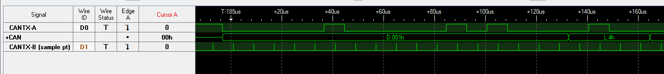

  • How did you put the CAN module in sample point mode? Here are the register writes that I used in a different project.
        // Put the CAN module in sample point mode
        HWREG(CAN0_BASE + CAN_O_CTL) |= 0x80u; //Enable test
        HWREG(CAN0_BASE + CAN_O_TST) = 0x20u;  //Enable sample point
    Here is the logic analyzer shot. In this project the baudrate is 125K and the sample point is centered. Also, the TX pin from node B is disconnected from the transceiver to avoid causing errors on the CAN bus.
  • Oops, wrong button, this isn't resolved yet.
    That's about what I was expecting, except I'm surprised the sample pt is showing as a pulse and not an edge.  Can you zoom in on that to see how wide the sample pt pulse is?  Maybe I'm sampling too slow to capture it.
  • That's not it.  I'm now sampling at 500 Msps and not seeing anyting, so this should even catch 120 MHz system clock pulses.
  • The sample point signal is a positive pulse equal to the period of the system clock. In your case (120MHz) it is 8.3nS..

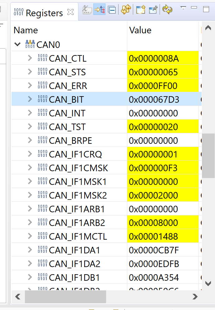

  • Thanks.  I'm still only seeing typical CAN traffic on the Tx pin.  Here's my full initialization sequence:
    void InitializeCAN( uint8_t CANHardwareNumber,
                        uint32_t CANBase,
                        uint32_t CANBitRate,
                        uint32_t ReceiveFilter1,
                        uint32_t ReceiveFilter2,
                        uint32_t ReceiveFilter3,
                        uint32_t IDMask,
                        uint32_t SourceClock )
        uint16_t ui16CANCTL;
        CANInit( CANBase );
        //for 120MHz clock
        tCANBitClkParms CANBitClkSettings = {13, 1, 1, 8};
        CANBitTimingSet(CANBase, &CANBitClkSettings);
    #endif
            CANEnable( CANBase );
            //Set Test bit in control register, which write-enables test register.
            ui16CANCTL = HWREG(CANBase + CAN_O_CTL);
            HWREG(CANBase + CAN_O_CTL) = ui16CANCTL | CAN_CTL_TEST;
            //Enable sample point test
            HWREG(CANBase + CAN_O_TST) = CAN_TST_TX_SAMPLE;
            CANIntEnable( CANBase, CAN_INT_MASTER | CAN_INT_ERROR );
            /* Configure the receive message FIFO.          */
            CANReceiveFIFO( CANHardwareNumber, ReceiveFilter1, ReceiveFilter2, ReceiveFilter3, IDMask );
            if( CANHardwareNumber == CAN0_BUS )
                IntEnable( INT_CAN0 );
            else if( CANHardwareNumber == CAN1_BUS )
                IntEnable( INT_CAN1 );
            CANControl[CAN0_BUS].StatusControl = 0;
            CANControl[CAN1_BUS].StatusControl = 0;
        CANSendingMonitorValues = 0;
        MonitorValuesRequestedBy = 0;
        CANLargePayloadLastSerialNumber = 0;
        MessageBackupToCANHardwareCounter[CAN0_BUS] = 0;
        MessageBackupToCANHardwareCounter[CAN1_BUS] = 0;
    Is it possible that any of that additional setup is disabling the test mode?
  • What is the purpose of these two lines? Are these mapped back to the hardware CAN control register? Can you provide a screen shot of the relevant CAN registers after running the initialization code?
