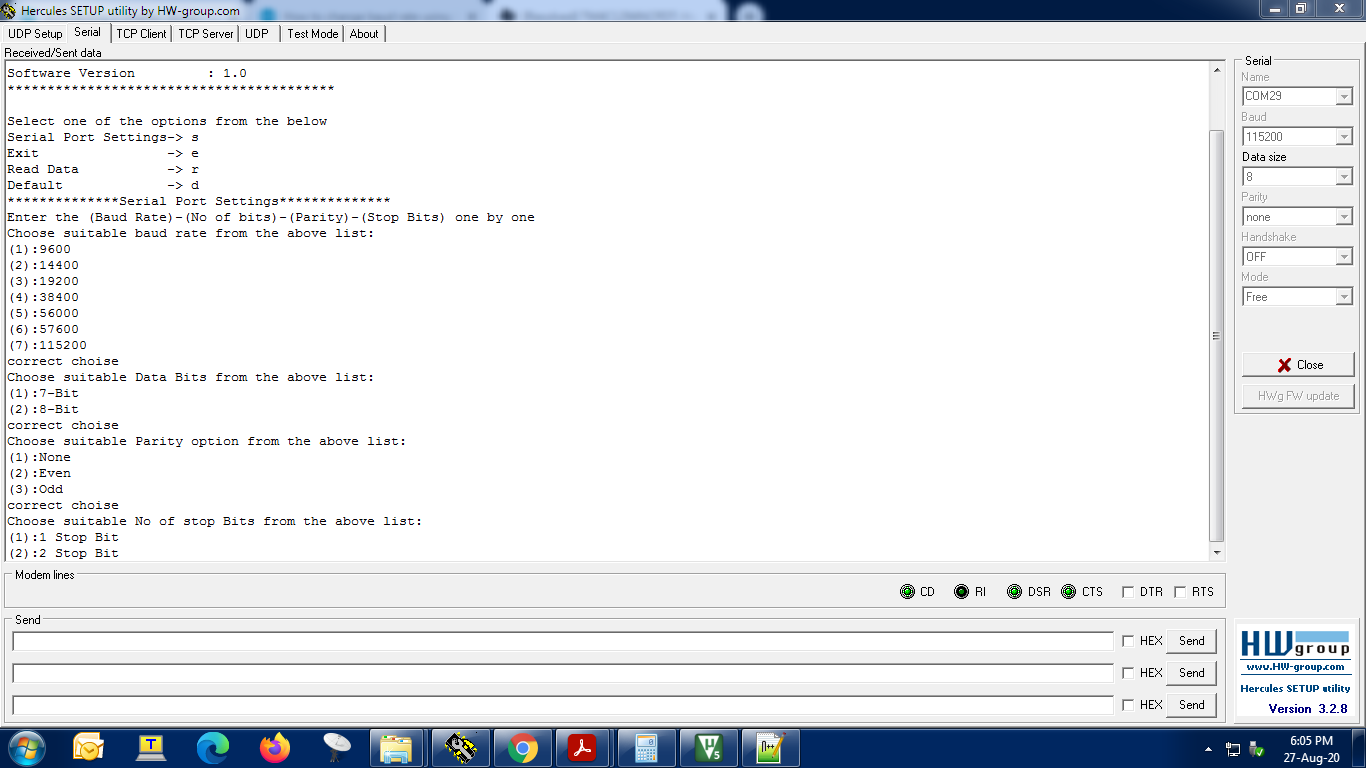

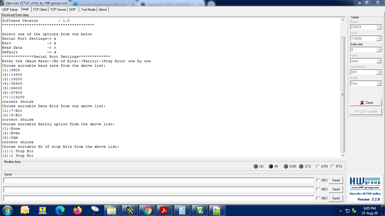

  • Hello Charles
    I tried to change the UART configuration but its not changing. Here I'm attaching code below.

    it's getting stuck at the choose suitable bit.
    Omkar Dixit
  • I don't see any code where you convert from ascii to integer.

      Are you saying after you call the MAP_UARTConfigSetExpClk, the baud rate was not changed?
      First of the all, is below line really called? If it is called, can you single step and also watch the register window for UART0 to see if the baud rate is changed or not. Make sure the setting.baud_rate indeed contains the new baud rate value.
    MAP_UARTConfigSetExpClk(UART0_BASE, ui32SysClock, setting.baud_rate,(setting.Bits |setting.Stop_Bits |setting.parity));
  • Hi
    Thank you so much for giving me a direction. I will definitely try and will update.
    Omkar Dixit
  • Hi Charles
    I checked the UART0_BASE, ui32SysClock, setting.baud_rate,(setting.Bits |setting.Stop_Bits |setting.parity) and there values are not getting changed so i add ASCII values to the switch condition and after this change values are changed.
    But now sir when the UART settings are changed the very next step is to again change the baud rate on the terminal and then see the menu. But, this process is too fast and thats why after changing baud rate on the terminal data is not there but i tried the same thing by adding breakpoint. So by adding breakpoint i can easily change the terminal baud rate and by running again i can able to see the menu again on the different baud rate. But without debugging its not possible.
    That means if i simply flash code and then if i try then the menu is not printing after the setting are changed. But menu is printed even after changing the baud rate if i debug by using breakpoint.
    So i think i need to add somewhere delay so that after settings changed user will change the baud rate so for this process user will take at least some sec so i think i  need to add some sec delay so that automatically execution will stop for that period and after user changed baud rate there will be menu shown.
    Here is the changed code,

  • Hi
    Thank you so much for your detailed message it really helped me. Actually i asked my senior who actually assigned this task to me he simply said client may require in future i'm not sure whether he is clear on this task or not. But, I agree with you that the baud rate should be static.
    Thank You
    Omkar
