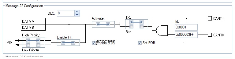

I've configured this message box for RTR, and it gets invoked when RTR request arrives. See pic below:

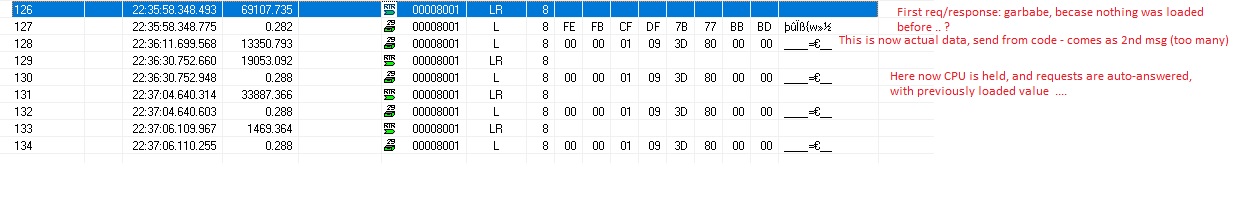

But, I have unwanted behavior , fact that the CAN controller seems automatically fires replies with whatever it had last loaded into this message box.
So, for example, if I hold the CPU halted with debugger, and send RTR frame from PC host, I get reply from the devboard, even though the code is not running, so the CAN controller seems handling this request automatically.
Which I do not want at all, I need to reply to this request from the code.
And because I also have my own send response, now I get effectively two responses from the card: one which it always fires automatically, followed by my the reply as from code.
My CAN trace would look like this:

  • If the RmtEn bit is set, a matching received Remote Frame will cause the TxRqst bit to be set; the Remote Frame will autonomously be answered by a Data Frame. This is the feature.
  • QJ Wang,
    Yes, I have read that in the manual. So what that means, it is not possible to turn off "autonomously" answering?
    How does one need to set it up then :  If I have set it to RX direction && enable RTR, then I do not get the host's RTR message at all - I do not get the frame in. (without RTR I receive the frames).
    And if I'm forced to use that "autonomous" feature, how to pre-fill that buffer for auto-answer? I'm sketchy / if at all know how/where to do this...
