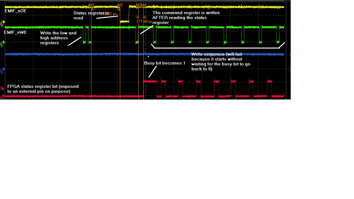

Nevertheless, I've noticed that, no matter what, there's no way I could see the "busy" state of the status register and every time the FPGA looked like idle, so that I proceed with the Flash programming but it unavoidably fails. So I tried to look at the busy bit transitions with the oscilloscope and I found the following:
It looks like the EMIF hardware swaps the order of the code flow by reading first the status register and then writing the command register. According to the TMS570LC43x Technical Reference Manual, section 21.2.13, an asynchronous read's priority is higher than the corresponding write and I was wondering if, since the hardware "may think" that there cannot be any data hazard in the two R/W instructions (the access is two byte so that there's no overlap and they involve different "SRAM-like" addresses), this kind of event may indeed happen.

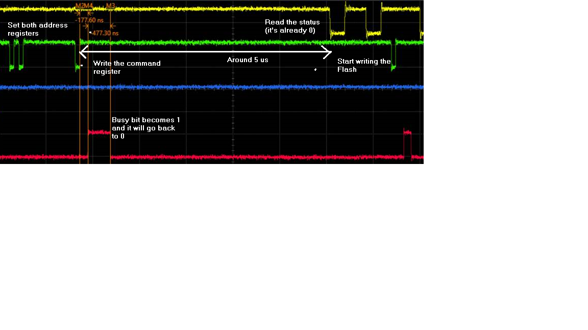

Adding an artificial delay between writing the command register and reading the status register will instead make the sequence go as expected:
Is this behavior normal?
    It could be the Cortex-R5 re-ordering loads and stores to different addresses.
    In HALCoGen what is the "Region Type" set to in the MPU configuration for the EMIF address range?
  • Hello Daniele,
    1. The maximum EMIF clock supported by TMS570LC4357 is 100MHz
    2. Please change the MPU region type (for example, strongly-ordered) for EMIF async1 memory region.
    Indeed I didn't setup the MPU at all for the TMS. This is for sure the cause of the unexpected behavior, thank you very much. I'll follow your instructions.
  • Dear Chester,
    Thank you very much for the reply. It is probably due to the missing configuration of the MPU which uses the default setup with as shared memory for the Async1 region.
