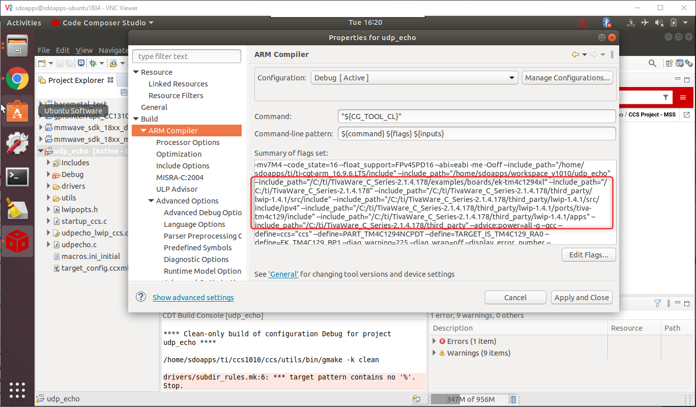

Building fails with the following message:
 drivers/subdir_rules.mk:6: *** target pattern contains no '%' . Stop.
Apparently drivers is a subdirectory under Debug.
subdir_rules.mk seems to be some auto generated file, not to be edited. Text, but barely readable!
Which tweak do I need to perform?
I am running CCS ver. 10 under Ubuntu.

  • OK, I may have some additional info:
    Debug/drivers/subdir_rules.mk contains this:
    # Automatically-generated file. Do not edit!
    # Each subdirectory must supply rules for building sources it contributes
    drivers/pinout.obj: /C:/ti/TivaWare_C_Series-2.1.4.178/examples/boards/ek-tm4c1294xl/drivers/pinout.c $(GEN_OPTS) | $(GEN_FILES) $(GEN_MISC_FILES)
    	@echo 'Building file: "$<"'
    	@echo 'Invoking: ARM Compiler'
    	"/home/vv07/ti/ccs1000/ccs/tools/compiler/ti-cgt-arm_20.2.0.LTS/bin/armcl" -mv7M4 --code_state=16 --float_support=FPv4SPD16 --abi=eabi -me -Ooff --include_path="/home/vv07/ti/ccs1000/ccs/tools/compiler/ti-cgt-arm_20.2.0.LTS/include" --include_path="/home/vv07/workspace_v10/udp_echo" --include_path="/C:/ti/TivaWare_C_Series-2.1.4.178/examples/boards/ek-tm4c1294xl" --include_path="/C:/ti/TivaWare_C_Series-2.1.4.178" --include_path="/C:/ti/TivaWare_C_Series-2.1.4.178/third_party/lwip-1.4.1/src/include" --include_path="/C:/ti/TivaWare_C_Series-2.1.4.178/third_party/lwip-1.4.1/src/include/ipv4" --include_path="/C:/ti/TivaWare_C_Series-2.1.4.178/third_party/lwip-1.4.1/ports/tiva-tm4c129/include" --include_path="/C:/ti/TivaWare_C_Series-2.1.4.178/third_party/lwip-1.4.1/apps" --include_path="/C:/ti/TivaWare_C_Series-2.1.4.178/third_party" --advice:power=all -g --gcc --define=ccs="ccs" --define=PART_TM4C1294NCPDT --define=TARGET_IS_TM4C129_RA0 --define=EK_TM4C129_BP1 --diag_warning=225 --diag_wrap=off --display_error_number --gen_func_subsections=on --ual --preproc_with_compile --preproc_dependency="drivers/$(basename $(<F)).d_raw" --obj_directory="drivers" $(GEN_OPTS__FLAG) "$(shell echo $<)"
    	@echo 'Finished building: "$<"'
    	@echo ' '
    Line 6 (the drivers/pinout.obj: statement) is marked with a red error marker. And correct, it does not contain a '%' sign.
    The pinout.c file specified does exist at that location.  It does not seem to contain a '%' sign either.
    It was in a read-only state, which I have removed.
    I still get the same error.
    The .mk file must be remade at every build, because I must reload it in order to see the error marker again, but there it is!

    Looks like you took a project developed on Windows and trying to build on Linux.
    When checking your build flags, I see many Windows paths for the include search paths:

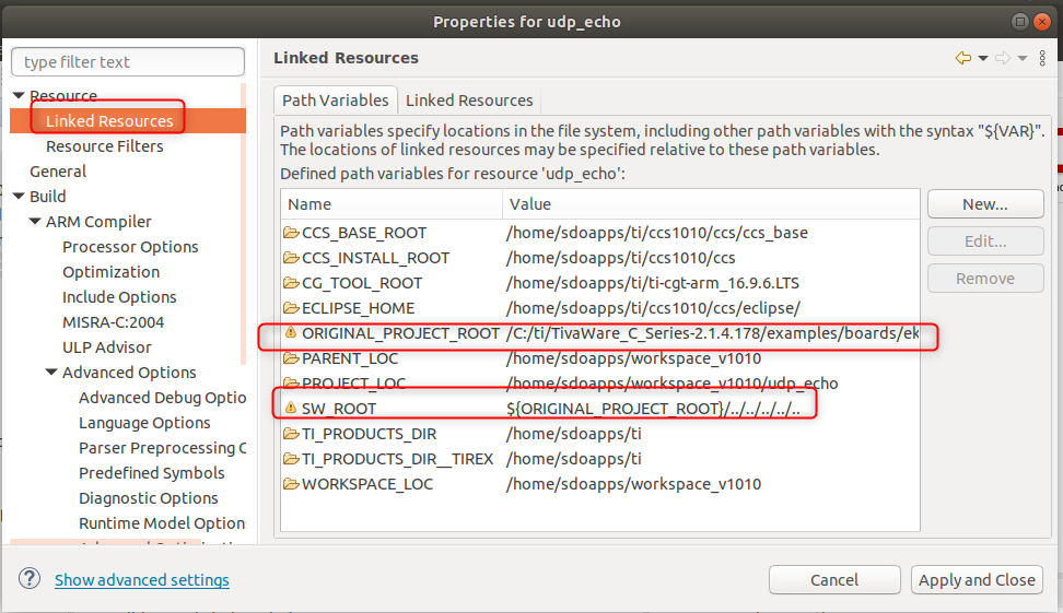

    Those include search paths rely on a variable "SW_ROOT":
    When I check the linked resource variables list, I see that SW_ROOT relies on ORIGINAL_PROJECT_ROOT. This variable has an absolute Windows path. It is this Windows path (or more specifically the semi-colon in it) that is the cause of the make error you see.
    Please fix ORIGINAL_PROJECT_ROOT (or SW_ROOT) to point to valid paths on your Linux environment.

  • Thanks Ki, your post did something, but not quite the cigar.
    I have tried letting 'Original' point to various valid directories, including udp_echo. All result in the same error.
    Only now it is Debug/startup_ccs.d that fails.

  • Did you clean the project first? Once I cleaned the project (after fixing the linked resource paths), the project built fine.
