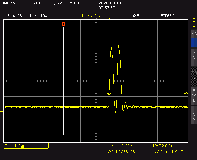

I' working with the DK-TM4C129X on the Quad-SPI Flash, where I could find the same problem as in my "real" target hardware.So I'm referring to the DK and there usb_dev project, as this can be easier cross-checked. The example usb_dev etc. works, but when I look into the details, I found that the MX66L51235FRead() functions does only use single-SPI.
I changed the MX66L51235FRead() and the reading ROM function from
    ROM_SPIFlashRead(SSI3_BASE, ui32Addr, pui8Data, ui32Count);
to
    ROM_SPIFlashDualRead(SSI3_BASE, ui32Addr, pui8Data, ui32Count);
which still runs. I checked the oszilloscope and saw the 2xtimes Outputs as expected. But when using
    ROM_SPIFlashQuadRead(SSI3_BASE, ui32Addr, pui8Data, ui32Count);
the result is obviously wrong. Do I have to consider something special or is there something missing?

  • Well,  I write 1,2,3,4 to the flash.
    I re-read it and I retrieve this values back with ROM_SPIFlashRead and ROM_SPIDualFlashRead but not with ROM_SPIFlashQuadRead.
    The latter I see something as AA,AA,AA,AA. If I write lager packets, I see sometimes values I wrote, but only a few and more random-wise.
    Edit: You can check it easily with DK-TM4C129X. I've also a customized hardware with a different Flash, but same behavior. With both I also did test ROM_SPIFlashXXXXReadNonBlocking with DMA, which runs also only with Single or Dualmode and not Quadmode

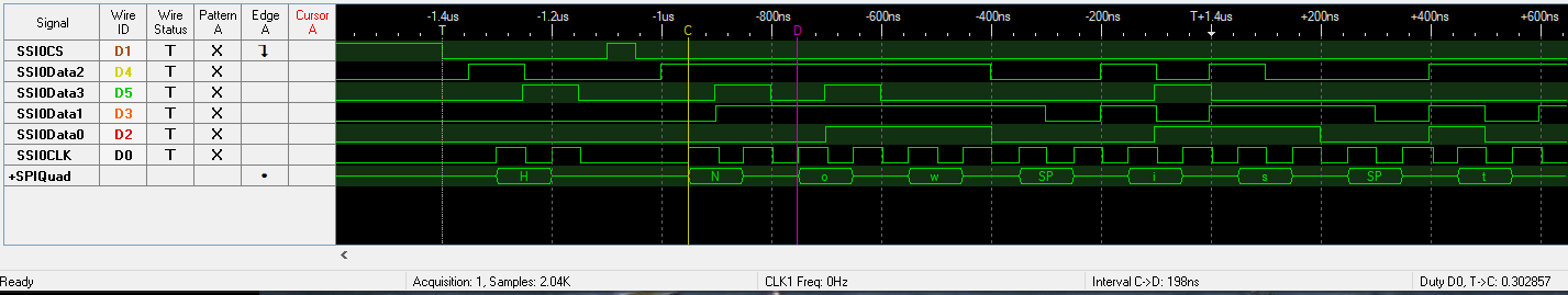

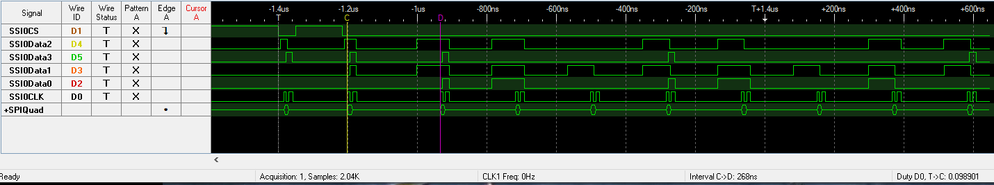

    void MX66L51235FRead(uint32_t ui32Addr, uint8_t *pui8Data, uint32_t ui32Count) { // // Write the extended address register. // MX66L51235FWriteEAR(ui32Addr); // // Assert the chip select to the MX66L51235F. // ROM_GPIOPinWrite(GPIO_PORTQ_BASE, GPIO_PIN_1, 0); uint32_t uTrash; while(MAP_SSIDataGetNonBlocking(SSI3_BASE, &uTrash)) { } // // Read the requested data. // ROM_SPIFlashQuadRead(SSI3_BASE, ui32Addr, pui8Data, ui32Count); // // De-assert the chip select to the MX66L51235F. // ROM_GPIOPinWrite(GPIO_PORTQ_BASE, GPIO_PIN_1, GPIO_PIN_1); }
    In this case, if only 4-bit are disturbed it should be better seen. The result in the debugger in g_pui8MX66L51235FData is 0xCC,0xCC followed 30 times by 0xDD.
    Here the Chip Select Signal in Quadmode:
    If I look at the DAT0...DAT3 lines, I see in Dual mode, that DAT0 and DAT1 is carrying the bits. In Quadmode I don't see Bits on DAT1 to DTA3. This will mean, somehow the driver is not configuring the flash properly or the flash is not working properly with the non continuous CLK Signal.
    Micky

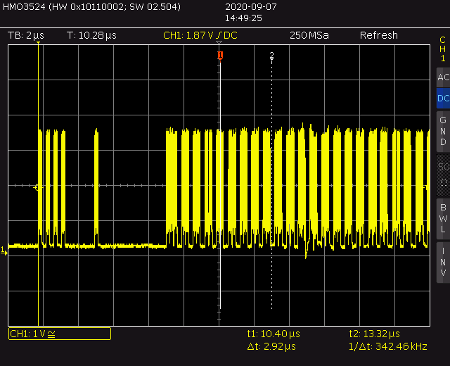

  • Since I have a DK-TM4C129X design kit, Charles asked me to look into this. I created a small test case and I am able to reproduce your results. I will debug it and let you know what I find.
  • Hi Bob,
    thanks for the feedback and the support.
    BTW: I have exactly the same issue if using DMA (SPIFlashReadQuadNonBlocking). With that, there are still a lot of pauses during DMA Transfer, which has the consequence, that Single SPI transfer is only about 10% faster than Dual (as told, quad doesnot work properly). In single mode, there is no pause.
    This will be my next question, if it would be possible to decreases the pause between the DMA reads by any configuration.
    Micky

    with a Winbond W25Q128JV I don't have the configuration issue, as I ordered one, with already being in the non volatile Quad Mode. Nevertheless I donot get correct results.
    I tried the NonBlocking functions with DMA, and watched the clock signals (see above plot).  I'd expected them more continuously. I see only 2 Clocks and then a bigger gap. Perhaps this is somehow disturbing the Flash or this is disturbing the W25Q128JV but not the DK-Flash and the latter doesnot work due to the configuration. I'm waiting for your reply.
    I also tried to get more continuous read clocks to the Flash by mutating UDMA_ARB_xx in the DMA function SPIFlashIntHandler of spi_flash.c:
     uDMAChannelControlSet(pState->ui32TxChannel,
                                              UDMA_SRC_INC_NONE |
                                              UDMA_DST_INC_NONE |
                                              UDMA_SIZE_8 | UDMA_ARB_2);
     uDMAChannelControlSet(pState->ui32RxChannel,
                                              UDMA_SRC_INC_NONE |
                                              UDMA_DST_INC_8 |
                                              UDMA_SIZE_8 | UDMA_ARB_4);
    I can change the read results with that, but the results are not better or the transfer stops working. Again, DMA Dualmode does work. If I alter the defaults of UDMA_ARB_xx above, I get wrong results on both Flashes.
    Additionally the overall performance is disappointing. With my 80 MHz System clock (40 MHz for SPI of W25Q128JV) I have about 5 MByte/s with DMA in single mode (that's good of course). In Dual mode I have about 6 MByte/s, in Quad mode (wrong results, but anyway) I have about 7 MBytes/s. So although the number of lines doubles, the increase of performance is very low. The DMA inserts gaps (see above plot). Can this be tuned somehow?
    Regards.
  • Did you attach new plots, or are you referring to the earlier scope shots of September 10th? I too see the gaps between pairs of clock edges in quad mode. That is a function of the SPI state-machine and unfortunately cannot be changed.
  • Yes, I'm referring to the scope shots of September 10th. I'm curious, if you manage to make the DK Flash working in Quad mode, or if this mode is not working at all in combination of Flash and TM4C.
    Attached I measured with the Dual Mode with DMA. There are also gaps, but the device is read 8 times (16 Bit) , then a small gap and than a bigger one. The second shot is a more complete shot for many addreses . There is a relative long setup of the flash and then the DMA bursts.

    Now increasing the SSI clock to 20MHz, we see gaps in the SSI clock and the time to transfer one byte is still 200nS.
    The clock pulses got smaller as expected, but the throughput is still limited. Increasing the SSI clock to the maximum of 60MHz causes a small additional delay, probably due to synchronization.
    Bottom line, in quad mode the maximum transfer rate is 5M Bytes/s. There is no advantage in running the SSI clock faster than 10MHz.
    Likewise, in Bi mode, the maximum transfer rate is also 5M Bytes/s, but using a 20MHz SSI clock. All of this is based on a 120MHz system clock. (In the last image note that my logic analyzer does not decode Bi- mode. Ignore the interpreter which is the bottom line.)
