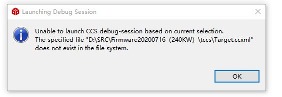

my customer is using TM4C. And, when launching CCS debug session, some error like below was shown up. How to deal with it? Thanks for your help!

That error means the CCS project is trying to use a 'Default' target config file. In the project they should have a target_config.ccxml file. They can right click that file and select "Set as Active Target Configuration" and then recompile the project.
