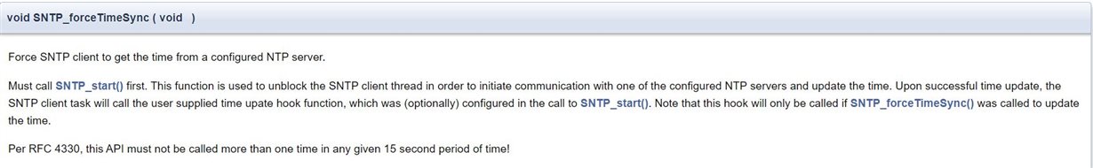

  • HI,
      Please see below description.
    snip....
    SNTP_forceTimeSync();
    Semaphore_pend(semHandle, BIOS_WAIT_FOREVER);
    snip....
    * ======== timeUpdateHook ========
    * Called after NTP time sync
    void timeUpdateHook(void *p)
    Semaphore_post(semHandle);
