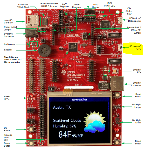

I have the TM4C129X demo board the SD card example works great. However, when I run the usb_dev_msc example it shows status "disconnected" both counters = 0.
The jumper are seems to be set correctly. The "USBDMSCEventCallback" never gets called the structures with the callback is being passed:
USBDMSCInit(0, (tUSBDMSCDevice*)&g_sMSCDevice);
What am I missing?
