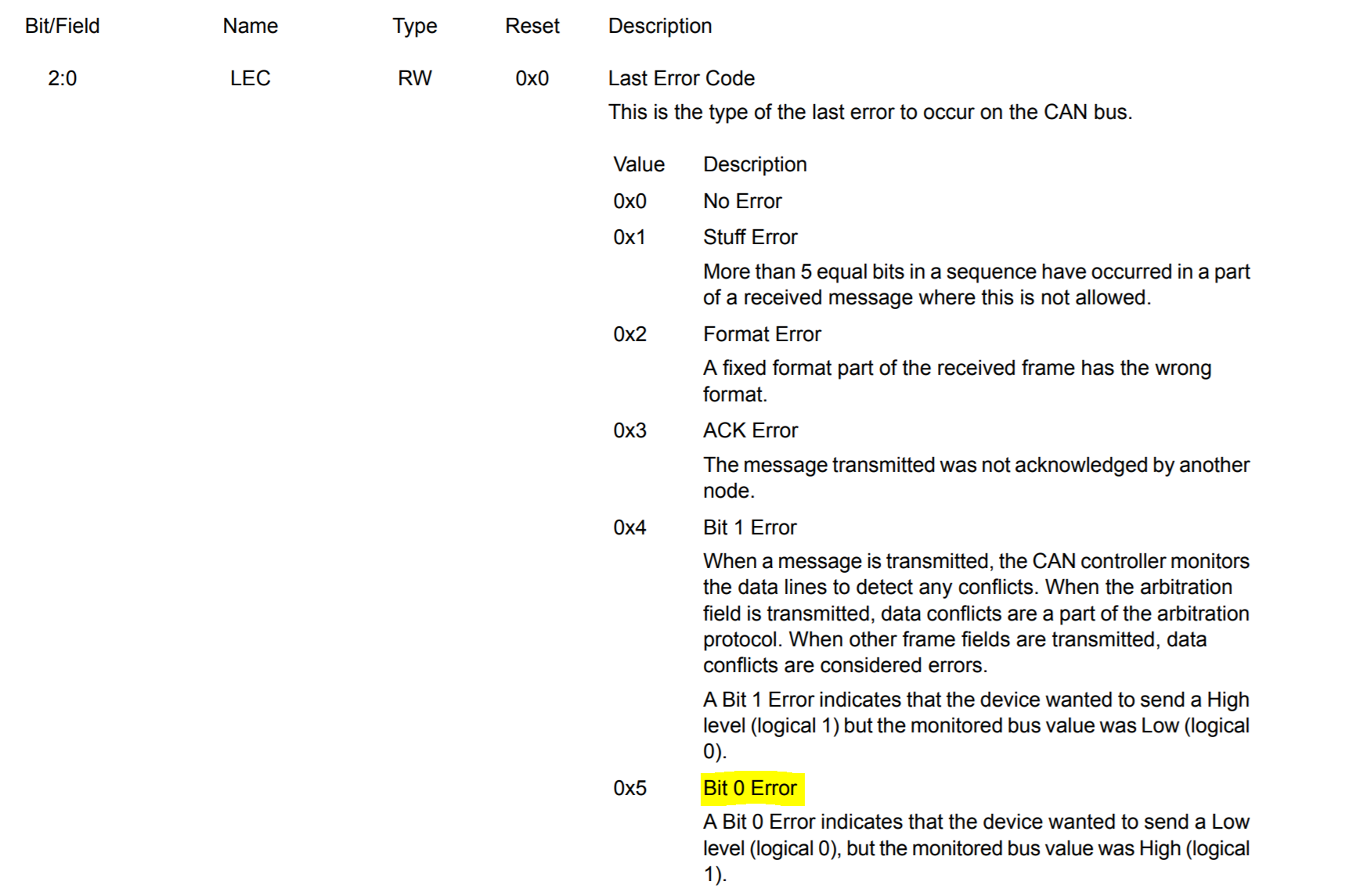

  • OK, that makes more sense. In both cases the last error code (LEC) is 0x5, which means that the Launchpad was trying to send a zero (dominate) but read back a one (passive). Check the CAN bus with an oscilloscope. If the bus is properly switching between passive and active, check the routing of the RX signal from the transducer to the Launchpad. If you can still see an active low signal going to the CAN RX pin of the Launchpad, double check the software to make sure it is configuring the same pin for CANRX as you connected to. The example is generic and the appropriate pins must be configured. There are three possible pin choices for CAN0RX, PB4, PE4 or PF0. Which pins are you using? (Or are you using CAN1?) If you used PF0, there is additional code needed to unlock the configuration registers as that pin can be used as the NMI.

  • The LEC (last error code) is the last three bits of the CAN status register. The error codes are shown on page 1074 of the data sheet:

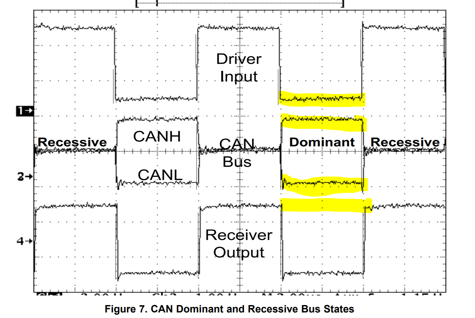

    A bit 0 error means the CANTX pin was trying to drive a low, but it saw a high on the CANRX pin. In proper operation when a CAN module has control of the bus, it should see the same state on CANRX as it is driving on CANTX. From page 8 of the application report here is what a proper 0 bit looks like.
    Using a scope, trigger off of the following edge of CANTX (trace 1). Check to see that CANH (trace 2) is high and CANL (trace 3) is low on the bus. If it is, check that CANRX (trace 4) is low. What error code 5 is telling you is that when CANTX was low, CANRX was still high.
