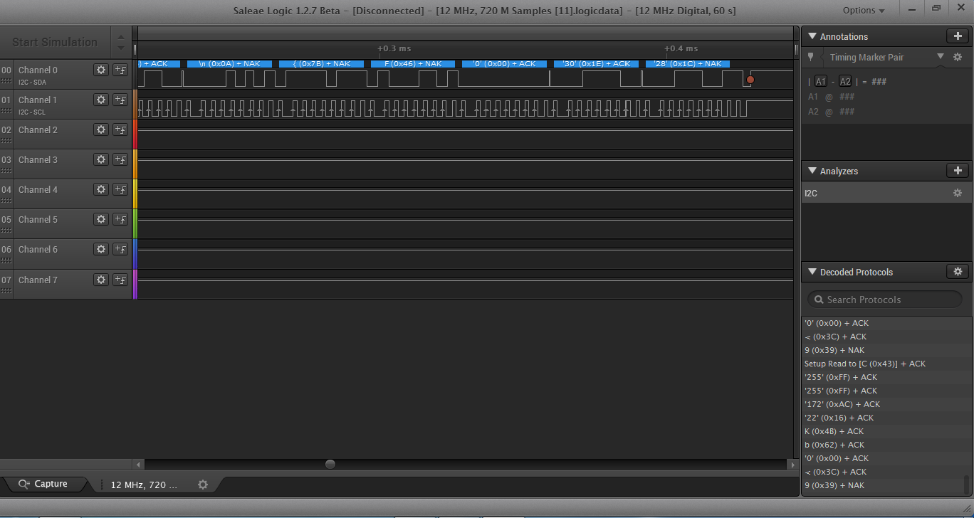

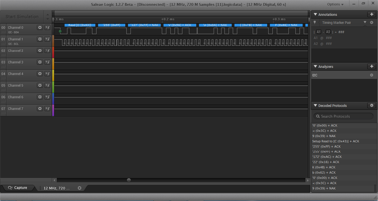

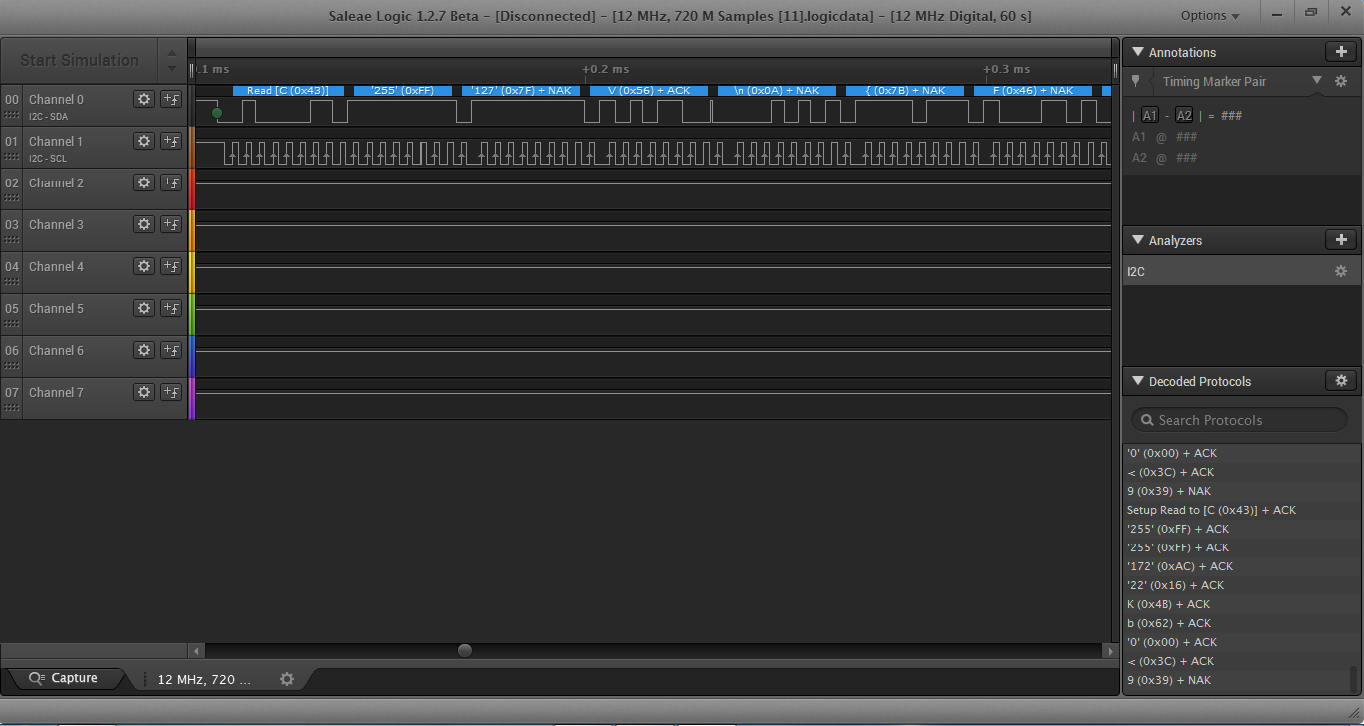

We are communicating a sensor with TM4C1294 controller on I2C bus. It is working fine for a few minutes and after that code stuck in while(I2CMasterBusy(ui32Base)); function. We have checked the SDA, SCL line on logic analyzer and found that some times controller responds with a NACK and after that code hanging problems starts. We have used a 20ms timeout condition in while(I2CMasterBusy(ui32Base)); function to come out of the function and resend the command to the sensor. This is also working for a while but after some time controller stops sending the read command to the sensor even if it is going in the I2C function.

For the reference purpose, i have attached screenshots of the logic analyzer.
