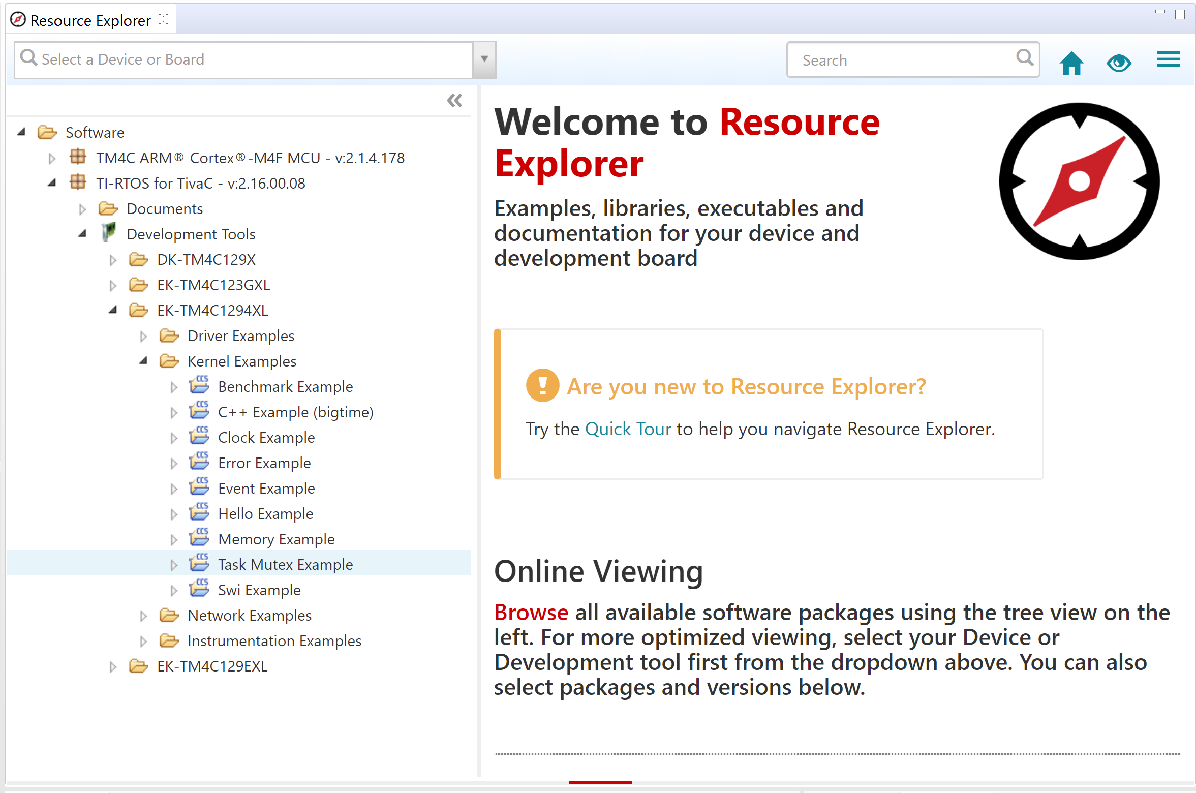

  • If you are trying to use a semaphore as a mutex, there is an example available in Resource Explorer called "Task Mutex Example".
  • Hello Bob,
    Thanks alot for your input. I read the training you posted and it was helpful. And I am not sure where to check the validity of the semaphore. The mutex example is a bit sophisticated for me since I am being unable to use semaphores correctly.
    All i am trying to do is to to protect the "Board_LED0"  which is being accessed by 2 different tasks. first task should blink the led twice for 500ms and the task should blink the led 3 times  for 5000ms and thats it.

    Since you are using the semaphore as a MUTEX to control access to hardware, I suggest that you use a binary semaphore instead of a counting semaphore and that you set it to 1 (true) before the call to BIOS_start(). The semaphore is created as a binary semaphore by line 85 above, and it is set to 1 by line 91.
    In the tasks you must initialize the variable i in the "for" loop. The "for" loop is called multiple times. Lines 41 and 59.
    Finally, I was not sure what you meant by "blink two times for 500mS". I took that to mean 250mS on and 250mS off two times. Of course you can easily change that. Hope this helps.
