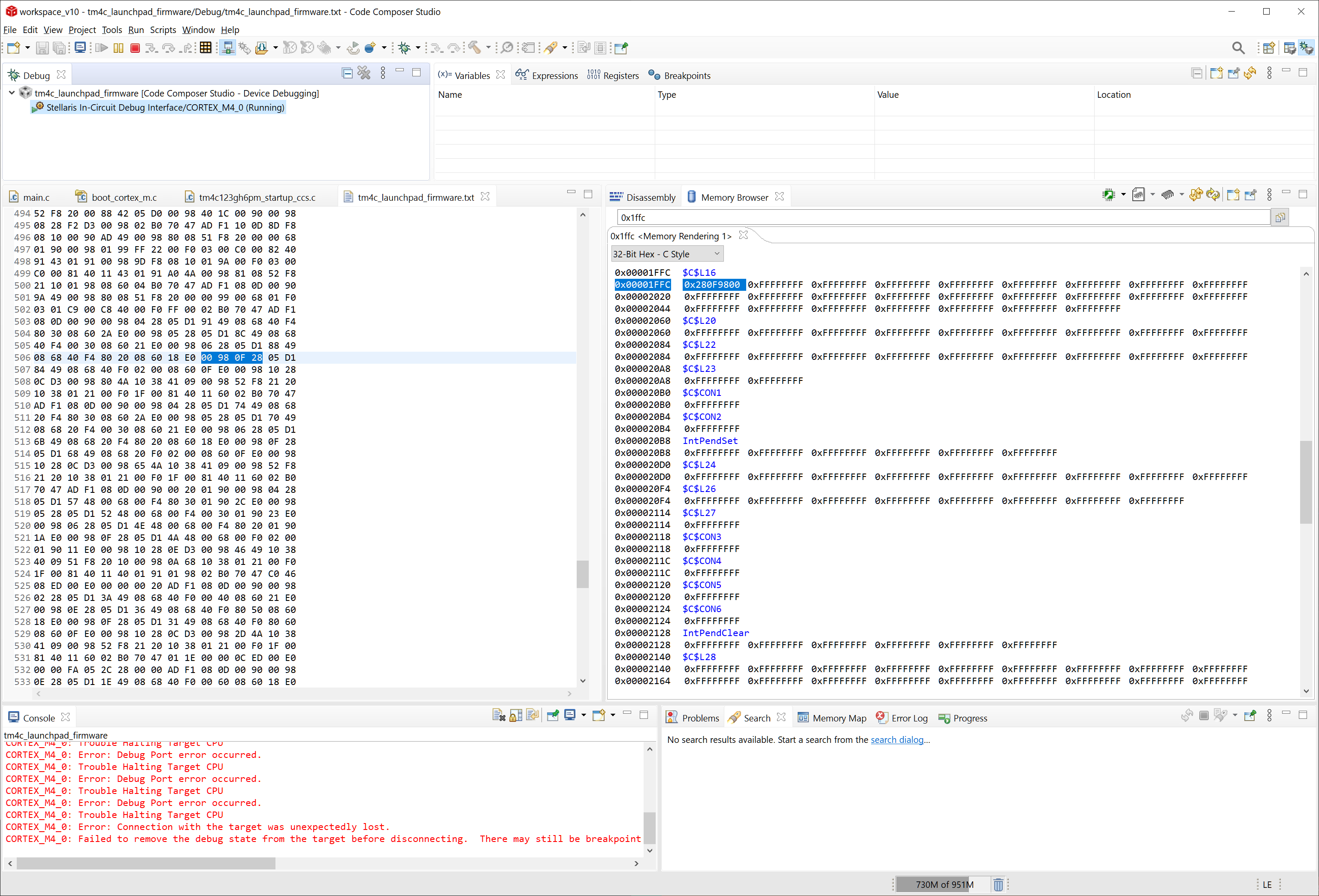

EK-TM4C123GXL: ROM Bootloader memory corruption
Part Number: EK-TM4C123GXL
I'm trying to do a firmware upgrade using the ROM Bootloader and am having issues with corruption of the memory. The general steps that I'm doing:
  • Putting device into bootloader mode
  • Following the instructions in the Bootloader Manual write data. Data is written, as I can use the debugger to check that the Flash is reset to 0xFFFFFFFF and changes to the values that I'm writing. I successfully fill the flash memory with the memory address, so the protocol is implemented. Logic analyzer traces confirm the protocol is also working, and not return code errors are being issues by the TM4C.
  • Export the code in code composer studio as a TI text Hex file (attached).
  • Parse the Hex file and start writing the file to the TM4C bootloader starting at address 0, making sure to change addresses as dictated by the hex file. Picture 1 shows that the data appears to be written correctly; the left is the hex file, the right is the memory as seen by the debugger.
  • Somewhere along the way, always at address 0x1FFC, the data appears to be written, but after the unit is issued the reset command the memory after 0x1FFC until the next hex address called out in the hex file (0x231C) is reset to 0xFFFFFFFF. Picture 2 shows the hex file with the highlighted value that corresponds to 0x1FFC on the right. Picture 3 shows that the next memory region is again valid.
Questions:
  • Any guidance as to why I can write the addresses successfully without corruption, but when writing a valid program, the memory appears to be corrupted (always at the same address).
  • Any guidance on when to write certain areas of memory? Is the program starting to run as I start writing or something odd?
Thank you for any help, I'm happy to provide more data as needed.
Austin McElroy
Picture 1:
Picture 2:
Picture 3:

  • There are 3 discreet address blocks in the hex file, which should require 3 different calls to the Download command. It seems the 2nd time I call the download to write to the 2nd chunk of memory, is when the memory starts to get corrupted. Do I need to reset the device in between calls to download or parse such that I am making only one call to the download command?
  • Hello Austin,
    I'm a little unclear about a couple pieces here.
    One, you mention the ROM Bootloader, what interface are you trying to use with that boot loader? UART? SPI? USB?
    Two, are you developing your own interface to push data into the ROM Bootloader? Is the issue here basically trying to assess how to send data into the device via that specific interface?
    Three, do you have the ability to run the serial bootloader application we provided with the app note? The reason I ask about that is it would give you a way to look over your LSA to see how to send the right packets. I can do the same if I know what interface is being used though.
  • Hello Austin,
    Well, that doesn't seem to be the problem here though? You seem to be writing the right data at the right spot? There shouldn't need to be a reset between them.
    By the way Pictures 1 and 2 are identical... anyways, so do you actually see the the data from 0x1FFC is correct before a reset? Maybe you can try and use Uniflash to read out memory after running your SBL? I'm wondering if maybe your length field for the SBL is wrong so it's not programming those last bytes...
  • Hey Ralph,
    I think I figured it out by re-writing my firmware parsing program to generate a single monolithic byte array that is written, instead of the 3 discreet chunks of memory that is denoted in the hex file. It seems that calling the download multiple times leads to a semi-undefined but repeatable state that is corrupting the memory.
    To answers the other questions:
    • Using the ROM Bootloader with I2C
    • There is an nRF52840 microcontroller getting Bluetooth over-the-air firmware from a phone that is getting that data from a server. The nRF52840 and TM4C are connected by 4 wires:
      • I2C0 SDA
      • I2C0 SCL
      • A reset pin
      • A bootloader pin
    • Oops, yes, picture one and two are identical. Sorry about that.
    Edit - The monolithic byte array seems to have solved the problem: https://www.youtube.com/watch?v=nDKmMyAobDM&ab_channel=AustinMcElroy
