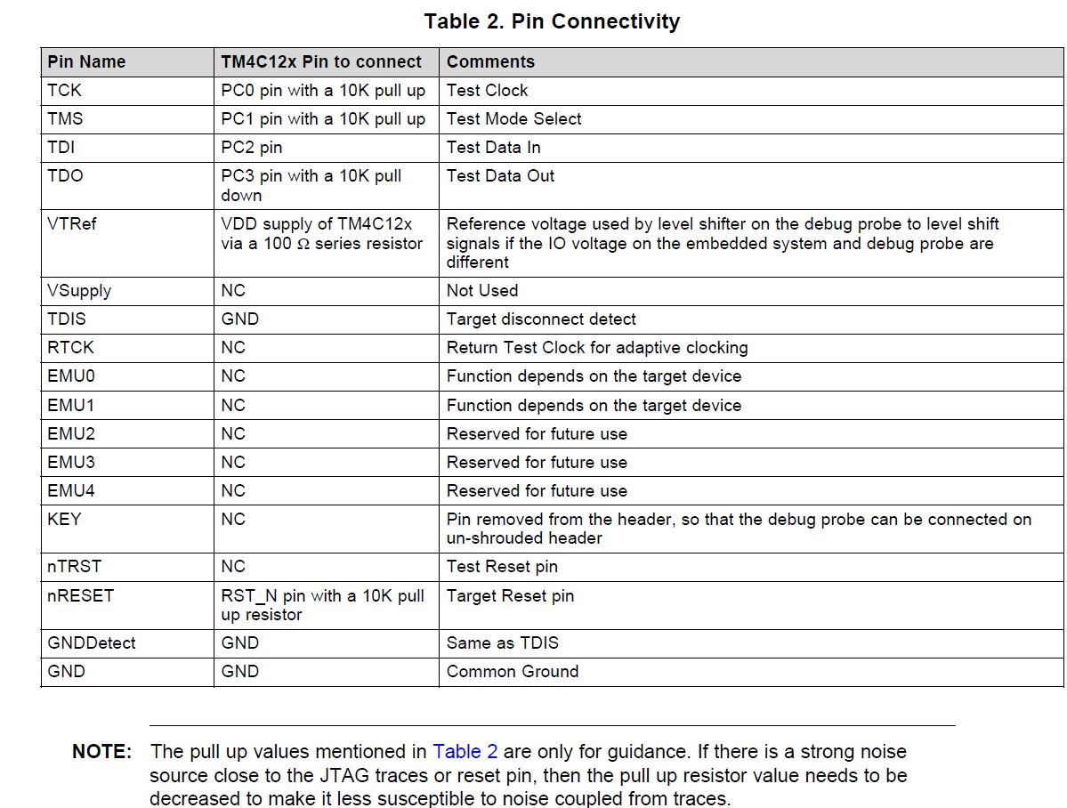

      Let me know the result of your second board. Can you also follow the connection shown in the below table. You can find the detail in the app note I sent in my first reply. There is a recommendation of a pullup on the nRESET pin but I don't see it in your schematic. Another thing I will suggest you try is to use your EK-TM4c1294XL board to debug another EK-TM4C1294XL board. This way you can find out if the problem is with your custom board or with the debug output from the EK-TM4C1294XL. In another word, if also fail to debug your second EK-TM4C1294XL board then the problem may lay with your first EK-TM4C1294XL board which acts as the debug probe.

    I don't see listed (windows device manger) a connected USB to XDS1xx driver being loaded. The virtual COM16 is not the JTAG connection. Charles idea to use a lunch pad JTAG port to flash your custom board requires a few strap changes to isolate it from the local target MCU for remote target use. Anyway if you plug in launch pad debug port to computer USB, debug probe drivers should show up in device manager.
    Launch pad R8,10,11,15,16, 40 has to be removed and J6 has 10 pin ribbon cable for JTAG your board.

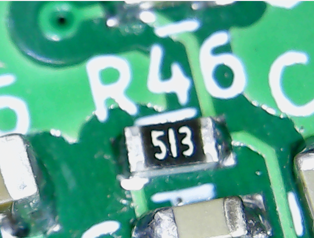

    In my soldering, I found a mistake. I soldered 51K instead of 51R for R46. Please have a look below:
    I removed 51K and soldered 51R.
    It didnt work after correcting R46. But it is a very complex PCB. Maybe it has another mistakes.
