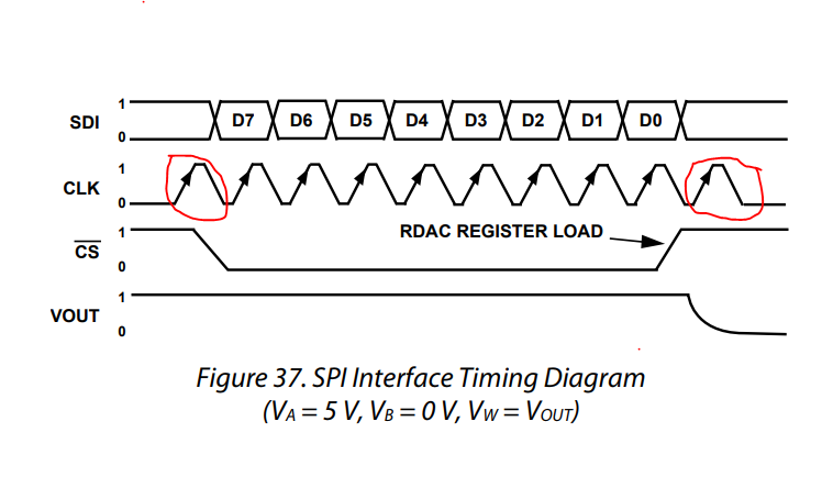

I want to use MIBSPI function to control the digital potentiometers by sending an 8-bit information.  I attached the timing diagram:
As we could see there are 2 extra CLK pulses, one is generated before the CS drops, and another is generated after transmission. So could you give me some suggestions?
Li Jiakai
    Is the 1st and 10th clocks have to be generated when nCS is HIGH? If this is true, SPI can not be used for this potentiometers. If not, you can configure the charlen=10 to generate 10 cycles clock signal, and skip the 1st and last bit of the read data.
