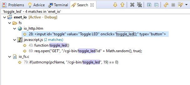

    I was trying to create another clickable button like the one you have in the demo example. I came across this line of code in the .js file:
    req.open("GET", "/cgi-bin/toggle_led?id" + Math.random(), true);
    I would like to know where is this file located: "/cgi-bin/toggle_led?id"
    In other words I want to know how are you guys naming this files that comes after "GET" in the req.open
    Thank you!
      With some searches, you can find the reference to toggle_led. Check the io_http.htm file and also the io_fs.c file. I'm not the expert in the enet_io either as it was created long time ago for the TivaWare library. Let us know how it goes so you can share with the community.
