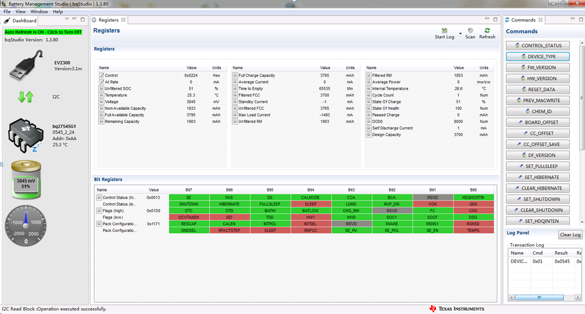

Do you know the package type of the IC, Is it DSBGA (YZF) or VSON (DRZ)?
It is VSON (DRZ).

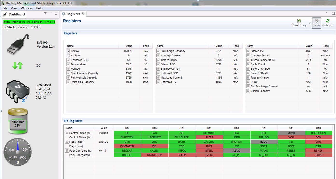

I received a response from the hardware team that there is no known way the device number can change as described.
The finished battery probably has a BQ27545-G1 in it. The bq27541-G1 and BQ27545-G1 have similar functionality and may be used as replacements for the other when inventory is low.
Please take a picture of the top marking of the IC and post if you find that the finished battery has a bq27541-G1 IC in it.
Please update the status of this thread based on what you find.
