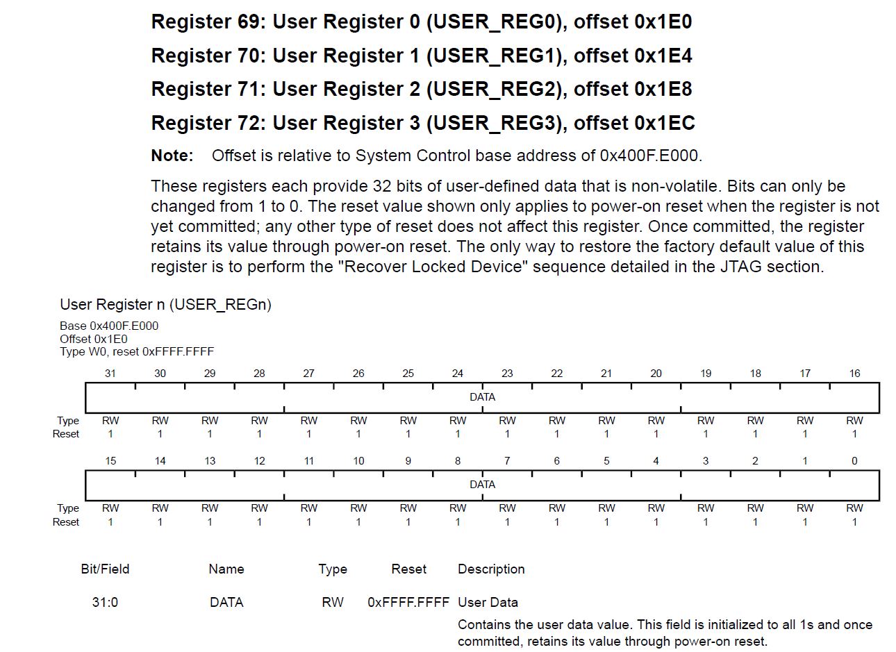

  • Hi Charles,
    thanks for that. Is there a way of putting the initial values into the eeprom using Uniflash (or equivalent)
    Andy
  • Hi Andy,
      No, there is no such tool available even though it is possible in theory. One can develop a tool that will download the program (e.g. a program similar to the one I show in the last reply) via JTAG interface or even via other serial interfaces using the bootloader. The program will then program the initial values to the EEprom. With that said, the Uniflash or the LM flash programmer does have some capability to program 2 user words to the non-volatile memory. However, the 2 user words are programmable for one-time only. You cannot change them unless you do a "unlock device" which will perform a mass-erase of the entire device including the main flash memory and the EEprom.
