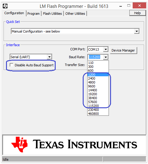

I am using proprietary hardware with TM4C129ENCPDT running on a 12 MHz crystal and using UART0 for programming using LM Flash Programmer – Build 1613. Default ROM boot loader is used. I don’t use any custom boot loader. When I try to program using LM Flash Programmer with the below configuration, I get the error **ERROR**: Failed to establish communication with the board. I tried with different baud rates and not successful
But when the auto baud request 0x55, 0x55 is sent using a terminal program like Dock-light or Tera Term the device responds with ACK packet (“00”, “CC”).
After that if the device is programmed using LM Flash (by disabling the Auto Baud Support), the programming is successful.

  • It appears that the autobaud sequence is not working. I don't know the reason. The units that don't work, do they always fail to respond to LM Flash Programmer autobaud sequence, or only some of the time? You mentioned you tried several baud rates, which baud rates did you try? Did you reset the device between each attempt? Have you looked at the UART TX pin with a scope or logic analyzer to see if the device is trying to send an acknowledge, but at the wrong baud rate?

    Yes. The units which do not work, always fail to respond to LM Flash programmer auto baud sequence. At least we had tried more than 10 times in the same device. Also we ensured power off and on for every attempt we tried. We have tried in more than 10 such devices in the Filed and observed the same behavior.
    We tried with the Baud Rate range from 1200 Baud to 115200 Baud Rate with Auto Baud Rate enabled (no tick mark in the Disable Auto Baud Support) and resetting the device on every attempt (by Power-Off and then on). Not successful.

  • Thank you, That helps me understand your system much better. I do not have a good explanation of why the 0xAA 0xAA from LMFLASH Programmer does not properly autobaud some devices while the same characters from a terminal emulator work. How do you reset the device? Is it by power cycle or by asserting a low on the RST- pin? Is the UART0 RX pin (PA0) being held high by the time RST- is released? The autobaud is done by generating interrupts on both rising and falling edges on PA0. The times of 18 edges are collected and the pulse widths are compared for determining the baud rate. Noise on PA0 could cause an issue.
