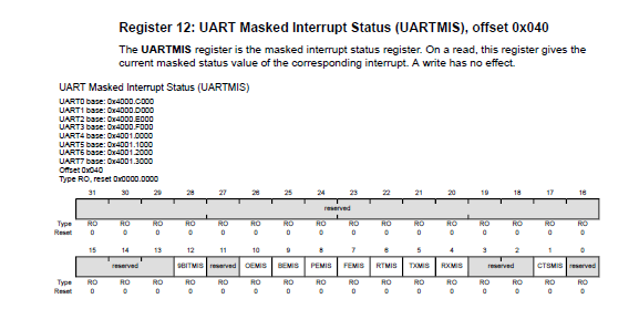

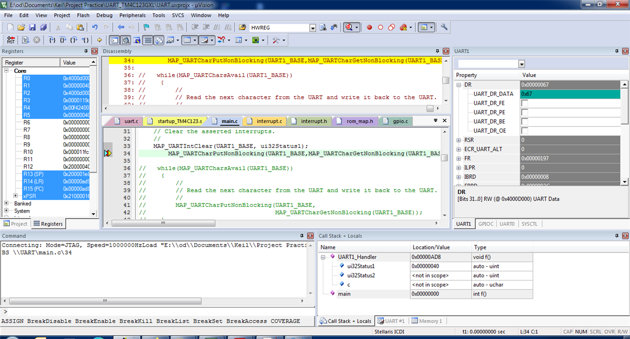

Also while debugging i put breakpoint over this line "ui32Status = MAP_UARTIntStatus(UART1_BASE, true);" i observed i'm getting 0x40 value in the "ui32Status" that means in the "MIS" register "RTMIS" bit is getting set whenever we put data on the UART1. What does that exactly mean?? i read  data sheet but i didn't got any idea.
When i send character "G" via serial terminal i saw data register of the UART1 changed.
One more thing i observed whenever we enter any character control is going  into the uart handler. Then what should be the reason for not printing on the terminal??
I'm attaching code as well as register pics. Any help will be really
