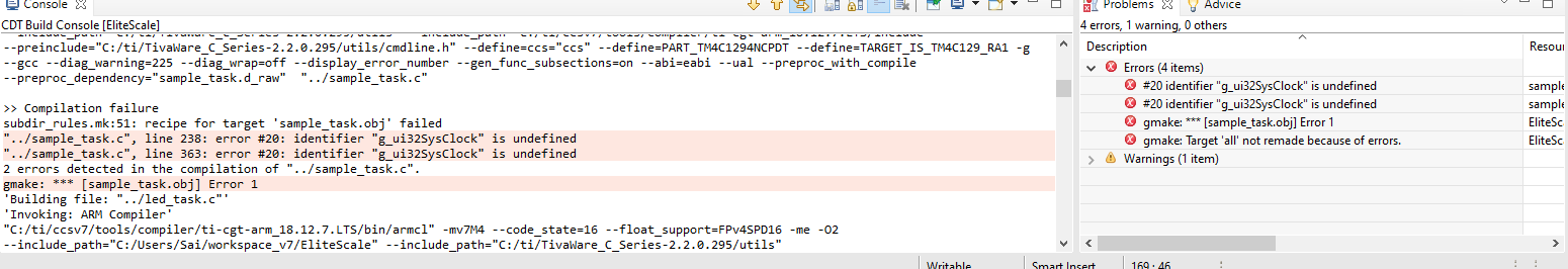

I'm currently working on migrating existing application from LM3S9B92 to EK-TM4C129XL for prototyping the application.

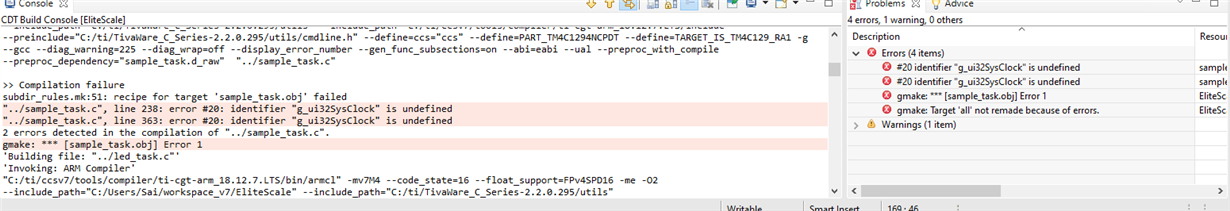

1) SysCtlClockSet()  and 2) SysCtlClockGet()  fucntions are replaced by SysCtlClockFreqSet() in EK-TM4C129XL. However, the return value from the SysCtlClockFreqSet() get stored in g_ui32SysClock. How to make variable shared by multiple source files particularly if I don't have SysCtlClockGet()  fucntion . Looking forward to hearing from you all. Please find the snippet for the error.
Sai
  • There are two simple options. The first is to declare the variable g_ui32SysClock as extern in each file where it is referenced. This is often done in a header (.h) file.
    extern uint32_t g_ui32SysClock;
    The other method is to create a function in the file where you defined g_ui32SysClock, that simply returns that value.
    uint32_t mySysCtlClockFreqGet(void)
        return g_ui32SysClock;
