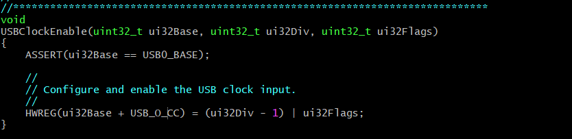

I was reading through the TivaWare USB Library, for debugging something. While going through I came across the USBClockEnable( ) function.
Looking at what this function does, I see it's writing to a register USB_O_CC or USB Clock Configuration Register, which is at the offset of 0xFC8 from the USB0 base address.
I verified that from the header file hw_usb.h (attached screenshot)
USBClockEnable()
hw_usb.h
But on examining the reference manual/datasheet and also the device header file provided by Keil, I saw no such register. The last register was USB Peripheral Properties as per both.
Is this a hidden register that is being configured? Or am I using the wrong library version and getting stuck due to that?
