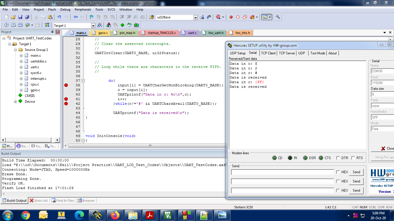

I'm working on the EK-TM4C123GXL eval board. I'm trying to send 3 bytes via UART terminal using interrupt example: $2#.
So i made a loop as following,
                    do{
                            input[i] = UARTCharGetNonBlocking(UART0_BASE);
                            c = input[i];
                            UARTprintf("Data in c: %c\n",c);
                            i++;
                      }while(c!='#' && UARTCharsAvail(UART0_BASE));
                        UARTprintf("Data is received\n");
in which once user entered "#"  control will come out of the loop and will print data received. But, in my case after entering  "#" control is coming out of the loop but, again because of interrupt, the control goes to the handler and its printing some garbage value.(below is the screenshot)
Which is not expected. What will be the reason behind this? Why even if nothing is sent via terminal still I'm getting interrupt?
Here I'm attaching my code below. Any help or hint will be really appreciated.

  • Hello Omkar,
    I tried testing your application code but it is hitting FaultISR for me at times so I am not sure what is going on exactly but a few comments:
    1) You have UARTIntClear early in your ISR and the interrupt flag is likely being set again.
    2) Using a do while in an ISR is very very poor code design, you should shift that to main and use the ISR to read data into a global buffer and then flag to main data is received and then run your loop that way.
    3) The UART terminal on your PC may be sending a CR or LF which is being registered after the #.

  • Hello Omkar,
    General practice is that an ISR should contain as minimal processing as possible. Using an ISR to receive data and then send it out with loops is not considered to be very efficient. What ends up happening is while you are in the loop in an ISR, the program cannot execute anything else that may be equally important. For a simple system with only one ISR it isn't a big deal but as you get into more complex systems, you'll find that the latency of ISR's are very important so best to learn those practices early on.
    I don't have any resources handy but I think you would be able to read up on details by researching topics like 'how to make a good interrupt service routine' or 'how to write interrupt handlers'.
