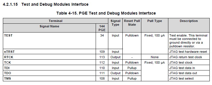

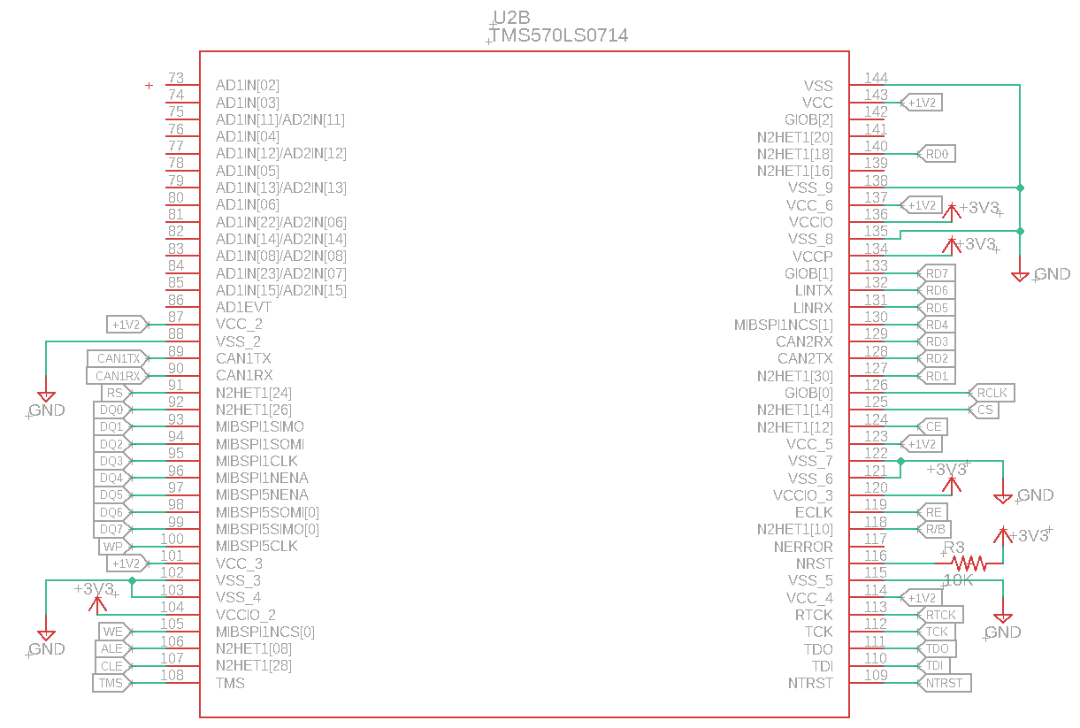

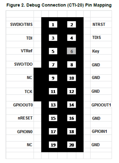

Dear, I am new on programming TI uC. I have a PCB with the uC TMS570LS0714 which schematics is shown below, and according to the datasheet table below for programming the uC, pins between 108 and 113 are connected outside to permit the programming of the uC. I am using the debugger XDS110 which has 2 connectors, the principal CTI 20 pins, and an auxiliar CTI 14 pins. I have to connect the uC pins to the CTI 20 XDS110 cable. If I did not make it wrong the connection should be:
uC pin                  XDS CTI-20 pin
TMS-108             SWDIO/TMS-1
nTRST-109          NTRST-2
TDI-110               TDI-3
TDO-111             SWO/TDO-7
TCK-112              TCK-11
RTCK-113            ?
But the last uC pin "RTCK-113" I don't know where I have to connect to the XDS110 CTI 20 cable. Can you help me?
