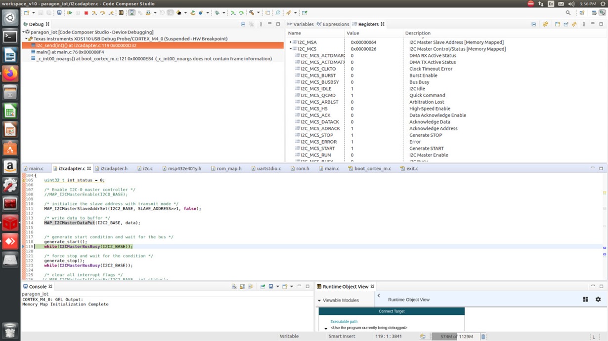

We have a sensor attached to I2C bus, and we have programmed I2CMSA register with slave address of the sensor. When we are trying to communicate to slave we are sending BURST_START command but in the registers we are getting START, ERROR, STOP and ADRACK all of them set at once while I2C_MCS_RUN remains 0, BUS_IDLE is also 1 (image attached).
Another thing is even after executing MAP_I2CMasterDataPut(I2C2_BASE, data); it is not writing data to I2CMDR register. DMA operation is also disabled.
Please let us know where we are missing.

    I am sharing the initialization and send functions for I2C0 as below, please let me know whats making the bus to go into illegal state and why I2CMDR register is not initialized with the data to be sent. The code has been taken from the examples provided in the SDK. Even we tried to execute the SDK code directly without any modification but the bus goes into illegal state immediately after sending BURST_START command.
