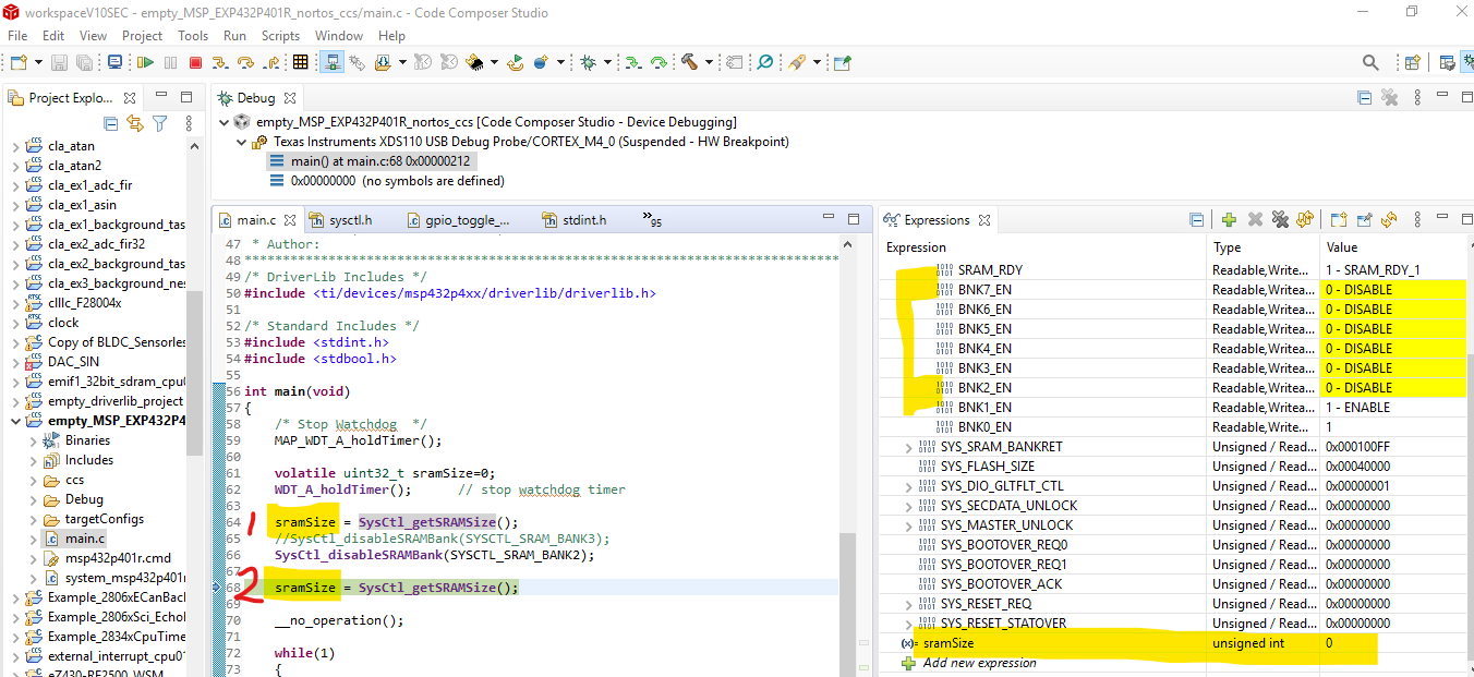

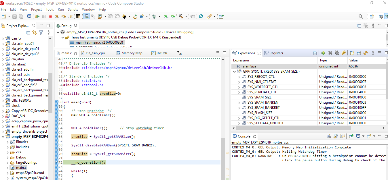

I am using MSP432P401R.
It seems that Bank 2-7 are all disabled when i use SysCtl_disableSRAMBank(SYSCTL_SRAM_BANK2);
And the sramSize  from 65535 to 0 when i use SysCtl_getSRAMSize.
Please check it. Thanks!

    volatile uint32_t sramSize=0;
    WDT_A_holdTimer();      // stop watchdog timer
    sramSize = SysCtl_getSRAMSize();
