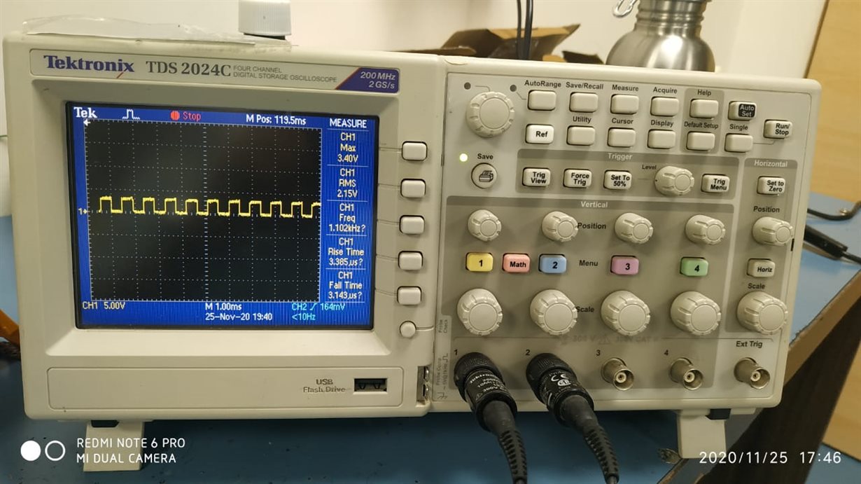

    I have tried by making changes  by like this .
    ui32SysClock = SysCtlClockFreqSet((SYSCTL_XTAL_25MHZ |
                                       SYSCTL_OSC_MAIN |
                                       SYSCTL_USE_PLL |
                                       SYSCTL_CFG_VCO_480), 120000000);
    TimerLoadSet(TIMER0_BASE, TIMER_B,ui32SysClock /1000);
    but still i am getting as 2ms for this load set. But it should get as 1ms .
    please tell me how to resolve this. please Tell me what value we have to set for 20ms in timer load set.. please help me with this.
    I am attaching the CRO output .Please tell me how to resolve this.
  • Hello Chandana,
    The o-scope doesn't seem to be well configured to me since I see the frequency comes with a ? next to it which indicates uncertainty in the measurement.
    I verified the changes again on my end and it creates a uniform 1ms / 1 kHz waveform seen by my logic state analyzer.
    For 20 ms you would use
    TimerLoadSet(TIMER0_BASE, TIMER_B,ui32SysClock /20000);
    as I reported in a prior post.
