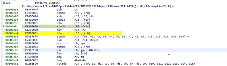

When called, the vPortPreemptiveTick function will raise an exception and jump in dabort.
The abort register tells me the abort is triggered inside the portSAVE_CONTEXT macro
dabort will not find any error and will call custom_dabort function, which is empty in my case.

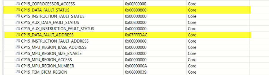

I was expecting to find MPU fault info in the CP15 register, but I got this instead:
To my understanding, this implies that write access caused a "background fault" at 0x07FFFDAC.

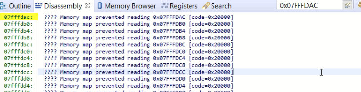

When looking at 0x07FFFDAC:

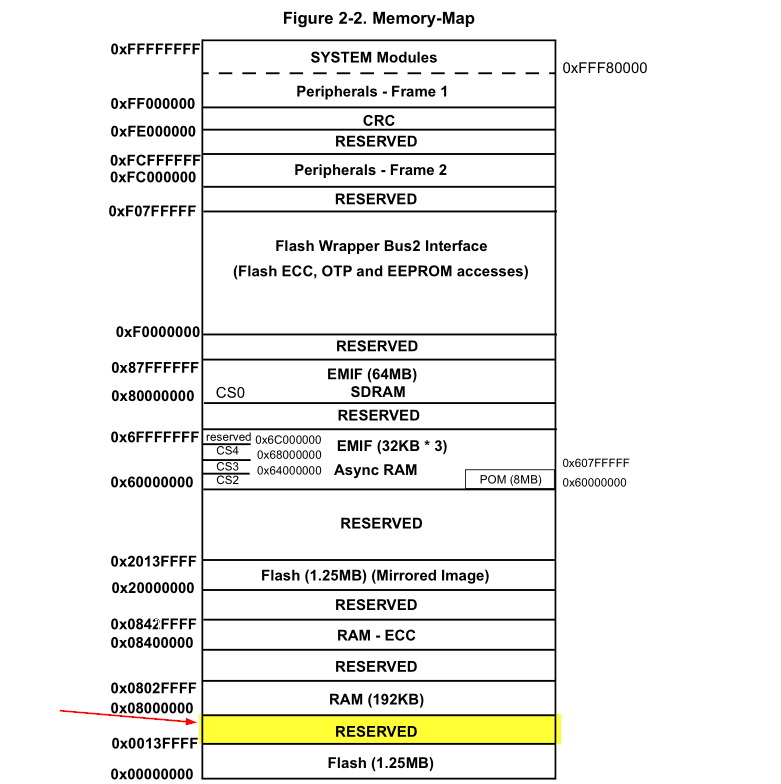

Looking at the memory map, this is a reserved address.
This memory should be empty and is weirdly close to my STACK memory section (0x08000000).

  • Hello Gabriel,
    When the MPU is enabled, an access to an undefined area of memory normally generates a background fault.
    The _dabort() is an example to handle the abort generated mainly by the selftest (RAM ECC errors, and Flash ECC error), all other error will cause the code jump _custom_dabort().
    Please trace the code execution path to find which instruction defines this address.
  • Hello Gabriel,
    A MPU background fault might indicate a stack overflow. Can you try a bigger stack size?
