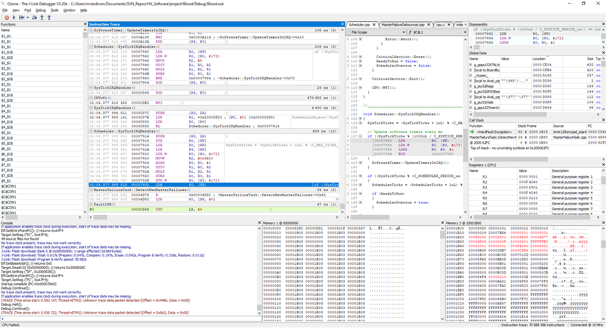

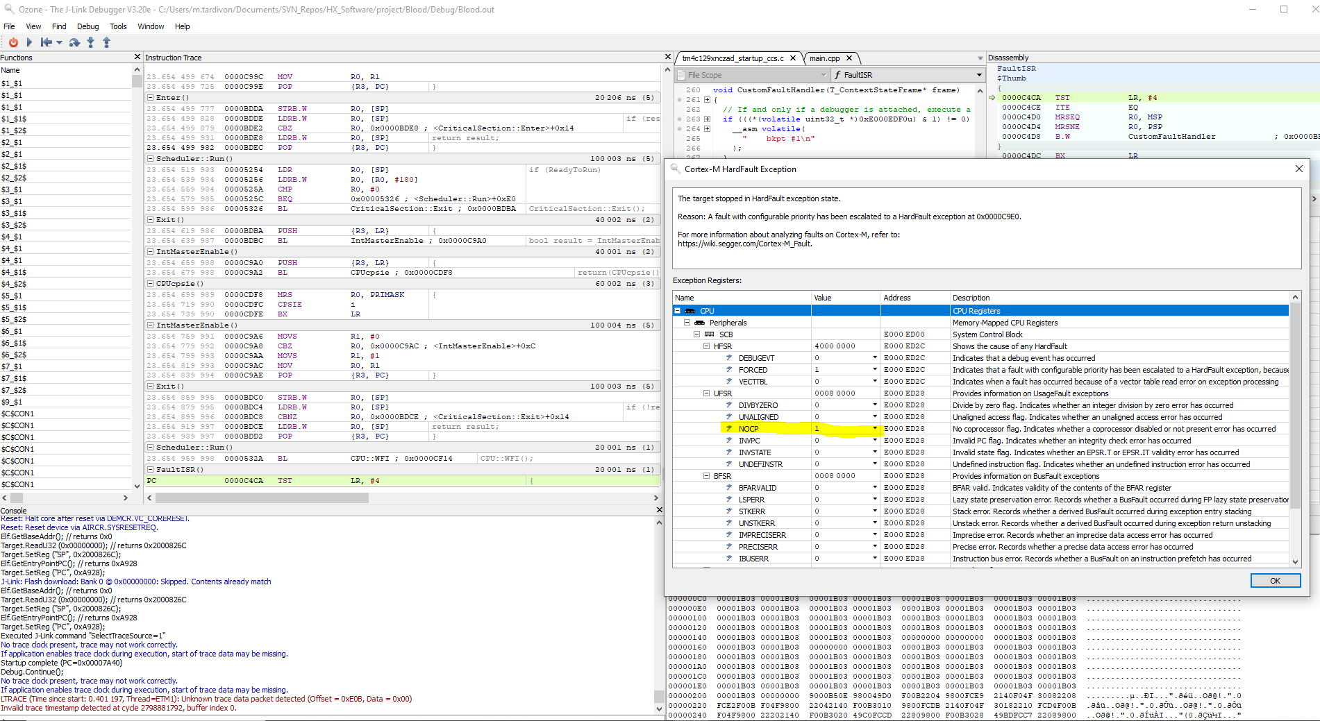

We have been struggling with a very strange hard fault which either occurs every time after a while in the same conditions or never occurs (compile output dependent).

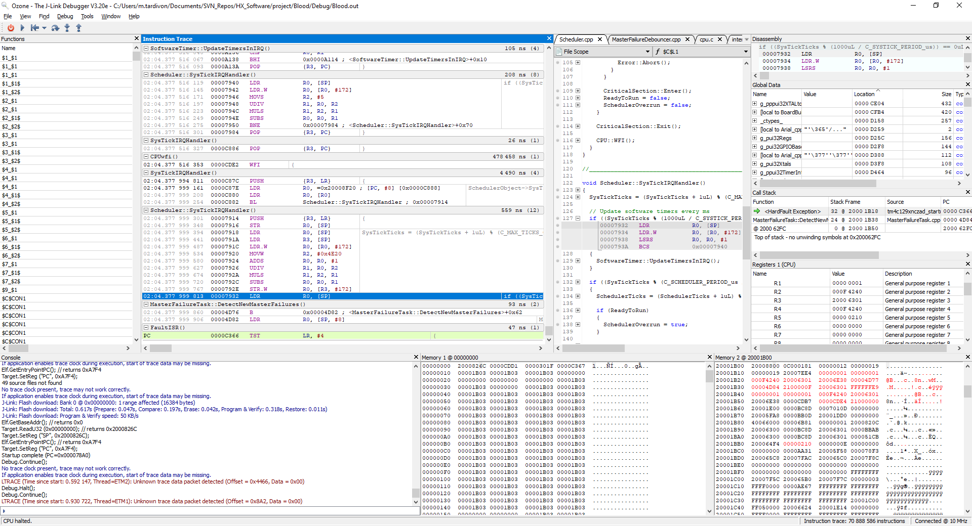

We invested in a J-Trace Pro for Cortex M and performed instruction trace and we observed the strangest behavior. At some pointer, in an interrupt handler, the PC does not simply increment after a simple register load instruction but jumps to a completely different section of the code.
Have you ever experience such a behavior ? Is there something in the errata sheet I might have missed ?
Please find below a screenshot of the instruction trace when getting in the hardfault handler:

    There is something you might not have seen on the trace but the instruction which triggers the fault is at address 0x4D84: LDR            R0, [R0, #12]. From the previous expression, I could see that R0 was equal to 1 and from the registers fault related flag that an invalid address access was attempted (to 0xD), triggering thus the fault.
    Anyway, the hardfault strict condition does not have much importance, what is important is to understand what indirectly led to this hardfault and from the instruction trace, the transition from address 0x7932 to 0x4D76 just doesn't make any sense and cannot be related to either our software or your compiler, it has to be hardware related.

    I've been looking through your screenshot provided and our Fault Diagnosis app note to try and get a better handle on this. Right now I would definitely like to understand what the FAULTSTAT register value is so I can better reference our collateral. Right now I do not see that info though it sounds like maybe you have looked into that already? If you could share details about that, it would help me.
    Couple other things...
    It looks like the function it jumps to that is in the 0x4D76/0x4D84 area is "MasterFailureTask::DetectNewMasterFailures()", is that something you have implemented? I'm not familiar with it so I'd imagine so. Is it used in the FaultISR or any other ISR handlers for TM4C?
    Also you mention the LDR            R0, [R0, #12] instruction triggers it, if so then it's still unexplained why the jump happened because the fault would then seem to be related only due to the unexplained jump (we may be on the same page here on that). Do you see any indication of PC getting loaded with a new value? Or could it be that the Fault ISR is doing that before jumping to the DetectNewMasterFailures API if that was added to the ISR?

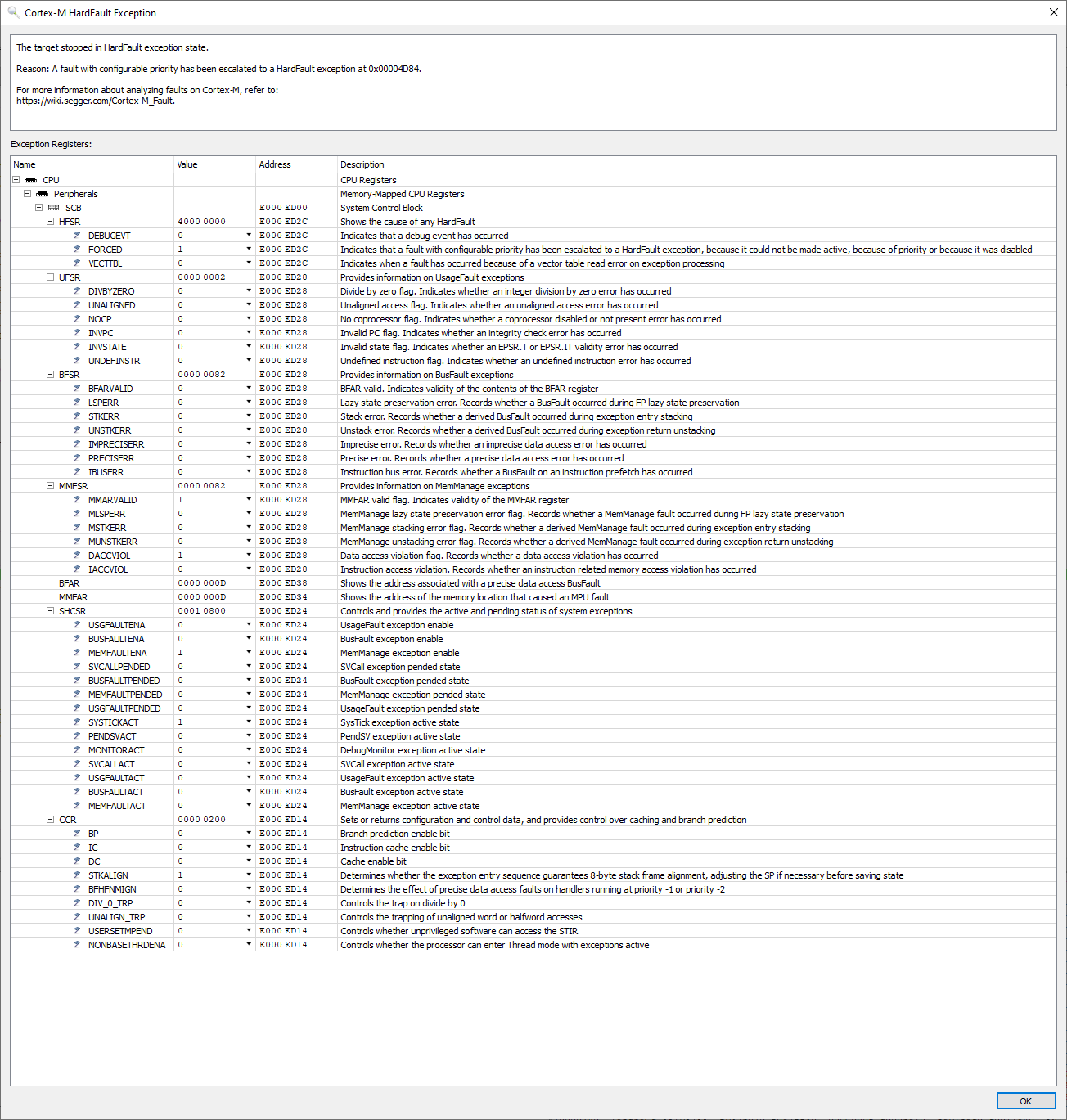

    The FAULTSTAT does not give much more information as it is consistent with the sequence of execution (invalid memory access). You can browse the different bits in the attached picture.
    Yes the MasterFailureTask::DetectNewMasterFailures() is something we implemented but it is never used in any interrupt context. In a similar way, a colleague of mine observed the same behavior but instead of the SysTickIRQHandler, the execution jumped from the USBIRQHandler to the constructor of a variable instantiated only once at the beginning of the main function.
    I don't any indication of the PC getting loaded with another value but the constant seems to be that the invalid execution jump always occurs within an interrupt context.
    We also monitored the interrupt vector, which is in RAM, but it did not change from the last interrupt register to the error occurrence.

    The Fault Status actually tells us a lot - at least from the silicon/hardware side. There are very few things which can trigger specific faults like this one.
    In this case, if a 0x82 fault for a memory access violation is almost always related to the MPU. This fault typically occurs when the MCU executes code that violates a protected memory region.

    Looking at the instruction trace in the first post the trace shows the following in the Scheduler::SysTickIRQHandler() function:
    00007932 LDR R0, [SP]
    And the next instruction in the trace is the following in the MasterFailureTask::DetectNewMasterFailures() function:
    00004D76 B 0x00004D82
    It is is this unexpected jump in the instruction trace which is the problem; since the Program Counter changes from an IRQ handler in the middle of a different function.
    The fact that the LDR R0, [R0, #12] instruction at address 0x4D84 generates an address fault is just a side effect of the preceding Program Counter jump.

    To detail a little bit more the fault to Ralph:
    LDR R0, [SP] -> R0 is loaded with value 0x1
    LDR R0, [R0, #12] -> An attempt is made to load R0 with the value at address R0 + 12 = 0xD, which is an unaligned memory access but as Chester stated, it is a side effect of the unexpected jump.

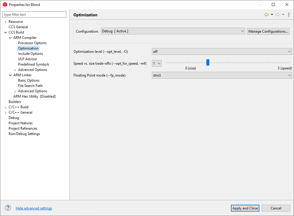

    Curious have you tried to set CCS compiler register optimizations 0 and reduce application speed/size setting? We had random odd jumps to various invalid imprecise addresses when enabling inner procedure optimizations with Tm4C1294 MCU. Global optimizations caused odd problems too as I recall and local optimizations did not seem to cause any issues.
  • Hi ,
    In our case, compiler optimizations are off (default) .

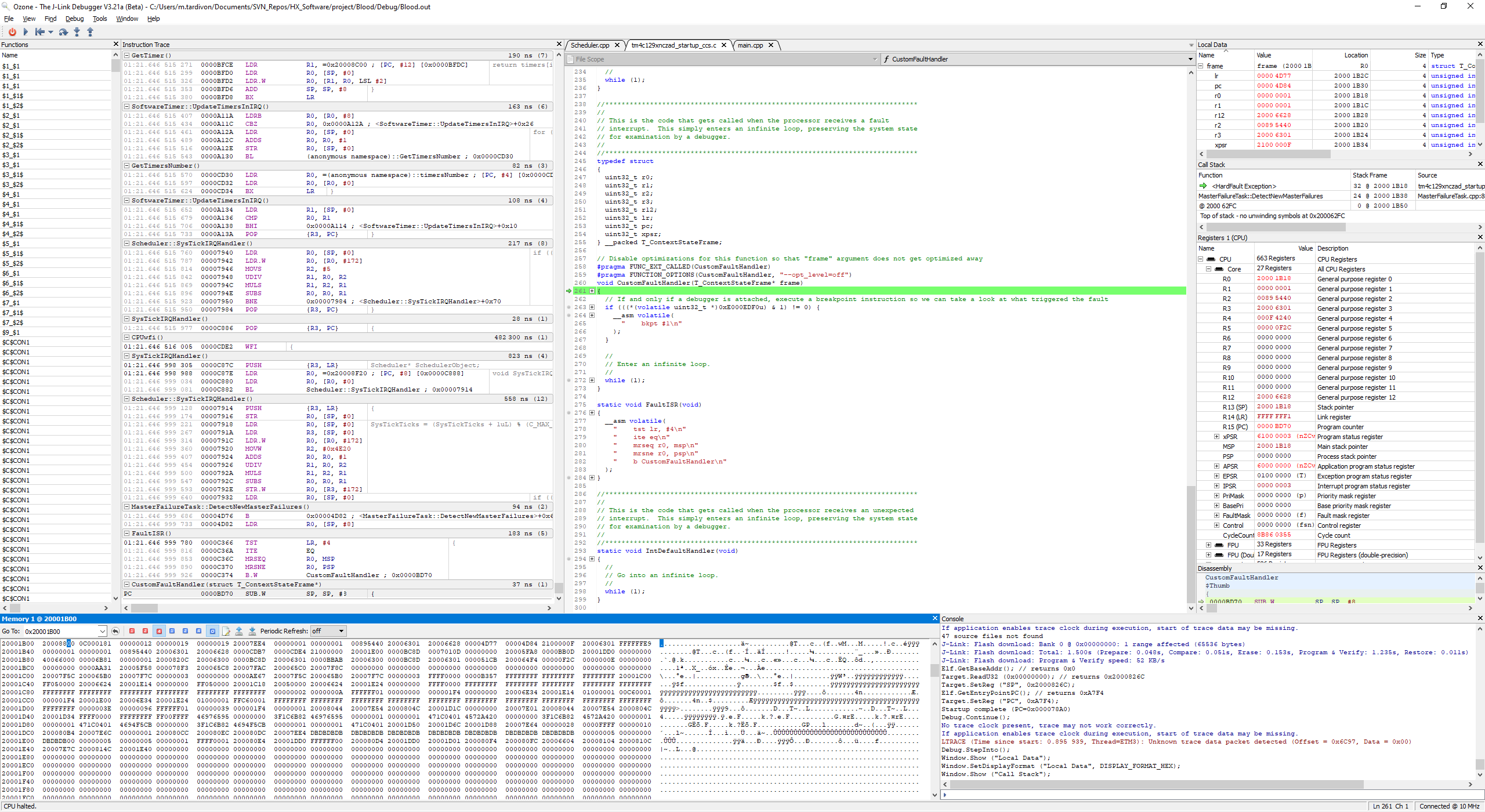

  • While attempting to test other features of our software, we now observe a new kind of fault, NOCP ! Could this be related?

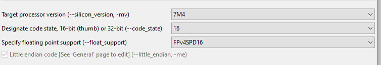

    Our compiler has the option --float_support=FPv4SPD16
  • Hello Matthieu,
    It might. A NOCP usage fault can be generated if a floating-point instruction is executed when the floating-point unit is disabled, and the previous code which had an issue may involve floating point calculations too. Can you check if the FPU is enabled for that project? That would be a compiler setting usually. Look under Build -> Arm Compiler -> Processor Options and then see what Floating Point Support is enabled.
    That all said, I'd be a bit surprised to see that was disabled.
    Can you show what the instructions are after address 0x00007932? It doesn't look like the trace was able to catch all of the instructions executed. One of our other experts has a suspicion that the link register was modified (corrupted) and a ret (POP {R3, PC}) caused a fault routine to execute, which then caused a hardware fault.

    Perhaps even go as far to set relaxed floating point to rule out possible FPU crashes due to odd decimal point placement errors.
  • Hello Ralph,
    As I said, the option is --float_support=FPv4SPD16
    Here are the instructions after address 0x7932:
    The SP address I gave you was my own analysis, perhaps it is wrong, it was impossible to put a breakpoint at this precise moment as the SysTick interrupt is periodic.

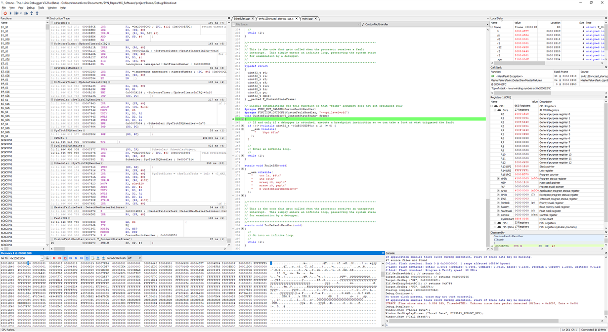

    Here is a new screenshot with more information, you have all the RAM around SP and in our custom hard fault handler, we store the stacked frame (top right corner), you can see that LR=0x4D77 and you can also see all registers R0-R15. Howerever, if you take a look at the trace instruction timings, I doubt that it missed any instruction.
    Note to myself: This is software revision 3563 with trace pins configured at GPIO_STRENGTH_12MA.

    From what we are seeing, it looks like there is an unaligned 32-bit write to location 0x200063AD (R3 + #172) with the STR.W instruction at address 0x792E. This is normally allowed, but not if the “UNALIGNED” bit of the Configuration and Control register (bit 3 of address 0xE000ED14) is set.
    Can you check what the value of the Configuration and Control register is at the time of the fault?
    Another quick check just for sanity purposes... the FPU option is set in the compiler so it should be good in the code too but can you crosscheck the value for the CPAC register to see if the FPU for some reason got disabled?
  • Hello Ralph,
    UNALIGNED bit is not set and FPU is still enabled for full access at the time of the fault.

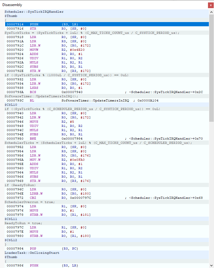

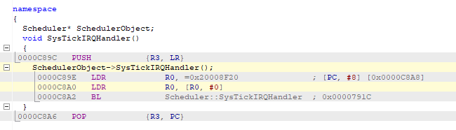

    What is the complete disassembly of the SysTickIRQHandler()?

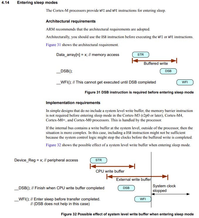

    There are two consecutive POP – separated by 26ns. That is unusual to see. Where are these two POP corresponding to in the SysTickIRQHandler?
    Also, looking at the timestamps, there are two PUSH instructions separated by 4490ns but only four instructions apart as shown in the trace (0xC87C to 0x7914). That makes us feel that some instructions are not being traced out fully.
    Check if there is a way to increase the trace buffer on the J-Trace and maybe that can provide a better picture.
    Lastly, can you also try to disable nested interrupts as an experiment to see what behavior occurs?
    The Ozone screen capture shows a WFI instruction traced approx 1300 ns before the trace shows the suspect jump.

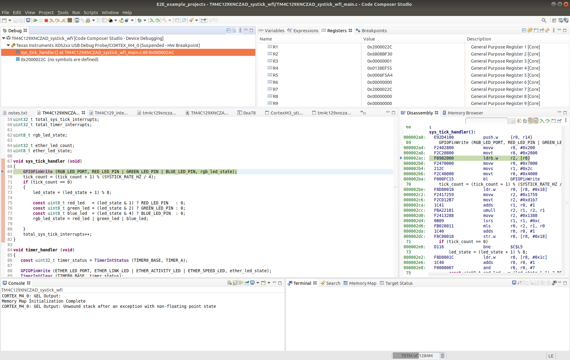

    While looking into cortex-M ETM trace, I found the QTRACE - USER MANUAL contains the following recommendation:
    Avoid using functions that execute WFE/WFI sleep instructions as this will cause trace output to be suspended and will lead to erratic tracing behaviour. It is recommended to comment out WFE/WFI instructions for builds to be used for tracing. The QTrace Analyser will detect if these instructions are being used and will highlight their location(s).
    If there is no associated source for the WFE/WFI instruction e.g. it is located in a library file, then the WFE/WFI instruction will need to be patched with a NOP instruction. See Appendix C NoSleep Utility for details of the NoSleep utility that can patch WFE/WFI instructions.
    While this recommendation is not from the Segger J-Trace Pro for Cortex M documentation, it might be worth trying to remove the WFI to see if the trace capture then contains more instructions around the failure.

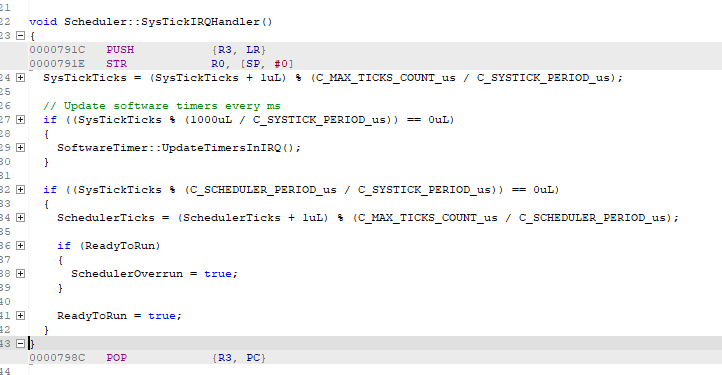

    Regarding your push/pop remark, it corresponds to the following code below. Two functions are imbricated, hence the two push/pop pairs. We had to implement a wrapper in order to use the IntRegister functions from TivaWare as you need to pass a function pointer but to execute a non static method in C++, you also require the object. Though the timing seems odd from J-Trace, I am not sure that it means we lost any instruction in the trace, it might be linked to the WFI instruction as stated Chester.

    Here is the full disassembly of the SysTick function (without the wrapper):
    I also provide you with the .out with full symbols so that you can also browse disassembly if you want. (Had to put it in .7z format)https://e2e.ti.com/cfs-file/__key/communityserver-discussions-components-files/908/Blood.7z
    We use IntRegister because it is easier to implement generic drivers but our scheduler is very simple and nothing like an RTOS so this thread does not apply to us.

  • I also tested Chester idea and removed the WFI instruction and our program ran all night without any fault. So, I did some digging in the datasheet and I came across this section and especially the "Caution" paragraph.
    I think this could be related to the observed issue. What do you think about it?
    I also checked our clock gating and we set the RCGC registers using SysCtlPeripheralEnable function and we never enable the auto clock gating so the peripherals are supposed to be clocked, even during the WFI instruction. Therefore I don't understand why this would trigger a hardfault. However we did start to observe the issue when we implemented more hardware related features and added some floating point calculation in the interrupt so this seems to be definitely related to our issue.
    I also performed a test where I put back the WFI instruction but also set the SCGC registers using the SysCtlPeripheralSleepEnable function and enabled the auto clock gating using SysCtlPeripheralClockGating function. This software has also been running for hours without any fault.
    If you think this is related to our issue, could you provide us with detailed information of what physically happens within the microcontroller in these different cases in order to help us have a better understanding of the issue?

    I think this could be getting us down the right path, but it is strange to me that if you have the RCGC registers set, that you would have that issue.
    Honestly we aren't quite sure why that combination of settings and conditions would cause a fault.
    One thought we had, is the DMA being used at all? The idea being in that case that DMA tries to access the memory subsystem while the device is in sleep mode.
    Do you think you could figure out which of the two caused an issue more between floating point and hardware features?
    The NOCP error sticks out to me for the FPU... but there shouldn't be a reason the FPU needs a delay after the WFI to work. At least not to our understanding of how a Cortex-M4F is architected.

    Searching the forum for "WFI" found the old Random Hard Faults on Wakeup from WFI Instruction (LM3S6918 Running at 50 MHz), which while is for an obsolete Stellaris device rather than a TM4C129 the failure mode seems to match. In that referenced thread there was an errata in some Stellaris devices where the flash controller could sometimes feed garbage instructions to the processor after wake up. Will attempt to create to create a program for a TM4C129 which spends most time in sleep (using a WFI), just waking up with a timer interrupt at a high rate, to see if can create a failure.
    Thank you both for your feedback.
    To answer Ralph's question, we do use DMA for UART sending but I doubt that this might be linked to our issue as it would more probably cause a data corruption in the transfer similarly to the errata sheet case in deep-sleep mode rather than a hard fault. I unfortunately don't think that I will be able to determine which of the two caused an issue more between floating point and hardware features, it is very hard to say. But indeed the FPU and the WFI are only ARM related and there are no known bugs about such issue so this is quite weird.
    To answer Chester question, we almost always have a debugger attached and our software does not enable explicitly the DAP (unless hidden in TivaWare but I doubt it). One of my colleague said that he observed a freeze without a debugger attached and after a power cycle and thought it was linked to the same issue but it is quite hard to know as we can't have the trace at that moment.
    Nonetheless, I really believe that we are close to something as both following solutions seem to fix the issue:
    - Removing the WFI instruction
    - Keeping the WFI instruction and use SCGC clock gating and auto clock gating
    So the issue definitely seems related to MCU sleep mode. We need know to understand exactly the source of the problem in order to be sure that one of these solutions is the correct workaround and does not just hide temporarily the issue.
    Thank you again for your support !

    The hard fault has only been seen to occur when the debugger is attached (a XDS200), running under CCS 10.1.1.
    1. If start a debug session under CCS then within 12 seconds of running enters a hard fault. Example of where the hard fault occurred (using the GEL script from CCS/TM4C1294KCPDT: How do I get the stack unwound in exception handlers? to unwind the stack after the hard fault):
    When the hard fault occurs the offending instruction is always at address 0x2AC. When that instruction is executed R8 should have the constant value of 0x20000200, but the register R8 has the value 0x0 at the time of hard fault. The NVIC_FAULT_STAT register is 0x00008200, which has the NVIC_FAULT_STAT_BFARV  (Bus Fault Address Register Valid) and NVIC_FAULT_STAT_PRECISE (Precise Data Bus Error) bits set. The NVIC_FAULT_ADDR register is 0x0138EEA5, but from the disassembly and register dump there was no instruction which appeared to be accessing address 0x0138EEA5.
    Also, the tests sweep the period of the timer0 though a range of values, and when the hard fault occurs the timer_period is normally 5925, but one saw the value of 5923 when the hard fault occurred.
    2. If the target is powered-cycled, leaving the XDS200 connected but not running a debug session, then the test continues to run. Left for one hour or four hours on two runs. With the target running attached the debugger and then resumed running. Within several seconds the hard fault occurred.
    This points at some interaction with the use of wfi to place the processor in sleep when the DAP is enabled due to the debug session being attached.
    I haven't yet tried changing things to see what makes the problem go away when the DAP is enabled.
    The TM4C129XNCZAD used had the DID0 value of 0x100A0002 which means Part Revision 3.
    TM4C129XNCZAD_systick_wfi.zip
    I tried using a Segger J-Link instead of a XDS200 and the same hard fault occurred when a debug session was active. Also, the test with the XDS200 was CCS 10.1.1 under Linux, and the the test with the Segger J-Link was with CCS 10.1.1 under Windows 10.
    Found the following sequence is repeatable:
    1. Start a debugging session. With the program halted at main, in the Registers view set the FLASH_CONF_FPFOFF bit in the FLASH_CONF register. This forces the flash prefetch buffer off.
    2. Run the program, with the DAP enabled, which runs without error.
    3. Pause the program, and in the Register view clear the FLASH_CONF_FPFOFF bit. Upon resuming the program then get the same hard fault in the sys_tick_handler as when run the program without changing the FLASH_CONF_FPFOFF bit.
    Not sure if either:
    • Forcing off the flash prefetch buffer, which will slow down code execution from flash at the 120 MHz CPU clock used, changes the timing which masks the cause of the hard fault.
    • It is having the flash prefetch buffer enabled which causes the hard fault when the processor wakes up from sleep following a wfi. The flash prefetch buffer could be providing incorrect instructions.
  • Hello Chester,
    Thank you very much for your feedback. I also performed a test on my side and took the project you provided. I had to modify it just a little to use other GPIOs but it did trigger a hardfault on our target as well.
    Then, I configured and enabled the trace pins and the program would not crash anymore....
    After that I added a float multiplication at the beginning of one of your interrupt and a float division at the beginning of the other and .... drum roll .... I had a hardfault with NOCP bit set ! So this seems definitely related to our issue and what we observed. The stack frame in the hard fault context does correspond to a float operation.
    Matthieu

    After digging further into the project properties, I saw that Chester had optimizations cranked to max speed. Once I applied the same level of optimizations to the LaunchPad project, then it immediately began to fail and it failed for both the XDS200 AND the ICDI now.
    This is where it got even stranger though. We had seen that if the XDS200 was disconnected or removed, that the issue would occur and that repeated on the LaunchPad. But when the ICDI was disconnected, the code ran perfectly again. In both cases, I was resetting the boards with the Reset button on the board. Then with the LaunchPad after programming with the XDS200 again, disconnecting it, resetting, and getting the failures... I power cycled the board by pulling the USB cable and the code worked fine with the power cycle.

    A search found the TI application note for the Cortex-M MSP432 Proper Sleep and Interrupt Use on the SimpleLink™ MSP432™ ARM® Cortex® -M4 Microcontrollers which describes the need to use a Data Synchronization Barrier (DSB) instruction to flush the data memory transfer pipeline prior to going to sleep to avoid unexpected behaviour.
    And ARM Application Note 321 ARM Cortex-M Programming Guide to Memory Barrier Instructions contains the following in section 3.3 Architectural Requirements:
    Sleep
    It is not a requirement for the processor hardware to drain any pending memory activity before suspending execution to enter a sleep mode. Therefore, software has to handle this by adding barrier instructions if the sleep mode used could affect data transfer. A DSB should be used to ensure that there are no outstanding memory transactions prior to executing the WFI or WFE instruction.
    Based upon that loop my example for the EK-TM4C129EXL was changed to add a dsb prior to the wfi instruction:

    This is interesting news. I was about to write in this thread as I distributed the fix to our SW team and unfortunately, two of my colleagues has the hard fault occurring and our analysis show that they were related to the same issue. Therefore the WFI instruction 32 bits alignment does not seem to be sufficient to fix the issue.
    I have also came across this post:
    https://stackoverflow.com/questions/47022456/why-is-an-isb-needed-after-wfi-in-cortex-m-freertos
    I also found the following recommendation:
    "A DSB should be used to ensure that there are no outstanding memory transactions prior to executing the WFI or WFE instruction. "
    and many explanations which can be found in "Application Note 321 ARM Cortex-M Programming Guide to Memory Barrier Instructions"
    Most of our team is going on vacation today but we will perform new tests as soon as possible beginning of next year.
    Best regards and merry christmas,
    Matthieu Tardivon

    I am not sure the Write Buffer piece is what the DSB is really impacting here. It could be instead that it is influencing the behavior of the prefetch buffers which is involved as part of the root cause for this issue along with the DAP and WFI.
    What I find more interesting from the app note is also the use of the SCB_SCR_SLEEPONEXIT_Msk and SCB_SCR_SLEEPDEEP_Msk.
    For TM4C the equivalents are:
    // The following are defines for the bit fields in the NVIC_SYS_CTRL register.
    #define NVIC_SYS_CTRL_SEVONPEND 0x00000010  // Wake Up on Pending
    #define NVIC_SYS_CTRL_SLEEPDEEP 0x00000004  // Deep Sleep Enable
    #define NVIC_SYS_CTRL_SLEEPEXIT 0x00000002  // Sleep on ISR Exit
    These are also detailed in Register 59: System Control (SYSCTRL), offset 0xD10 of the datasheet.
    However when I tried using these, I had even worse performance... so I am not sure why recommendation would work for MSP432 so much better. Especially if the app note is written with MSP432E4 in mind.
    Matthieu,
    No problem about the holiday break, I am out all next week as well and working in a more limited capacity the week after. I think picking this up at the start of the year will be best for all.
    I'd be curious to know both how the DSB impacts your system as well as following the MSP432 guidelines closely. Presumably that app note is written with the MSP432E4 in mind too which uses the same architecture as TM4C so I would replicate the commands for TM4C exactly as ordered and see what occurs. That said, based on my own results... my expectation is that it will not have an impact to solve the issue. TM4C equivalent code below:
            HWREG(NVIC_SYS_CTRL) |= NVIC_SYS_CTRL_SLEEPDEEP; // Set SLEEPDEEP
            HWREG(NVIC_SYS_CTRL) |= NVIC_SYS_CTRL_SLEEPEXIT; // Set SLEEPONEXIT
            asm (" dsb"); // Ensures SLEEPONEXIT is set immediately before sleep
            asm (" wfi");
    For the systems which have the issue, have your engineers tried disabling the prefetch buffers as a solution? Obviously we want a better solution than that but it would be a good data point to know if that solves the issue across all systems for you.
