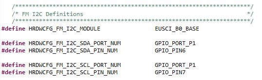

I am working with C:\ti\Connectivity\CC256X BT\CC256x MSP432 Bluetopia SDK\v4.2.1.1\Samples\A3DPDemo_SRC  sample project which has I2C communication with TI TLV320AIC3254 CODEC for the Audio Boost example.  I am trying to reuse the initialization of the I2C of this project in our own development board along with its communication interface.
I2C Slave Address:  0x22
Port Pins:  P1.6 & P1.7
#define HRDWCFG_FM_I2C_MODULE                EUSCI_B0_BASE

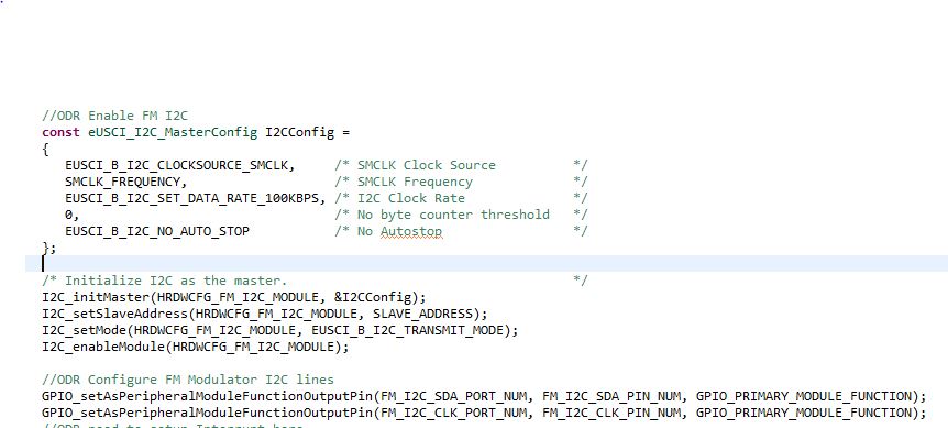

The original code does not use Interrupts:
So I have not set anything up.  Its all polled.

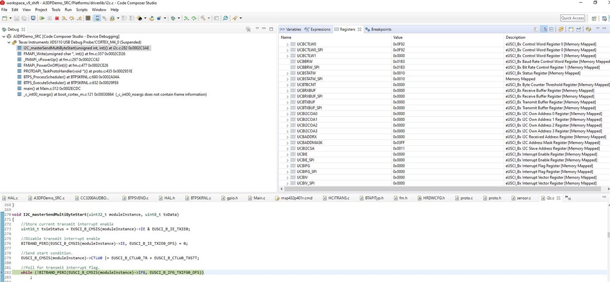

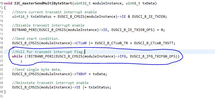

Upon trying to send the first bytes over to our FM Modulator we do not see any movement when the Start Condition is sent.
Instead the code hangs while waiting for the transmit Interrupt Flag to be set:
It is obvious that the code has not set up the I2C peripheral correctly.  What am I missing?
Is the I2C peripheral pins from p1.6 & P1.7 tied to EUSCI_B0_BASE or another register  base EUSCI_Bx_BASE???  The technical reference manual does not specify this clearly.

  • Here are my code snippets:
    The code hangs when it tries to send out the Start condition because the interrupt flag is never asserted.
    It seems like the I2C is not even configured correctly .

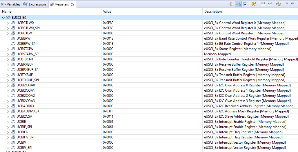

    Can you share the contents of the EUSCI_B0 registers when the SW is stuck in that while loop? It might give some indication of what the problem might be.
    Srinivas
  • Hi Ozzy,
    This is configured for SMCLK as the clock source into the module. It is behaving as if it is not getting any clock into the I2C module. What is the SMCLK source in the system?
    Srinivas

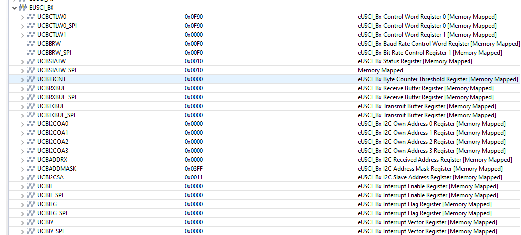

  • Srinivas,
    What is the fastest SMCLK speed that the I2C peripheral can handle?
    I was able to get the I2C start condition and clock to work on my dev board with a sample I2C program that Eddie LaCost sent me.  So at least we know our board doesnt have an issue but still DOES NOT WORK with A3DP_SOURCE project that I am using.
    https://dev.ti.com/tirex/explore/node?node=APM0UhLm.w5dW6iy1nJJ-g__z-lQYNj__LATEST&search=MSP432P401
    Here are the register dumps of  both versions of code:
    This is the sample code:
    This is our Product Code:
    See if you can see something obvious.
