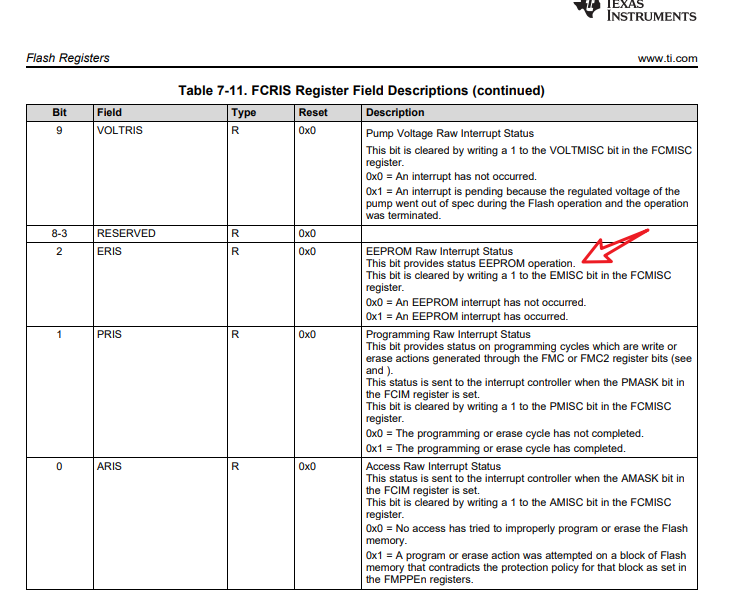

  • Hi Koki,
    An Interrupt will be generated default when reading EEPROM, as shown in the following figure: (in the FCRIS register, the corresponding data: 0x04).

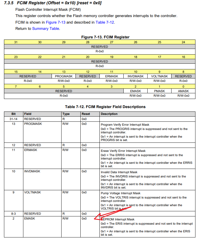

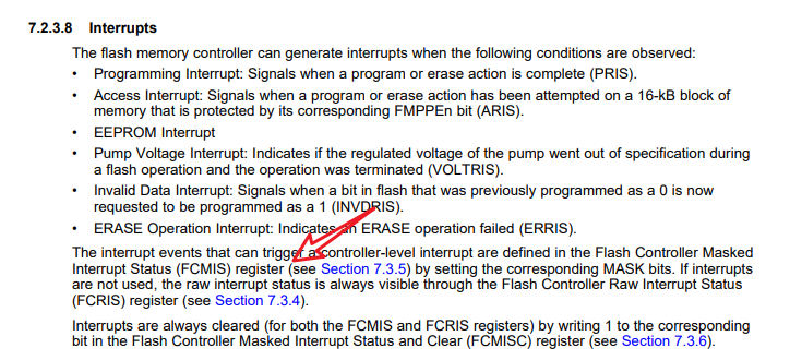

    An this interrupt can be masked, as described in the following figure:
    You can find the register operation bit that masks this interrupt in the FCMIS register, as shown in the figure below (BIT2):
    Thanks!

  • Hi Koki?
    What's your means?
    You should operate EMASK bit if you would like to disable interrupt when you read EEPROM data.
