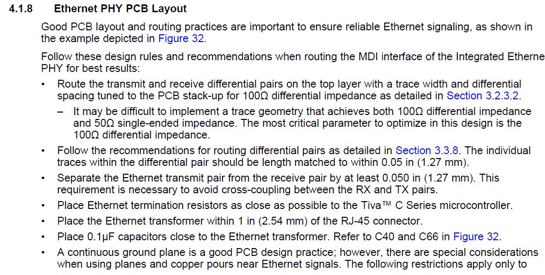

I have followed the TI guidelines on the Ethernet connection with the exception that the pairs are also used for power supply and some very slow digital signals, for the purposes of this testing none of these signals are switching and are held to one supply rail or the other. The result of this is that the signal path between the TM4C and the industrial controller effectively has 3 sets of magnetics instead of the usual two. One on the board with the TM4C as per TI recommendations, one in the middle where power and signals are injected, and one in the industrial controller. I am aware the extra set of magnetics is introducing losses into the system however the cable run is pretty short (<5m), it is my understanding that this is more or less how some of the cheap passive POE injectors work.

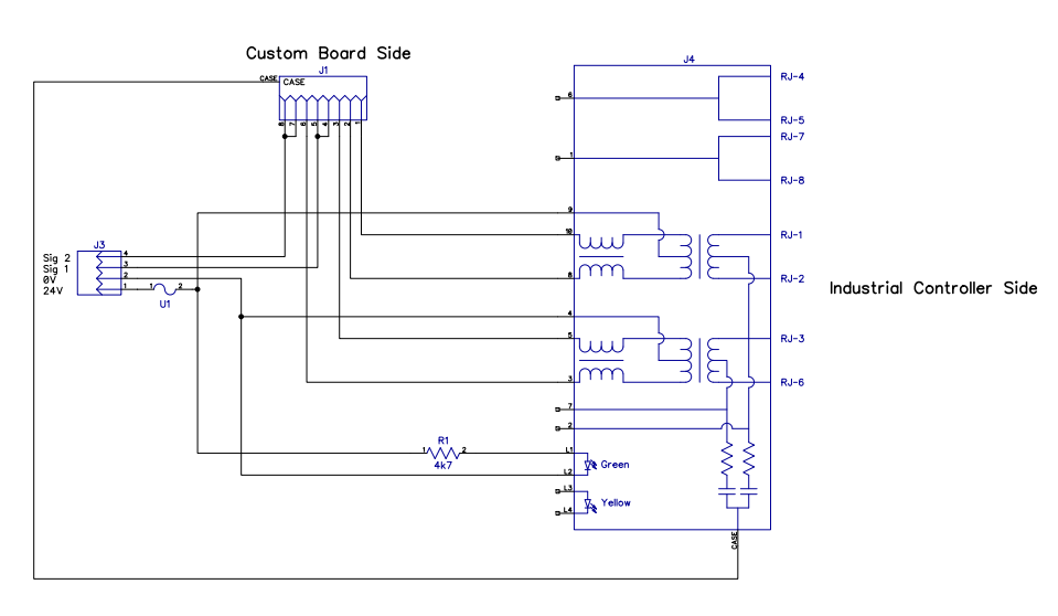

I have included the relevant section of schematic for our mainboard, as well as the schematic for the injector board.

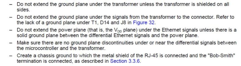

    My board layout is below, I think I have followed the recommendations, the only thing I can think of is that the jack is running back over the traces (my application is space constrained and I don't have any room outside the board outline.

    In terms of my layout vs the guidelines I have applied them as best as I could interpret for the jack with integrated magnetics, I used saturn PCB to get the trace sizing worked out for my stack up. I am least sure about the ground plane and spacing between the jack and micro.
    From what I understood of the ground plane for the jack I was just meant to keep the plane away from the pins see the small keepout in my previous screenshot, as for the spacing, they are pretty close and it's hard to tell what bits of the design guide to follow as some bits seem to contradict, for example in words it indicates discreet magnetics should be no more than 2.54mm from the jack, and yet the example layout is Mabey 5mm because of the ESD protection.

    Your trace layout looks acceptable though next time perhaps try to keep differential pairs the same length, adding zigzags to the shorter pair works best. My custom PCB was two sided and roughly 4 via existed in each pair but the trace length was kept the same. Non the less it makes a DCHP assignment in milliseconds. BTW did you assign a MAC address to the USER registers? That can easily be overlooked and cause some really strange things to happen.

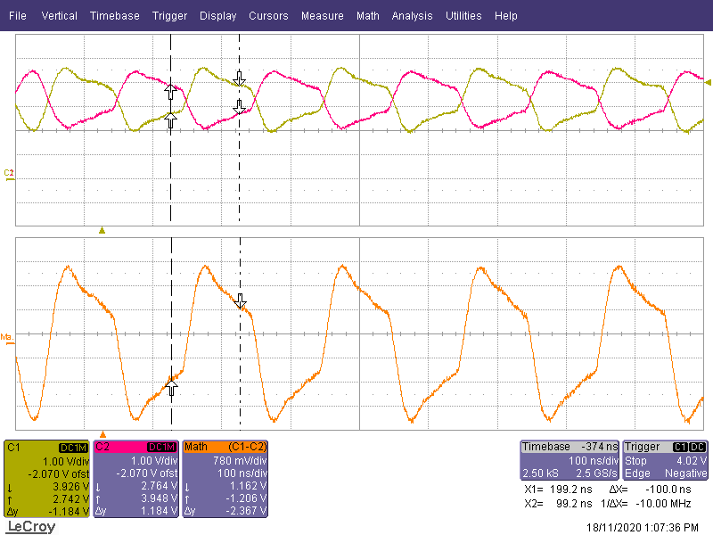

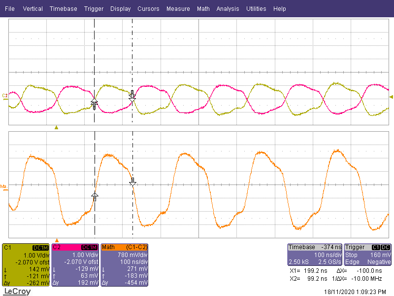

    I have had a probe of the Ethernet signals but would require a more experienced eye to look over them, to give myself the best chance of finding something with the scope we have (only 200MHz bandwidth and no differential probes) I have used forced 10Mbs mode and recorded both the Launchpad and our board to be able to compare.
    To me they don't look to dissimilar however I don't really know what I am looking at not having probed Ethernet signals before. I was surprised to see such a large difference between the TD & RD Pairs but it appears on both the launchpad where things work as well as on our custom board so I am guessing it is just the TM4C PHY.

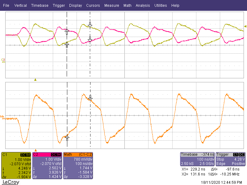

    I should add to further isolate things the below data is captured while running the enet_lwip example on both boards, running the example see the same symptoms as running my code, slow link establishment, but if connects seems to stay connected.
    In the below plots the + signal is in yellow and - in red.
    Launchpad TD Pair Network Side
    Launchpad TD Pair PHY Side
    Custom Board TD Pair at PHY Side
    (Accidentally at a different time scale to the rest of these plots sorry)
    Launchpad RD Pair At Network Side
    L
    aunchpad RD Pair At PHY Side
    Custom Board RD Pair At PHY Side

  • My scope capture was done with the probe grounds attached to my system 0v plane and then one probe on + and one on -, I did it this way as we don't currently have a differential probe. In some fortuitous timing we are actually about to get a loaner 4 channel portable scope (with isolated channels) with a higher bandwidth as part of a trial. In terms of probing the circuit without disturbing the signal (noting the trace layout requirements) would you have any recommendations on where and how I should attach the scope to do this test.
    Currently out of the office and will have a dig through the library when I get back but when using a static IP does one need to handle the checks any differently.
  • As per recommendation I have swapped the chip off one of my boards to the launchpad, and the launchpad chip to the board. And now the launchpad has the issue of being slow to obtain the link, although it is getting the link more reliably than on my own board. Likewise the custom board, is back to establishing a link in 2-3 seconds.
    Potentially this shows that something on our custom board is damaging the internal PHY.

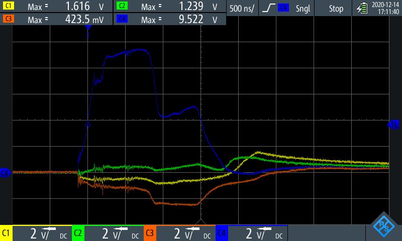

    I did try recapturing some more data after this on what the TD pair is doing on the custom board (measured between the magnetics and TM4C) and I still have the higher than expected voltages.
    I got a capture that represents the start of a packet where we can see both lines start at 3.3V, as well as in the middle of the packet and it looks like the average voltage is slowly rising through the packet.
    If it is real that the voltages are reaching these levels and not just some kind of probing artifact, I guess it would make sense that it is damaging the chip, I cant see anything specific to the ethernet pins but all the IO pins are rated to 3.3V, and I believe have 0.3V ESD protection diodes. On reflection I don't really see that the ESD protection (TPD4E1B06) recommended by TI in the design guide (spma056) would actually be doing anything as its limit is way higher than what is built in, with current starting to flow above 7V. I note that in one of TI's POE designs(TIDUBR9) they use the same ESD protection (SLVU2.8-4) as used on the launchpad, except they have it inserted between the PHY and magnetics, not between the magnetics and connector as on the launchpad, this part doesn't limit voltage with respect to GND but will limit start limiting the differential at 4V.

      1. According to the datasheet the VTPTD_100 is a nominal 1V and max of 1.05V. Your capture does seem too high. If I read it right, it is approaching 2V on the + signal.
      2. Can you explain what are the connections for pin 7,6,2,1 in your schematic? I believe below is the schematic for your RJ45.

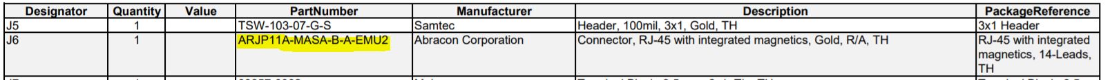

    3. Looking at the choice of your RJ45 connector, it is without EMI finger. I don't really know what it is implying. Just wanted to bring it up for brainstorming. Is it more susceptible to EMI? I don't really know.
      4. Your PCB board might have followed the recommendation, Just wanted to know if it is the case as I don't really have a good idea on what caused your slow/no link issue.

  • 1) To give my scope the best chance of probing the high speed signals I have been using 10BASE-T for these tests as the issue still occurs even at these lower speeds. I believe 10BASE-T has a higher voltage swing
    2) I am using these pins for POE and transmitting two digital signals, similar to the below example I found, to isolate things though I am have disconnected the center taps and am powering my board directly.
    3) I believe the EMI fingers are just little metal tabs that contact the side of the plug when you plug it in so that if you have one of the fancy Ethernet cables with metal in on the sides of the plug they end up connected to the shell of the Ethernet socket.
    4) I am not 100% sure on how to apply some of those as they seem more focused on when using discrete magnetics, on reading through I don't think I have connected the chassis of the plug per the recommendation. I might try to bodge something up to test with a different connection of the metal shell of the plug. I do note though that in most consumer devices, e.g. desktop pcs/laptops etc, 0V is tied to the case which by extension is connected to the shell of the RJ45 connector.
    Hi Hugh,
    Hey does the AUX power connect to +24v on either side? If so that could be why the differential pair are rising above safe MAX level if the magnetics on custom PCB are not specifically designed for a PPOE powered Ethernet connection. D6 on your first post schematic shows +24v, is that your custom PCB or the injector, assuming that is the injector?
    Just for kickers what do the PHY voltages look like when custom PCB Ethernet is connect to launch pad via cross over cable without AUX +24v, if it was powered. BTW bravo for getting the LQFP128 package lifted off the launch pad without destroying pads, large ground plane under MCU really makes removal difficult.
  • The design intent was that I am using the two data pairs for transmitting 24V power from the injector board to my custom board, you can see this is brought out through the rectifier D6 in my schematic, the connector J6 usually is just hooked up to some buttons, however I have been using it while debugging to supply power to the board, and connecting the Ethernet direct to our Ethernet switch (instead of via the injection board).
    I think I am within the rating of the magnetics, my board draws <100 mA and the magnetics are rated to 350mA

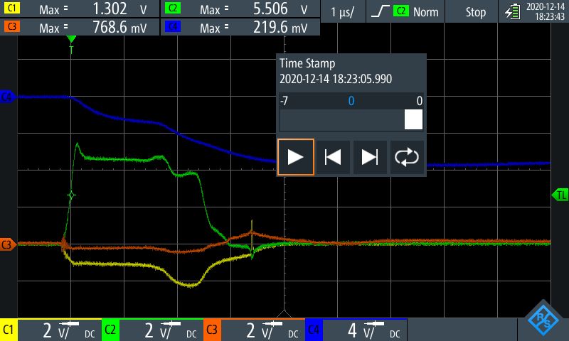

  • I did some more probing today with a new scope we have on loan as a trial, unfortunately I messed up some of the data recording not being 100% used to the interface for saving data.
    What I did manage to capture a broad view of was a complete packet (in 10BASE-T) mode.
    Key things I notice is that the two lines seem to drift up by 0.8V over the first 2us or so, notably the differential voltage doesn't change much but I would have expected the peak voltages of 5V are beyond what the pins on the micro can deal with.

    J6 +24 and D6 +24 share a common trace? Feeding J6 dc supply +5vdc when connected to network versus +24v? Perhaps 10k pull downs on the PHY side of MCU would keep the voltage from floating upward,maybe try 3v Zener diodes. Any differential input voltage greater than that listed in datasheet is sure to damage PHY. I think you stated the ESD protection clamps >4v so it will not stop floating voltages.
    Your posted schematic is confusing since the lower half shows J1 goes to custom board side. Yet you answered custom PCB is powered via J6 +24v, is normally some switches. The J4 is marked industrial controller side and that makes it seem custom PCB has two RJ45's jacks. You did not answer if the top of the schematic is the injector board or part of the custom PCB.
    Secondly there is no cable connection shown between the two jacks of posted schematic. Are we to assume both RJ's are connected via twisted pair are on the same PCB? It appears that +24v is also on the primary center tap custom PCB (J3->U1->J1->J4) and that seems very odd. The top part of schematic looks like a Simplex connection but the bottom half seems questionable that +24v DC path is any where near the PHY side, marked industrial controller side.

    Yes both are common to each other, what I was trying to convey is that I am just powering the board directly from 24V with the power over Ethernet disconnected. The 24V is dropped down to 5V via a DC-DC module, and then dropped to 3.3V via a linear regulator.
    The intended ethernet connections are as follows Industrial controller <===> J4 On Adapter Board --- J1 On Adapter Board <===> J5 On Custom Board --- TM4C1294. In my original post the custom board with the TM4C is the upper schematic and the lower schematic is the injection board. Either way the latter set of testing I have been doing is just Industrial controller <===> J5 On Custom Board --- TM4C1294, but now that we have narrowed it down to the device being damaged by unknown causes I don't know if it gets damaged in this configuration or not.
    See the below very simplified sketch showing the magnetics pathways.

    In addition, what should I be looking at to check if a jack with integrated magnetics is suitable, for example, I am potentially looking at changing to a vertical jack instead of a 90 degree jack to allow me to not run traces under the jack. I found v895-1001-aw which I am interested in using but cant find any guidelines on how I can check if it is appropriate.
    Sorry, I really can't make recommendation on this as I don't have the knowledge of the pros and cons of each selection. The TI reference design for POE uses the below RJ45 connector.

    That jack is unfortunately not suitable for us as we need to only rectify one of the pairs. I will try and compare specs with that jack with integrated magnetics though.

     Regarding your scope shots, my comment is that they are taken during normal operation (e.g. without ESD event). We don't really have the history on what happened and if it ever happened on an ESD event and how the signals look like.
  • Hugh Powell said:
    noting that the blue differential signal in my traces doesnt look to bad if you cant see that it is floating up to a higher common mode voltage than it should be.
    Seemingly that float is just the problem and likely due to an impedance mismatch of the RJ45 magnetics relative to the PHY differential pair. Why not try to reduce the magnitude my replacing the magnetics with another closer match? Many posts exist of various RJ45 with internal magnetics others have found to be compatible. Perhaps Charles can assist with that effort, if it were me I'd source another RJ45 well before designing another expensive PCB.
    I notice the magnitude of your differential pair (math) is ±50mV greater than it should be relative to Clock Works captures.

    From this I started poking around probing the PHY lines while connecting the Ethernet cable. The below plot is yellow TD+, Green TD-, Orange RD+, Blue RD-
    I am seeing a large spike on one line, usually accompanied by a smaller negative spike on a different line. It seems to vary around, but the spike generally appears to occur on either TD-, RD- or both.
    My theory is that when the cable is being plugged in, one side of a pair gets made first, causing a momentary unbalanced current in the magnetics and the resulting large spikes are not being adequately controlled by the ESD protection.
    When I purchased more sacrificial chips I also got in a few ESDS314 and SLVU2.8-4TR chips to trial.
    I have soldered each of these up dead bug onto my board to try out, and found the following.
    • ESDS314
      • Peak voltages reduced from approx 10V to 7V
    • SLVU2.8-4TR
      • Peak Voltages reduced from approx 10V to 5.5V
    The below plot shows an example of plugging in with the SLVU2.8-4TR installed. (Ignore the blue trace it is hooked up to a current probe around one of the pairs but is much to slow for this timescale (rated 100kHz bandwidth), I might try and measure the current via a small shunt tomorrow.
