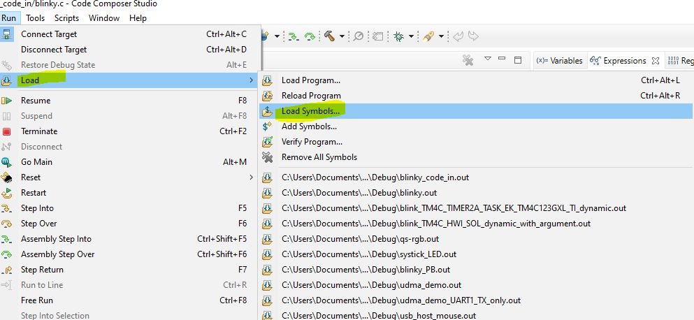

Unable to debug properly in CCS with different FLASH origin address in .cmd file.
When the APP_BASE address is 0x00000000 it works fine, but when it is a different value (eg: 0x00001000) for bootloader support, unable to step over as debug points jumps to random lines/files
#define APP_BASE 0x00001000
#define RAM_BASE 0x20000000
MEMORY
FLASH (RX) : origin = APP_BASE, length = 0x0003F000
SRAM (RWX) : origin = RAM_BASE, length = 0x00008000
      Do you have the bootloader starting at 0x0? If you have bootloader in the flash starting at 0x0 and the app in the flash starting at 0x1000, make sure you load the symbols for both images before you debug. I will also suggest you try out the bootloader examples in the TivaWare. You might start with the C:\ti\TivaWare_C_Series-2.2.0.295\examples\boards\ek-tm4c123gxl\boot_serial (this is a bootloader starting at 0x0) and C:\ti\TivaWare_C_Series-2.2.0.295\examples\boards\ek-tm4c123gxl\boot_demo1 (this is an application starting at 0x2800). Also make sure when you start your application (e.g. 0x1000) it does not overwrite the areas that is occupied by the bootloader. In another word, if the bootloader occupies memory beyond 0x1000 then your application will overwrite it.
