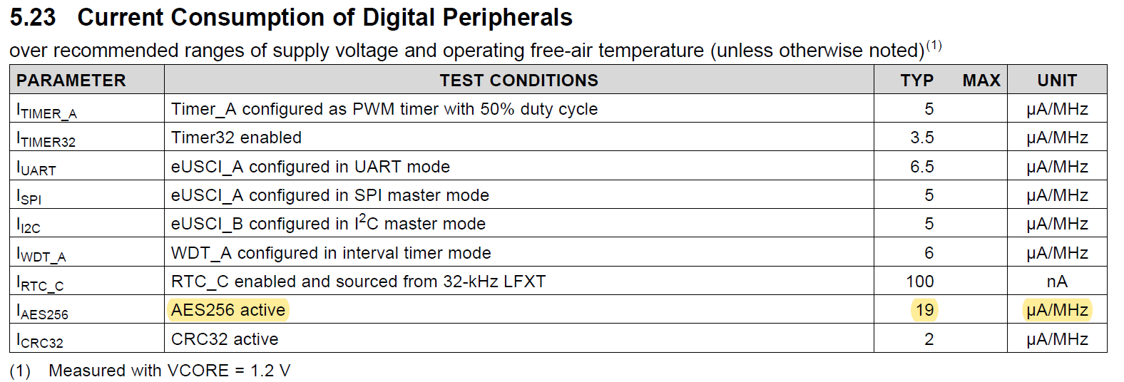

With reference to the MSP432 datasheet above. We did a scan on the current consumption specification and characteristic. It seems like the max limit shown is about 8mA.
The question we have is, when we are running the AES256 accelerator, what would be a typical current consumption?
