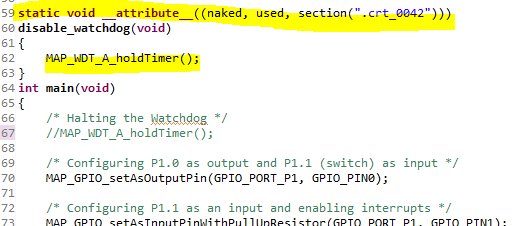

I am not able to debug my microcontroller as at launch a reset occurs on the target.
It looks like WDT kicks in, as there is a fair amount of data that is probably allocated at init.
I found a possible solution here: https://e2e.ti.com/support/microcontrollers/msp430/f/166/t/470334?MSP432-In-Reset-A-Reset-Occurred-On-The-Target , but in my case it does not solve the issue. Where is system_pre_init called? How can I make sure it is executed prior to memory allocation?

    Checkout section 5.3 in the MSP430 GCC User's guide
    It looks like you can assign a function (disable_watchdog) to be run early as part of the system initializations
    I think it works something like this:
  • Hello Dennis,
    thank you very much! That looked promising, but unfortunately did not solve the issue.(a syntax difference in attributes specification between gcc and g++ maybe?)
    I am developing C++17 code, using the new feature of inline static definition inside class declaration. I guess that data goes into BSS.
    I will try to get back to C++11 standard, do you think that might help, or the problem are essentially statics?

  • Using ".crt*" sections to control pre-main initialization is a feature unique to MSP430-GCC. MSP432 uses the ARM Embedded GCC toolchain, which doesn't have this feature.
    You might be able to put an entry for disable_watchdog in ".init_array" instead, to get it to run before main.
  • CRT operations were taking too long for constructing objects.
    The issue can be easily solved by creating a watchdog object (WDT) halting itself in the constructor, and instantiating it as the very first data structure to be built by the CRT.
    To make sure of objects initialization order I rolled back to the C++11 approach, defining all global data members in a separate source file, preceded by the WDT, to take full control of the constructors sequence and avoid the static init order fiasco.
