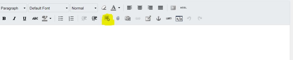

      Your images were not uploaded successfully. Please use the icon below to upload your images.
  •  Sorry here with Images:

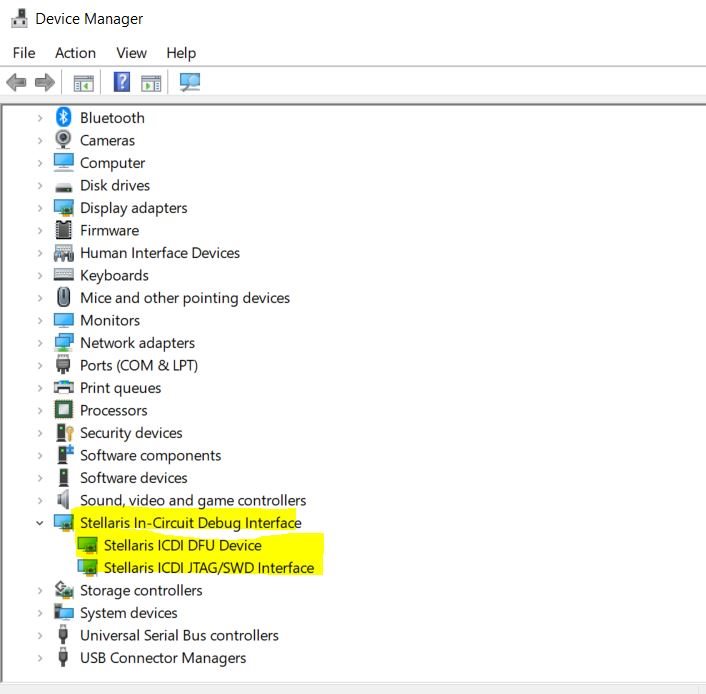

      - Can you show the Windows Device manager. Do you see the ICDI enumeration.
